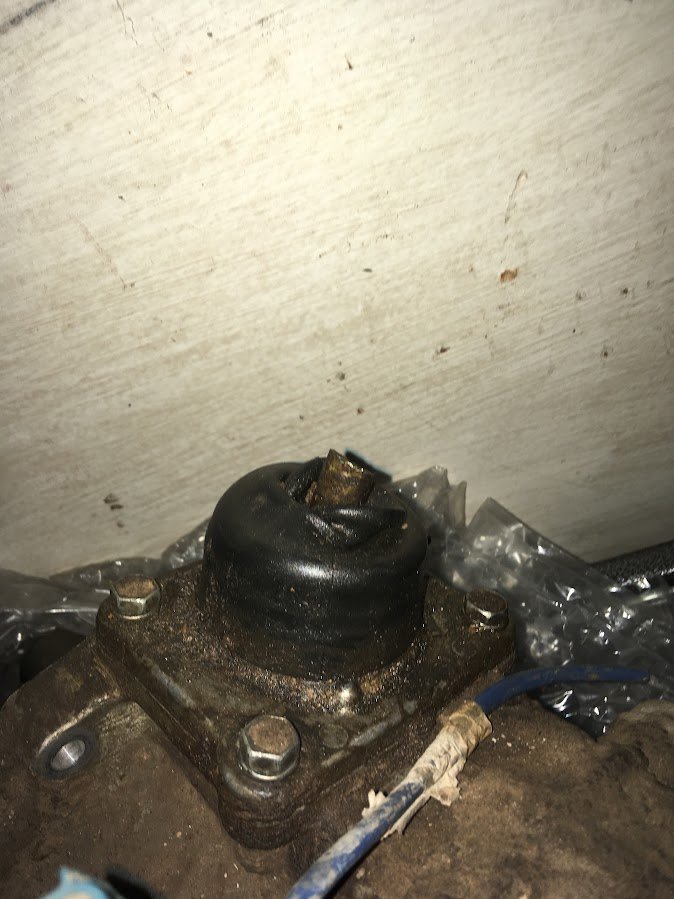

    Bought an R150F/tcase combo out here for shits and giggles and the dumb kid pulling it out of the truck just cut both shifters. Probably not worth the trouble but if @Madjik_Man wants it to weld a lever to it's his.
    Probably easier to sacrifice the automatic lever since he would have a threaded end still for a knob.
