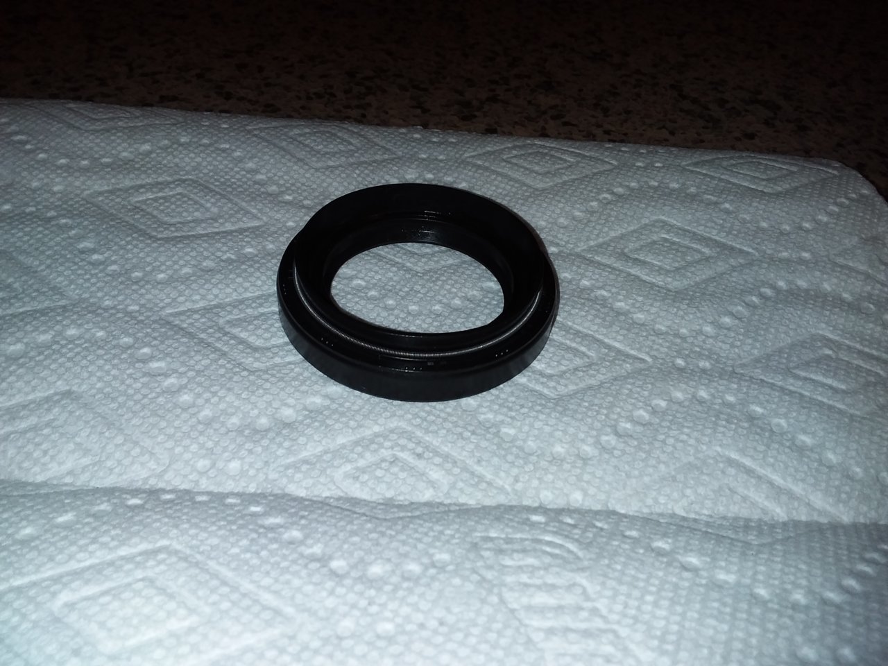

    Thanks for your help...there are two lips to the side that faces the clamshell...in the smallest diameter lip or the outer most lip?

    like this?

    Not exactly sure what you are trying to say but the spring on the new seal should face inward. The smaller diameter lip should be the side that faces inward. Make sure when you put the new seal in you don't push it in too deep.

    No that doesn’t look right. It goes on the inside
    Please just get a new seal since you’re already in there

    ^^^What he said^^^ Definitely buy a new seal while it is apart.

    Oh, ok. I do see that the new seal already has the garter spring. I wonder if that is the reason my old seal leaked (the garter spring had come off and was floating around). So the side with the spring on the new seal should face inward. Thanks.

    Correct.

    You need a new seal. The spring is a part of the seal. Your seal is driven in too far. Outer part of the seal needs to sit flush with the housing. Another thing you can do to prevent future leaks is take some 1500 grit sand paper and polish the surface of the CV that the seal rides on.

    You can get a 2" slip sch 40 or 80 pvc coupling to help drive the seal in.
