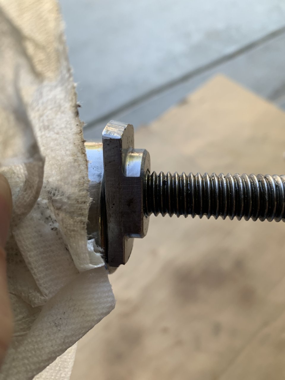

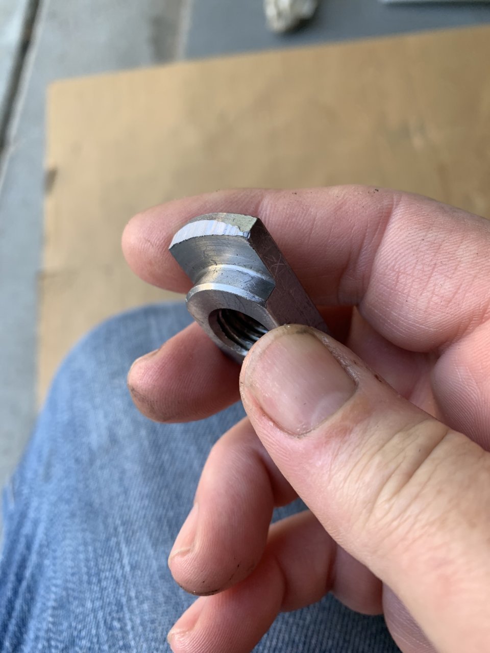

    Help! I’ve spent 2 hours trying to get the removal tool behind the needle bearing. There is just no way it’s going to stand up in there. It hits the far side of the bearing no matter how carefully I position the other end into the gap.
    Did you guys just hammer it past the bearing, probably breaking the needle cage?? Or is my tool not made to spec (too big)?

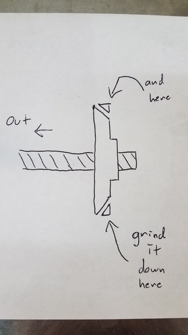

    I had the same issue. I had to carefully grind the ends down at an angle to squeeze it in. It seemed sketchy too. I was thinking shit, if I pound this thing in and can't get it out I'm screwed.
    Maybe this helps?

    Haha, I just did that! Grinding the edge got the tolerance close enough to tap it the last bit of the way with a screwdriver and hammer.
    The bearing cage still broke slightly, like many other pictures in other threads.

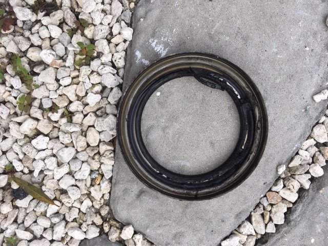

    I didn't get the memo about the ECGS bushing install tool so had ordered that also. I had to file the taper of the smallest adapter to get it to fit into the bushing. It is a similar to a kit that you can buy on Amazon for $20-30. The bushing tapped in nicely but slowly to just flush to the inner race. The old seal still looked new but was replaced anyway and installed with a 2" PVC coupler to flush with the housing.
