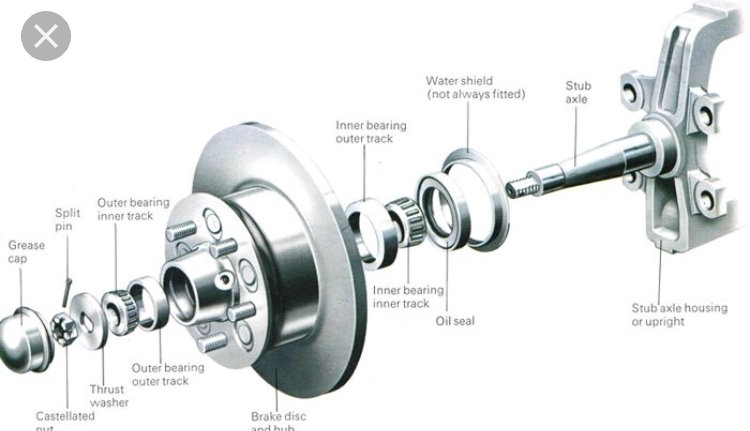

    yes the fat constant rate coil springs are for 5lugs, 6lug springs are noticably diffrent. Ik moog makes many coils, i think 81070 in the part number. Im not 100% sure. I will actually be selling my v6 s runner coils in the near future when i swap in my doestch
    @NMTrailRider this is what a 5lug looks like from the spindle forward. When doing a spindle lift you replace the spindle everything after that you can either replace with all new stuff if needed or just reuse all the oem parts. Disclaimer this is not an actual picture of a tacoma but has all the same parts
