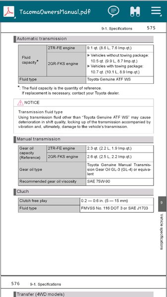

    It's not an exact science, but I can look at the side of the bottle after I'm finished and see that I have 1/2 quart, 1/3 quart, or none, etc. left over. I don't know how they do it at the service departments, but I know I put in an entire quart plus a little bit of another quart ... thus I added approximately 1.1 quarts. Exact - no, but I figure it's a pretty close number.
    See my attachment for the procedure. Page 5 tells how to do it without a techstream.

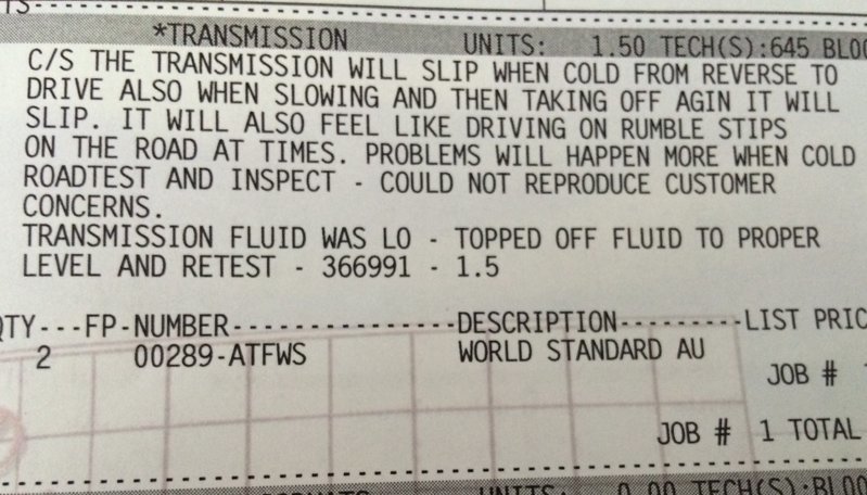

    Same here, mine was 1.5 low too. But, I didn't wait. I took my Truck back after only having it for a couple weeks. Dealer agreed to check level with no issue.

    WOW Thanks for this great information. My apologies when I wrote my post; I was ONLY referring to "many" service departments where I worked. My job was to FILL the transmission to the optimum level, the customer had already been charged for the whole quart; so the whole quart was what was listed on the work order.
    Thanks for this attachment. WOW things are WAY more complicated then when I was a FULL TIME Floor tech. Disconnect pins TC and TG which activate the engine idle, then the D shift indicator comes on for 2 seconds when the temp is 95 - 113F ... etc etc .... WOW all this and more to CHECK the transmission fluid level. NO WONDER Toyota doesn't do this all the time; that is a lot of tech wages/money to JUST check the fluid level.
    What a big procedure; in the OLD DAYS we just had the engine idling, and we pulled out a dipstick to check the level.

    Yeah, the procedure is much more involved than the "old days" and overly time consuming, which is why dealerships don't want to do it unless they absolutely have to. I timed the procedure on a cold truck, mid 70's ambient temp, and it took about 8 minutes to get to temperature, and another 5 or so minutes to get above the max checking temp, so the process itself takes less than 15 minutes, but they may have to wait hours for the temp to come down enough to check it after someone drives it in.
    I sure do miss the dipstick.

    I have the same issue. Truck has been in 3 times. twice they filled the trans after a check. First tech scan said it was Ok. Not sure why this is so hard to fix but I still have the R to D delay, "slipping" feeling when trans is in higher gears, and when making turns it feels like the whole truck just dies and starts back up or falls out of gear. Hard to explain.
    I am almost hoping my trans just quits like @helimech09 's just did so they have to fix a problem.

    I beg your pardon for this foolish question, but my dealership assured me that this is an issue with the auto transmission only. Should I be concerned with this with my 5 speed MT?

    It would be VERY unlikely. Manual transmissions have grease or lube in them, not regular transmission fluid. They would get filled when they are built, like an automatic would, BUT there's no transmission cooler on a manual so no chance for loss of fluid when the cooler is installed at the port.
    Yours can also be checked much easier. It should have a plug on the side you take out and stick your finger in and down. If you touch the grease you're good. Do this when the transmission is COLD though. If you've driven it for a couple hours I imagine that lube could get pretty hot. No need to burn a finger.
