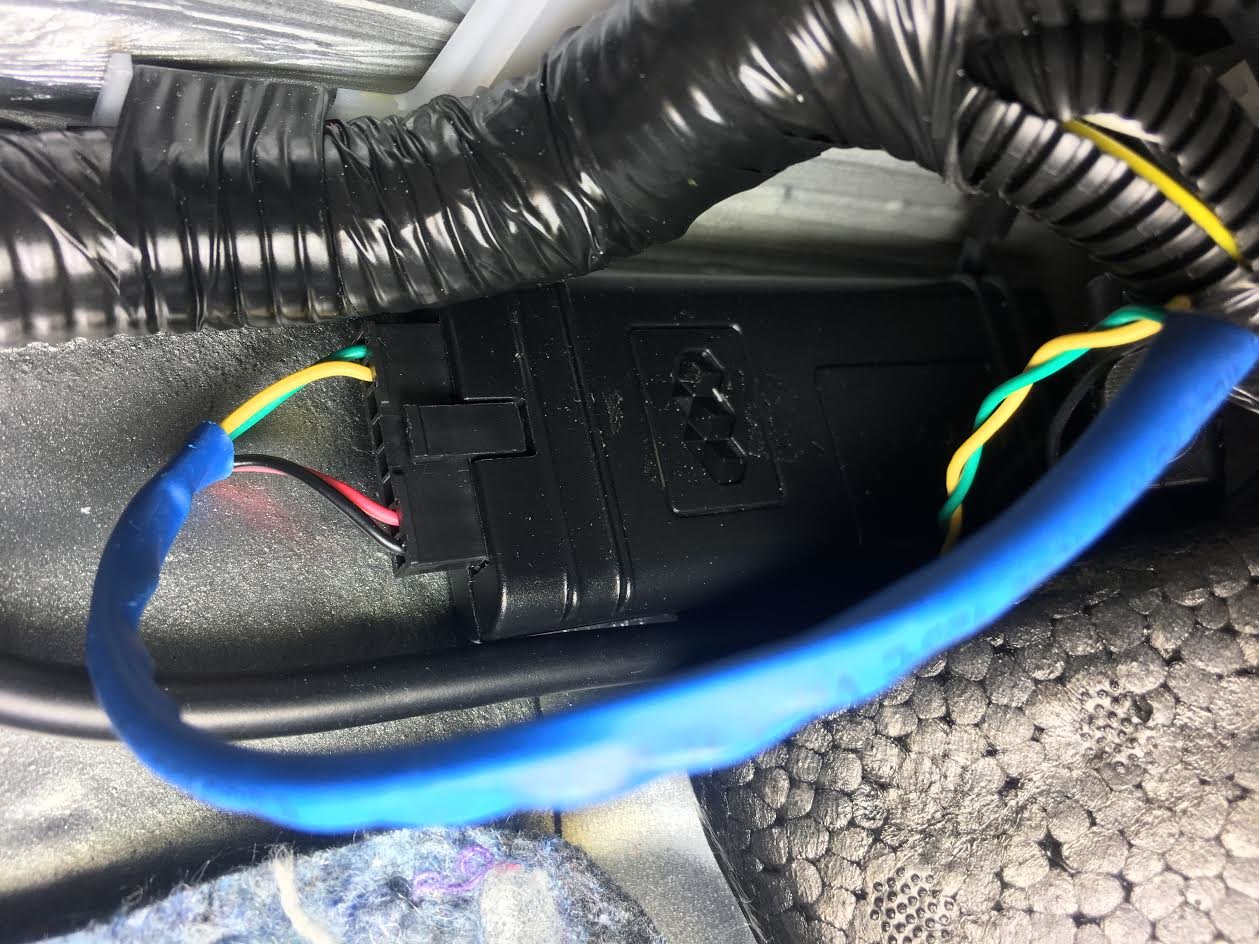

    what might i ask is this little gem. ??
    maybe its the key fob reciever .

    Some dealerships/finance companies install trackers on vehicles.

    Unplug it and see what happens

    Looks like the Smart Phone Control module for a Remote Start system. It uses an app to control the vehicle. It is sold by some of the vendors here including @N2DesignsInc
    You should also have a remote start module somewhere installed if you have that device installed.

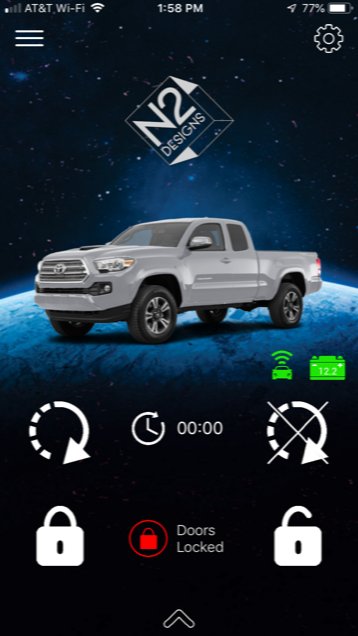

    That's a smart phone control module.
    AR-3HU = 3G model
    VS-4LU = 4G/LTE model (latest and greatest)
    Press your OEM fob's lock 3 times and wait, see if your vehicle start. If it does you have a remote start. Press the lock button 3 times again to stop the engine. They even went as far as putting the phone control. Go download "LinkR LT", "MyCar" or "CL6" from the app store (they all have identical interfaces), create a login, then add your vehicle in the app using the 16 digit code on sticker of this device. They may have placed the duplicate sticker on the door jamb too. If when you enter the 16 digit code it says "Already registered" then someone (stupid dealer didn't release the vehicle). Which means they have access to starting/stopping, locking and unlocking YOUR vehicle as well as GPS locate. If that's the case, give me the last 6 digits of the 16 digit code on the label and I'll have it released so that YOU CAN add it as YOURS and YOURS ONLY. Can you hunt down the remote starter it's connected to, as in brand? Follow it's cable, it'll be plugged right into it. HOPEFULLY they programmed it to the remote starter or else you'll (or they'll) have to do that too...

    Hunt down what it's connected to. They aren't stand alone units, unless they're only used for GPS tracking (which is free, no subscription)...kind of like a low-jack, in which case you should still be able to use the GPS portion of the app to GPS locate it anytime you feel like keeping tabs on your vehicle when a spouse, teenage kid, or dealer keeps it over the weekend to do work (and ends up driving it for the weekend home) in which case you would screenshot it then show up on Monday demanding free lifetime oil changes! :rofl:

    AR-4MA, not your standardconnected car device.AR-4MA was designed to protect a dealer’sinventory from theft and misuse, as well as improvethe efficiency of floor plan audits, increase fixedoperations profitability, and enhance the salesprocess.Utilizing GPS technology in a new carfranchise dealership requires unique, customization.The connected car system was designed from thebottom up to help franchise dealerships achievetheir goals.AR-4MA is an evolutionary second-generationconnected car hardware that enables dealersto locate inventory, manage loaner and demoinventory, prevent loss due to theft, reduce costs,increase staff efficiency and increase CSI.AR-4MA
    disconnected just now.

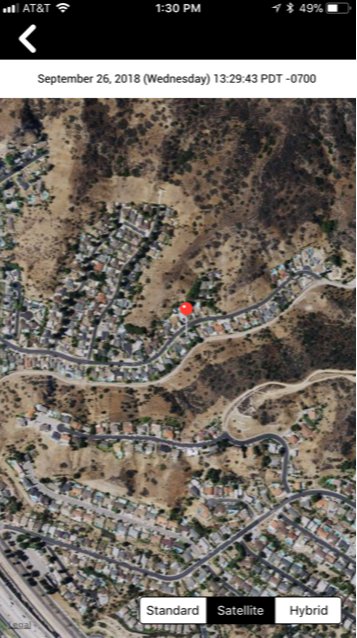

    Dealer stops paying for tracking service once it's sold to you, they don't care. It's an in active piece of hardware. Why don't you put something on that lets YOU track it the same way in real time. The consumer version we sell looks identical...and gives you remote start/stop, lock/unlock, battery voltage in addition the GPS locate...just saying. Don't rely on the dealer to track it in that situation because that's considered invasion of privacy if they admit they can find IF they continue to pay for a service that does them no benefit based on what you just said above.
    This part is the same view the dealer had (also a part of the smart phone app)
    You do need the fob remote start module before you could add this on (if you want to utilize the engine start/stop, lock/unlock portions).
