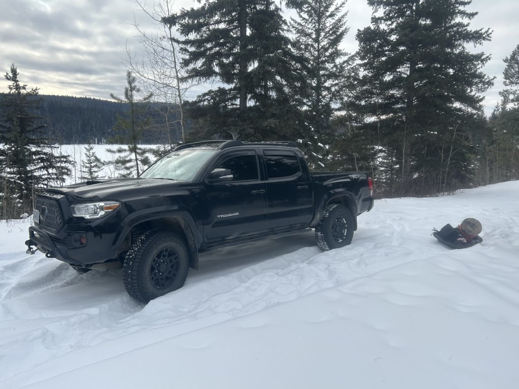

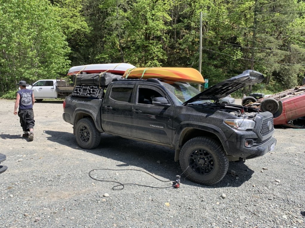

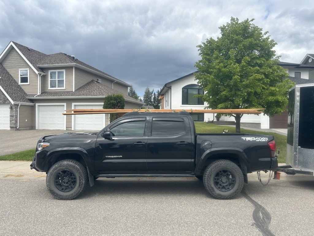

    Im running medium OME 2" lift kit (2887 front springs) and instead of dakar OME leafs (they tend to squeak), I am running medium dobinsons leafs.
    In your link, you selected "heavy load". I would not recommend heavy load unless you are running steel, bumpers, skids, sliders, winch etc. Heavy load lift kit will make the truck ride like garbage if its stock weight.
    These nitrocharger shocks are bomb proof, like 3 times thicker than what comes stock on these trucks. My front end has been airborn a couple times while offroad afer the lift and I was impressed how well they handled. Keep in mind these are NOT extended travel front shocks. So if you are going for 2" lift, you will only end up with pathetic ~1.75" of downtravel, and like 5.5" of uptravel, stock is about 3.75" up and 3.75" down ( downtravel is more valuable offroad and in general driving conditions). My front end settled at 1.75" lift (front bumper, winch and sliders) and I have 2.25" of downtravel. I do feel my suspesnion top out at times when going over speed bumps too fast and such. I am not a hardcore offroader, even though I spent a lot of time in the bush fishing, camping etc., the lack of downtravel doesnt bug me that much. Not enough to do anything about it anyway, been driving like this for about 3 years.
    I kept my stock needle bearing and it has been absolutely fine despite on what a lot of other TW members say on here. You will probably need a 3 degree shim for rear axle to get rid of vibration, although its hit or miss on theses trucks. I had a vibration on deceleration between 30-10 or so and the shim completely got rid of it.
    You dont need any extedned brake lines etc. If you stay no higher then 2", thats a safe bet. The angle of your CV axles will be just fine. Toyota IFS doesnt like to be lifted more than that, unlike a solid front axle.
    If i was to do it all over again, I would only go with EXTENDED travel front shocks, they would give you about an extra 3/4" downtravel making it right around 3" (5100 bilsteins) Overall, i really like this lift. It makes the truck more capable off road, improves approach, breakeover, departure angle and looks absolutely fantastic with 33x10" tires.
    The lift will decrease your fuel mileage a bit if driving fast on highways. In city i noticed no difference in fuel mileage.
    Let me know if you got any other questions.
