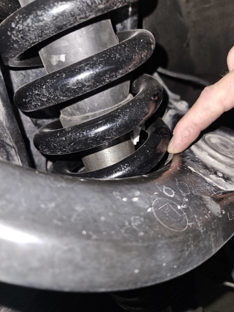

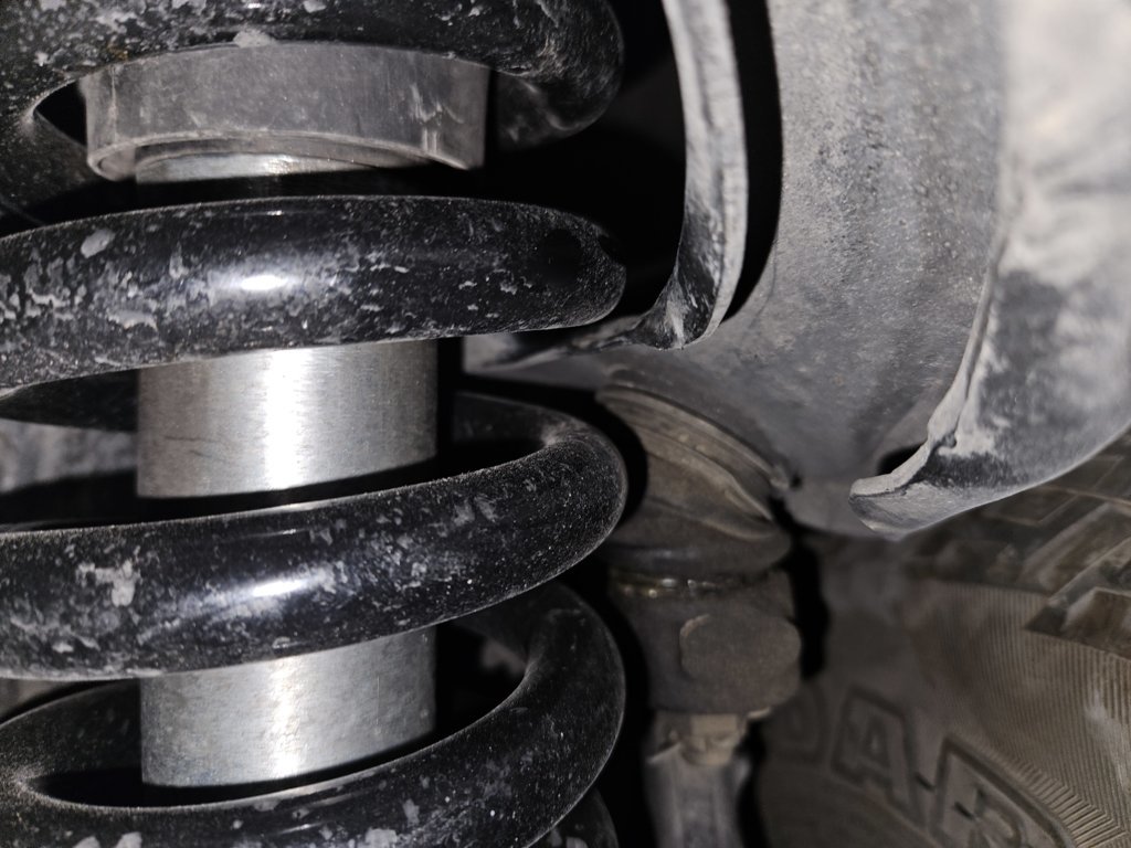

    Good info here. I can add on the "custom/not read about much" front- I put OME 886 coilsprings on my Bilstein 5100s for 3rd Gen, lowest circlip, and added 1/4" spacer up top for drivers lean. 886 is a 402mm, 660 lb coil, quite long. The Bilstein is already 22.22" extended length and I added .25" spacer, which makes it 22.47" effectively.
    At full front droop and while pushing down on drivers tire, the coil still has a 1/4" of stock UCA clearance. Close but it still clears.

    I'll post a pic but yes, less than a finger width between stock UCA and nearest coil at full front droop while pushing down. 22.5" ext length is a good rule of thumb max so there is some torsional bending allowance in real use. Max on a third gen. Different UCAs will have different droop spacing.
