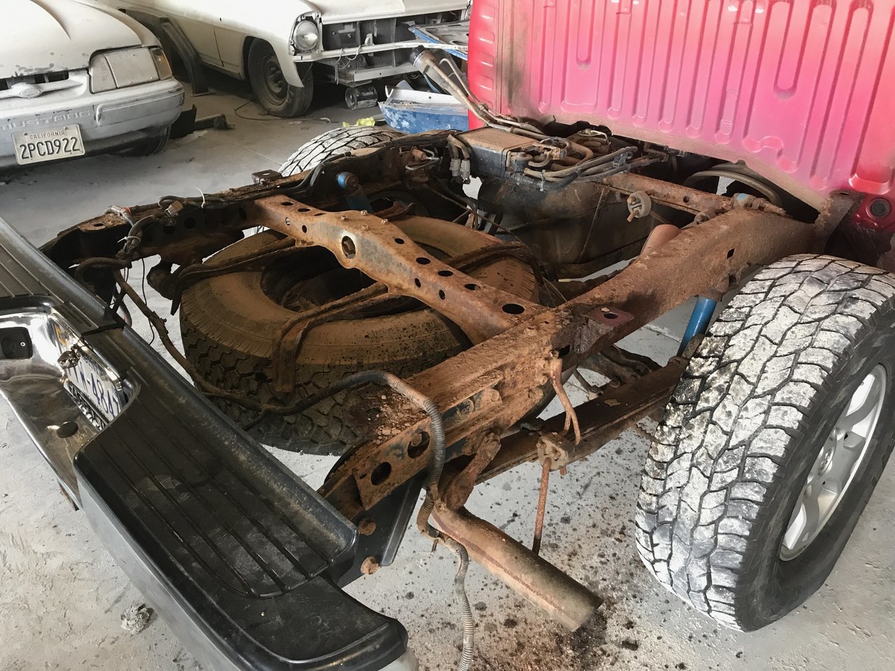

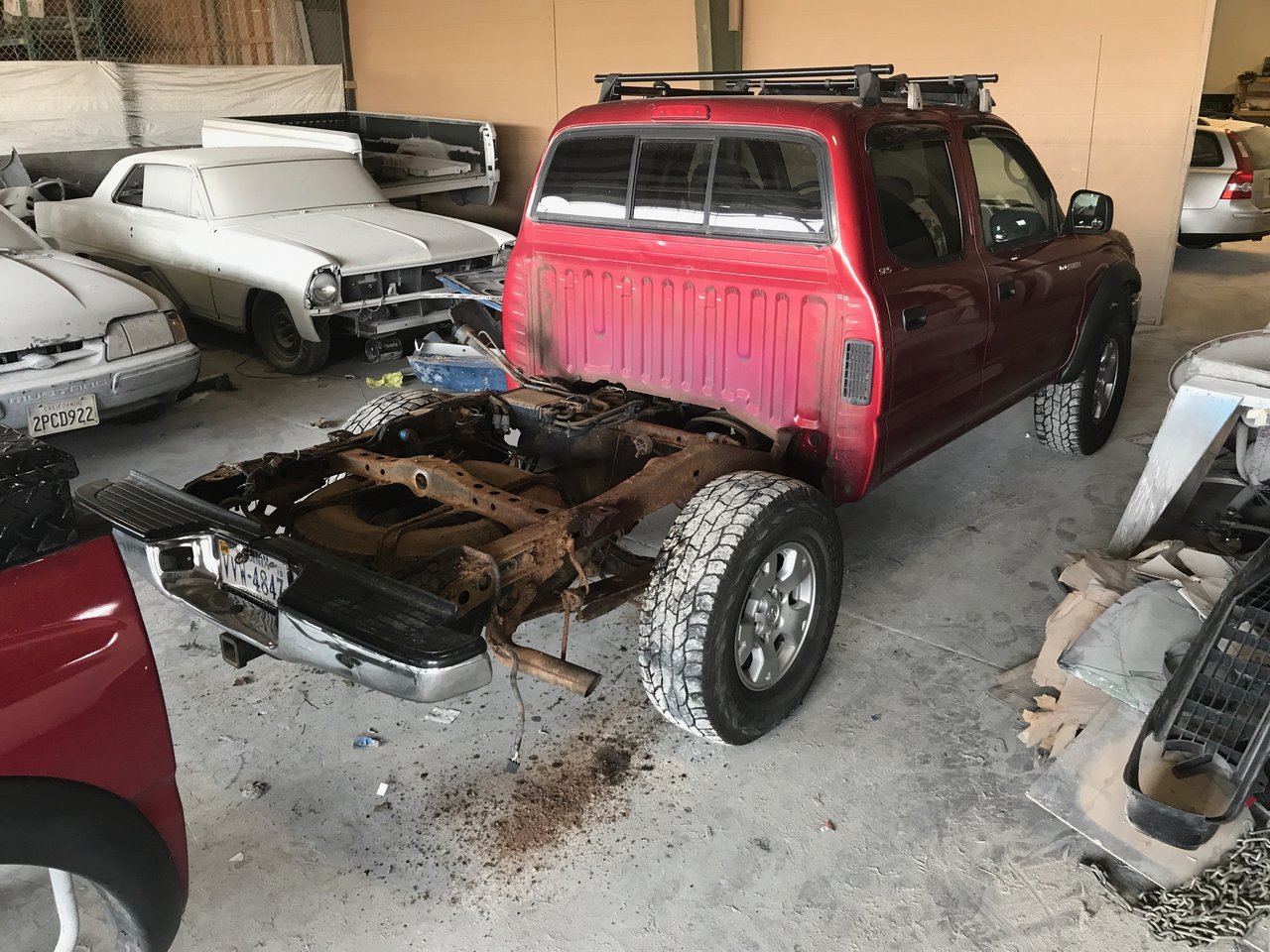

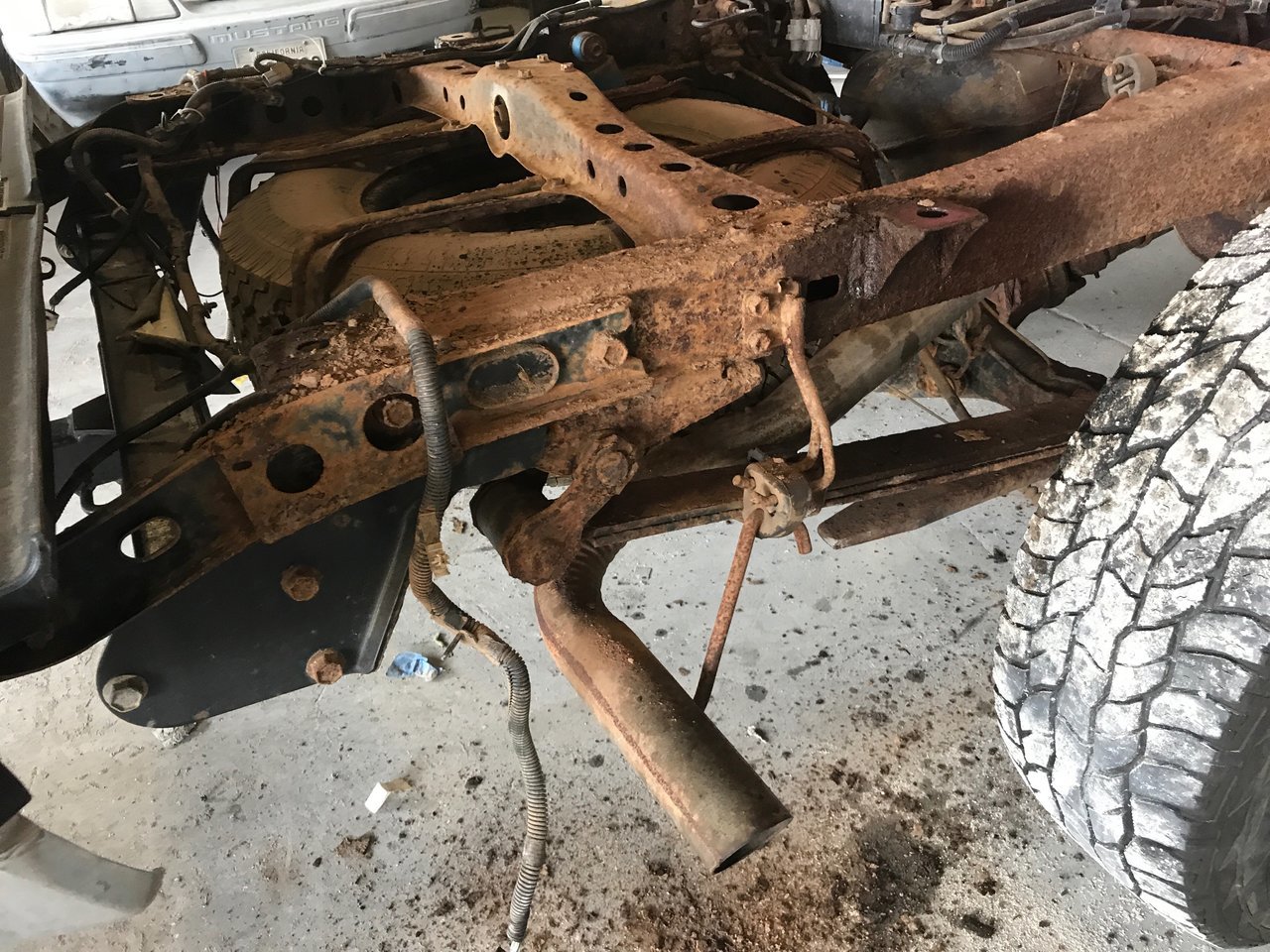

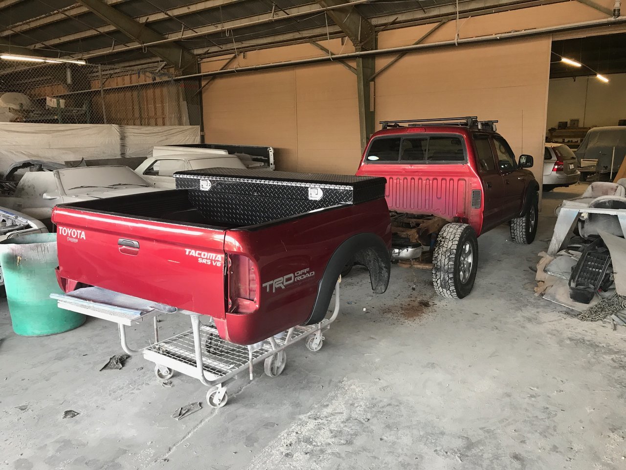

    OK, truck is at my brother's shop and they pulled the bed off. Here are a couple shots of it - looks and feels (to my brother) like surface rust. He banged it with a hammer and was trying to loosen a lot of this with a screwdriver - he sent me a video, going to see if I can just upload that here or if I need to use Youtube for that.
    He's got a guy that has a portable sand blasting unit that can come to his shop; that way they can put it on a lift and the guy can work on it without pulling the cab as well. Still very much in progress here but wanted to keep you folks in the loop as we deal with this.

    Now that we have a better view of it, it does look like well settled surface rust. But still, the hammer will tell you the answer.
    Did any holes appear? And how is the inside of the frame? poked a finger or something in there?
    Also, how is the gas tank filler tube? They sometimes rust through at the base
    GQ7227 likes this.

    The most important thing about POR15 (or any paint, actually) is the surface preparation. If it's not prepared well, the paint won't stick. It will just peel off after a while. In your case, that's why you must remove as much loose rust as you can, or else it won't stick.
    Never used POR15 metal prep nor POR15, but the metal prep formula does look like some sort of primer?? In this case it will help, as the paint will be more durable. Does not look to be rust killer/converter, though...
    The preparation steps would be
    1. remove loose rust (wire brush, sandblast, needle scaler, or any other way)
    2. apply rust killer (very important because painting over rust won't stop it)
    3. apply primer
    4. paint (more than one coat)
    5. grease

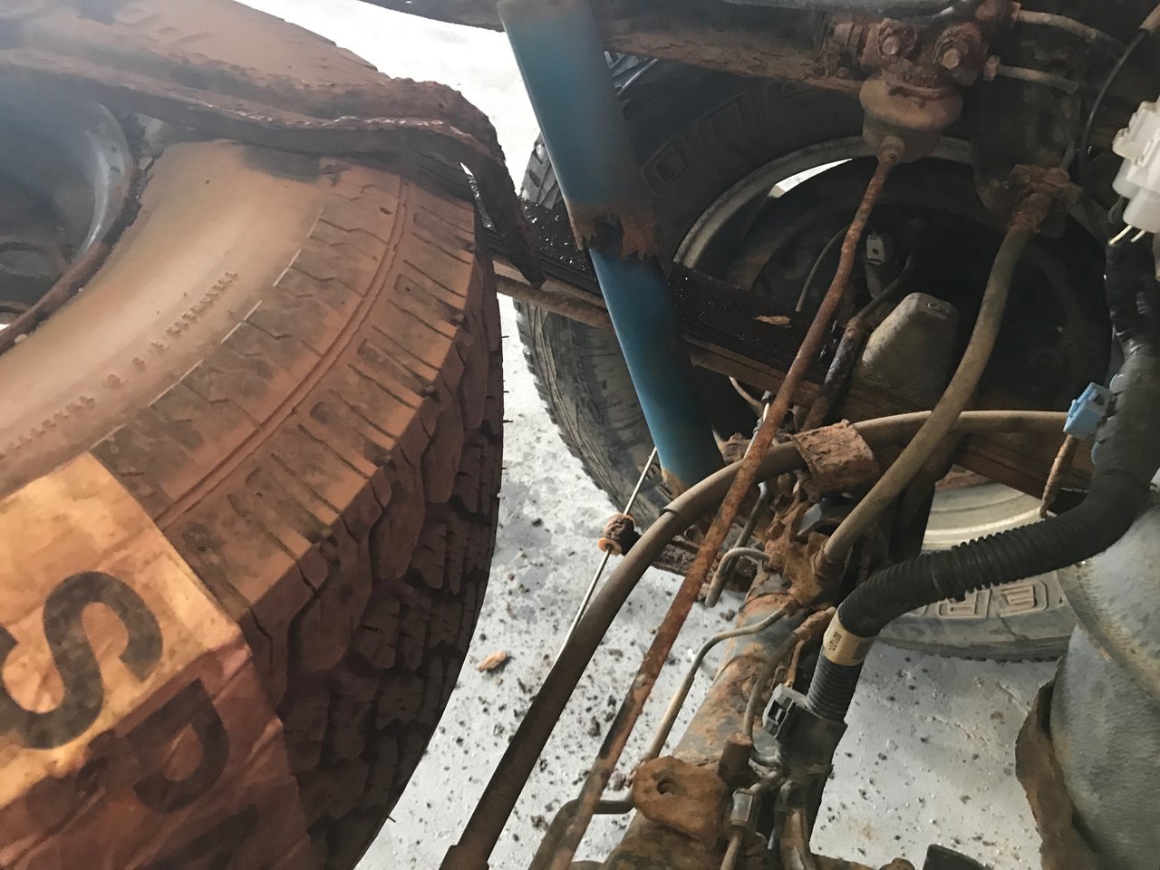

    Now, about the video, that looks encouraging, but he should not be afraid to hit it hard. Especially on the boxed portions of the frame, as it is most of the time rusted though but from the inside
    About the gas tank, again, poke a screwdriver at the base of each of the plates the stuff connected to the tank rest onto. Sometimes the area under or around these plates is rusted through as well. Same for the filler tube. Poke around the base with a screwdriver
    Also, just curious, but with your rear proportioning valve being this rusty, it is still working?? Got any brake problems? If so, it might be your culprit.
    Oh and about these rust flakes all over the frame, maybe power washing it will help removing most of them? making it easier to remove the rest??

    Interesting that you mention that - I had noticed an odd behavior when stopping the truck. It was almost like there was a slight give after I had braked moderately to even a little hard; wondering if that's the culprit. Awesome feedback onakat - thanks so much.
  18. Sep 5, 2017 at 4:58 PM
