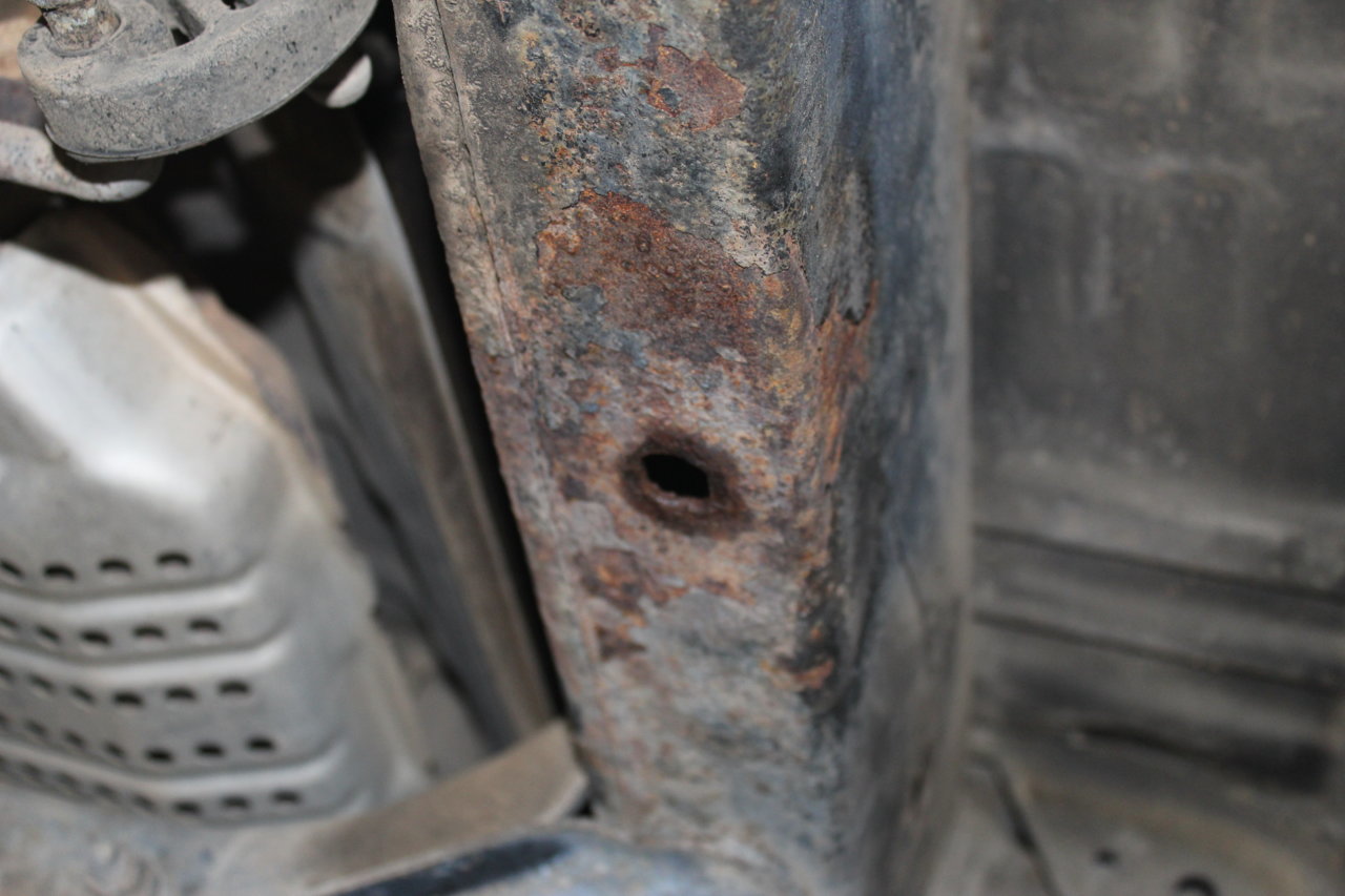

  6. Dec 25, 2019 at 5:40 AM
    #126
    GQ7227
    GQ7227 mw survivor
    Dec 6, 2018
    #275019
    29,298
    J A Y
    i will need to scope this condensate area out on my taco, thanks
    is it by the cat or drains out there? that is the worst spot i have found on mine so far that must've got trapped under the rubber undercoating
  7. Dec 26, 2019 at 2:02 AM
    #127
    Rockdan56
    Rockdan56 New Member
    Dec 22, 2019
    #313970
    3
    Dan
    09 tacoma2.7
    Lifted front and back for plowing
    Comes out the firewall on the passenger side and drips down onto the frame still within the engine compartment. Well forward of the cats, but gets inside the channel and rusts from within.
