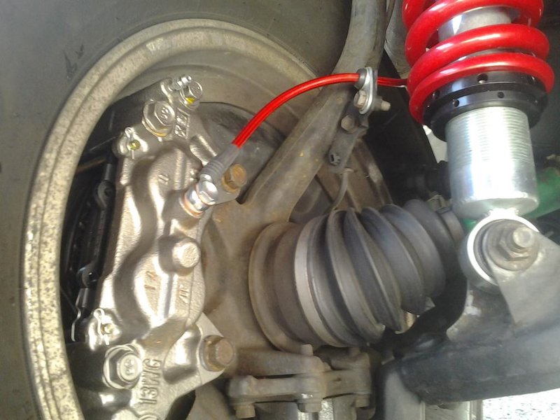

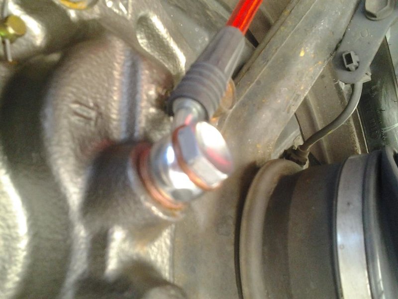

    The brake lines from Wheeler's mentioned above has the banjo bolts like the Tacoma calipers. The Tundra calipers are quite different. If you look at the this picture, you can see there's a hard line from the bracket to the caliper.
    The kit from LCE, while expensive, has all the necessary parts without any need to modify the banjo bolt connection - something I didn't feel was a safe solution, long term. I didn't want a system as critical as the braking system to be jeopardized in any way.

    I have the 231mm tundra calibers on my taco with the Wheelers SS braided brake hoses and the supplied banjo bolts/washers with no issues or modification. Only mod involved for me was trimming the backing plates a tad to clear the 231mm calibers. This is the best upgrade for the buck!

    I use my tacoma for towing a small camper/camping gear or a trailer loaded with 2 large 4x4 atv's, usually headed into the mountains, so this upgrade was a must have for me. The banjo bolts from Wheelers are the correct ones for the tundra calipers. I've read here that some have drilled the tacoma banjo bolts but i didn't like the idea of modifiying banjo bolts.

    This appears to be a different caliper. It is stamped 13WG where the OP is using S13WL. Could this explain why the wheelers lines with their banjo fits yours?
    What is the difference between the "G" model and the "L" model calipers?

    The first link in my previous post covers the differences between the 13WG and 13WL calipers. It also states that the Wheelers lines will work with either or.
    Taken from said thread, "Bottom line is, 13WL is needed for hard line fitting, but if you replace the hard line with flex line, you could use either."
