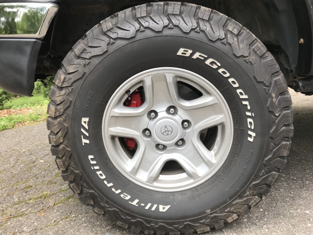

    I had to trim an inch off each side of the brake caliper dust shield to clear. I also had to do some strategic bending and hammering of the shields to prevent any rubbing.
