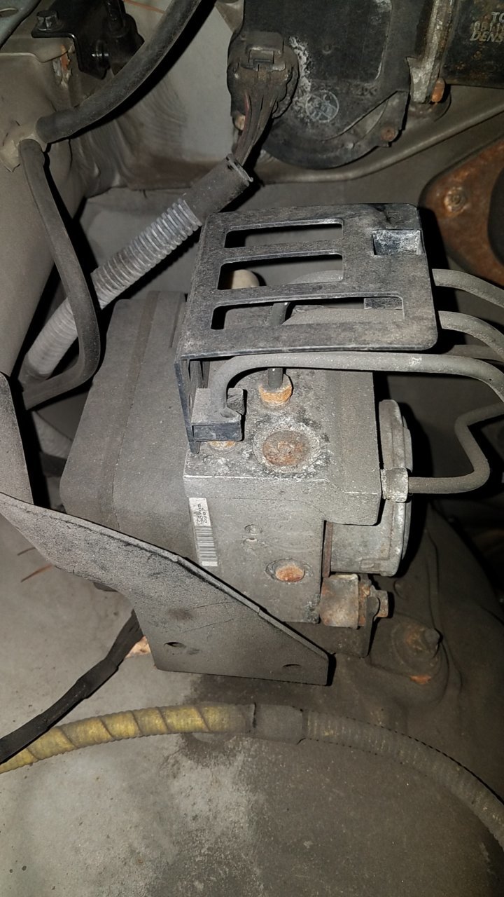

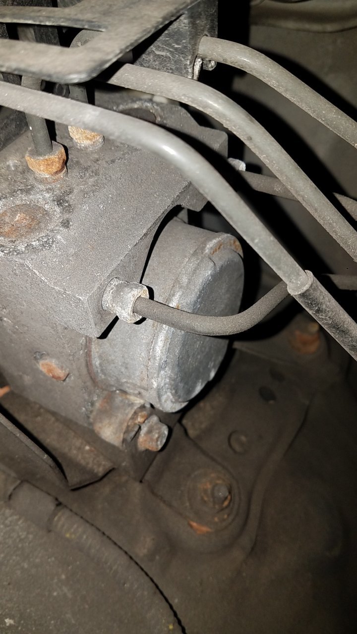

  17. Oct 31, 2019 at 8:05 AM
    #217
    frizzman
    frizzman Well-Known Member
    Sep 25, 2013
    #113212
    5,349
    Pittsburgh, PA
    04 XCab 4x4 TRD/OR
    OME 2.5,Tundra 17s,Falken Wildpeak AT3W hitch w/ 7-pin, ARE cap, JVC HU w/BT, HID/LED lights
    obligatory "I know this post is old" but shouldn't matter, the sensor is on the hub, it detects when it stops moving altogether and will release the fluid pressure to accommodate.
    I looked at mine, yay PA rust, the rubber cover crumbled off and so did most of the 10mm "nut" portion. I have to research replacement size bleeder valve.
    I get the same still, I know there is air but I get no bubbles and all clean fluid. went through a 32oz bottle at least. tried normal, vacuum, 2-person; but meh, I give one pump and it's solid pedal after that.
    I only had the lines off for about 2 minutes each. I connected the braided lines to the calipers first, then switched them out at the hard lines by the UCA. there must have been some air that made its way up.
    also as part of research I've read with ABS it needs to cycle to help release any trapped air so that's my next step. i'll have to find some gravel or slick surface to force the ABS to engage.
    for ABS the passenger front is actually the closest if you look at the hard lines. so RR/LR then LF > RF. there are only two hard lines "into" the ABS module from the MC, then 3 out (1 to the rear and 1 to each front)?
    snowboard704 likes this.
