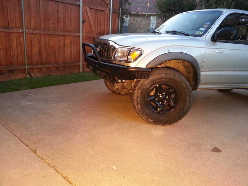

    On the topic of wheel backspacing, do y'all happen to know what my wheels measure? I know they will clear the calipers no problem. I'm just curious. They are the stock 2001 TRD wheels. The ones on my truck in all the pictures
  18. Jun 22, 2015 at 10:12 PM
    #38
    Digiratus
    Digiratus Adventurer
    Mar 26, 2010
    #34006
    23,758
    Roaming the PNW
