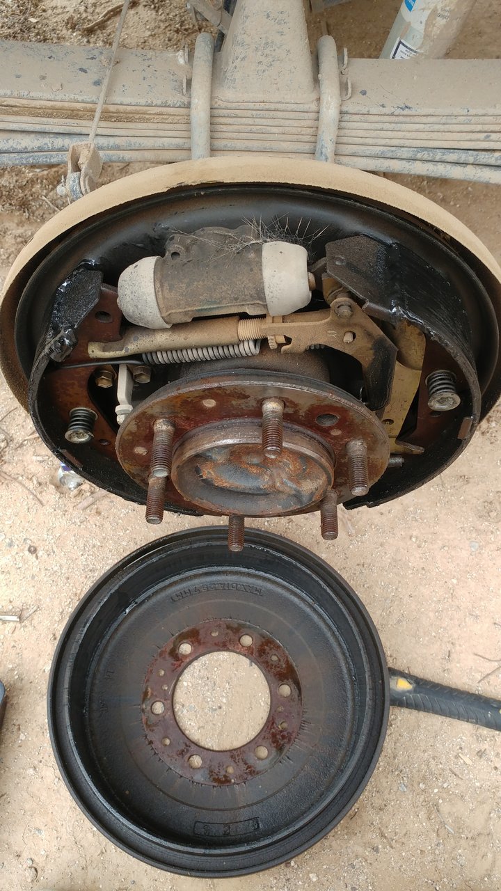

    Because your brake cylinder appears to be dry, you may have a leaking rear axle seal.

    Exactly. Sigh. Gonna see if my brother can do it for a price. But he has limited time just like me to do big jobs like that. Because bearings will be needing done now too. Had planned on getting it done eventually as ive gotten the fronts done recently. But now it has to be done. And I dont have the tools to do it. Brother has a press and lots of bearing tools. But still need the bearing shaft tool. No idea what shop has the capability or what they'd charge for it. But I looked into the process and it ain't fun, more so than the fronts.

    You are right it's not a easy job. Are both sides bad? If you have a shop do the work make sure you check inside your drums throughout the warranty period to make sure they are not leaking. It is common for a mechanic to not replace the seal properly. Another reason it's not an easy job.

    Have you tried taking a vise grips to the brake lines? If you squeeze the line and all of a sudden your pedal is not sinking anymore, then that location is where your issue is. I found out that my rear drivers side drum brake cylinder was bad by using this method. But the post that I wrote that you are quoting, was written after this issue was resolved, so I was still getting a lot of brake travel. So after about a week, I noticed that the majority of the travel worked its way out. Before I installed the steel braided lines, I could already tell there was much improvement in the brake travel. After installing the steel lines, it improved even more. I haven't put the rear steel line on yet but my brakes are awesome and responsive. But definitely getting all the air out was a struggle.

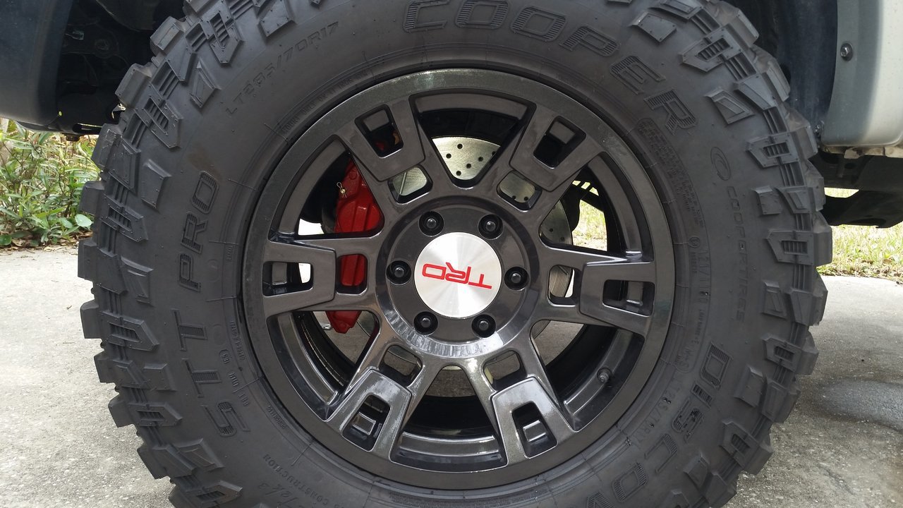

    Did mine yesterday. Pretty simple process, basically take apart and put back together. Braking feels a lot more smooth.20180203_142604.jpg
