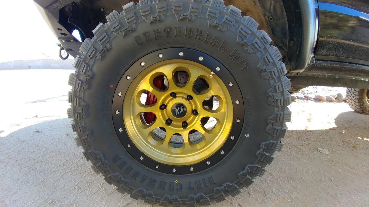

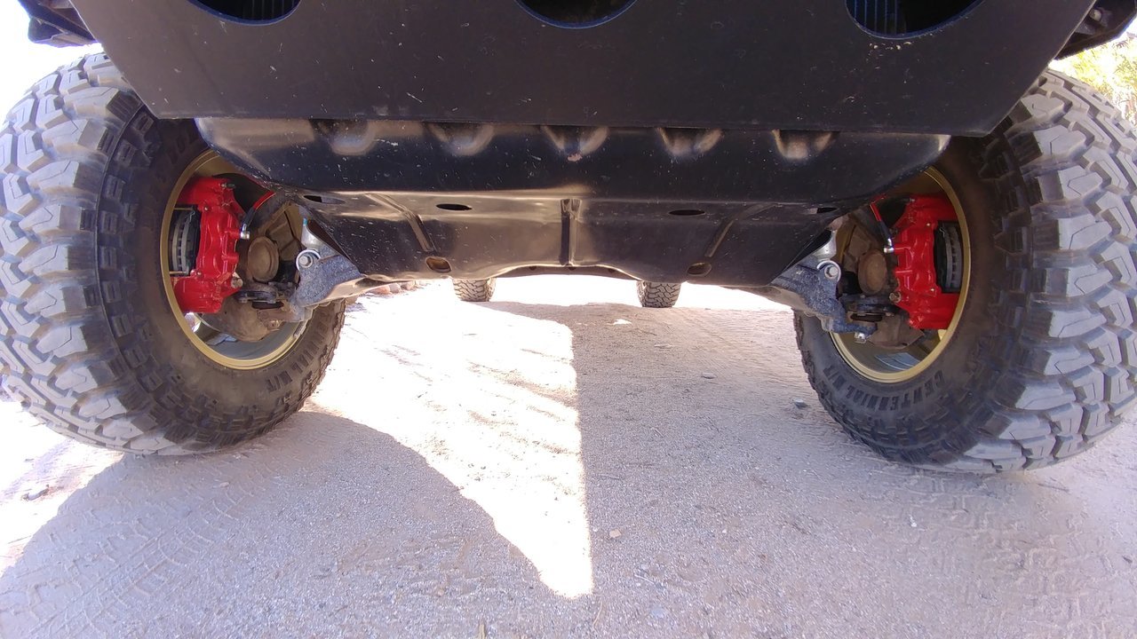

    Well I haven't had the greatest experience.. Possibly the worst I'd imagine with how many problems ive ran into.. But alot of what was discovered and fixed during install, were things that had been neglected and ultimately needed done, so I'm happy those things were discovered in the process as they would've only gotten worse.
    But as far as my brake issue goes, ive been doing some research and tests, and pretty sure I need a new booster too! Ugh. After allllllll that's happened, time and money and ALL new brakes and hardware, axle bearings and seals, one axle being done a second time, fighting with those banjo bolts(think I finally got it to stop leaking today), new master cylinder, another new battery(free replacement tho), multiple bleeds, bedding in the brakes, all this after new scs wheels and new tires, and she STILL isn't working right. Sigh.. Booster is the last thing that hasn't been replaced, so after that it better work like a brand new truck, or ima lose my fn mind! Lol. At least she's back on the road tho.
    Can't really comment on the performance just yet seeing as my booster is failing and pedal responsiveness is kinda intermittent atm. But here's a couple pics. I just wish the rest of my truck was just as clean now. Ha.

    Looks like you got the Callahan kit too. Which route did you go with for the brake lines? Wheelers?

    I'd still recommend the Callahan kit. Even though I had a few hiccups. Others have not. The only mods are gonna be very slight trimming of the dust shield. And maybe drilling the banjo bolts(Even if the wheelers ss lines and bolts are used with the Callahan calipers). Some do not require drilling(Napa or oem I think have not had issues afaik). Or the lce kit which comes with the hard lines and is a hassle free install, but more expensive. I think those are the only 'kits' you can get, everything else is purchased/ pieced together at your own choosing.

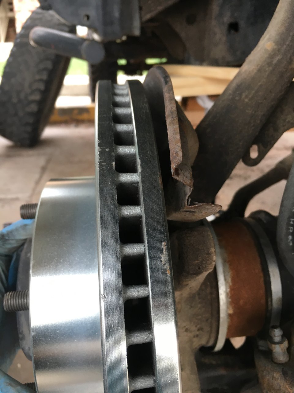

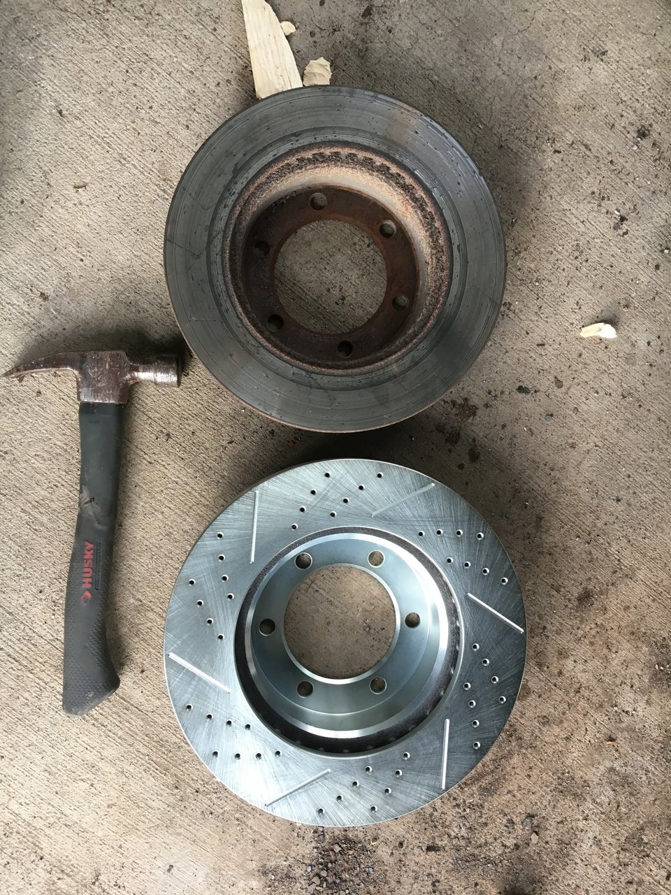

    Well, I received the shipment today of the calipers and rotors. Lo and behold, they sent me only rotors. So pissed. Hopefully they’ll correct their error STAT!
    But man, these rotors are huge! And they fit in no problem on my 1997 Tacoma. Just had to bend the dust cap back a little. Now I just need calipers and to figure out how to change the brake lines...

    You will have to cut the dust shield about two to three inches on each side to fit the Tundra calipers too.

    Yeah, I expect that the calipers wouldn’t fit into that nice little dust cover cutout, thanks for confirming my suspicions!
    The seller replied and said it went in two boxes and the second one is arriving today! Looks like I will get to put them on :)
