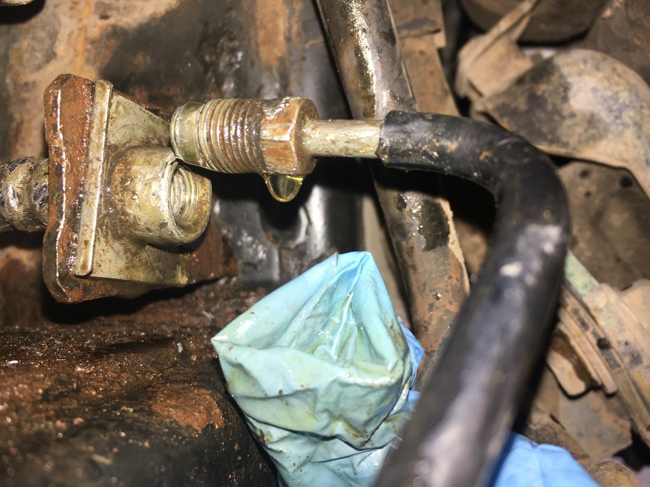

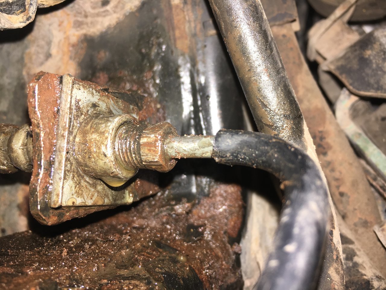

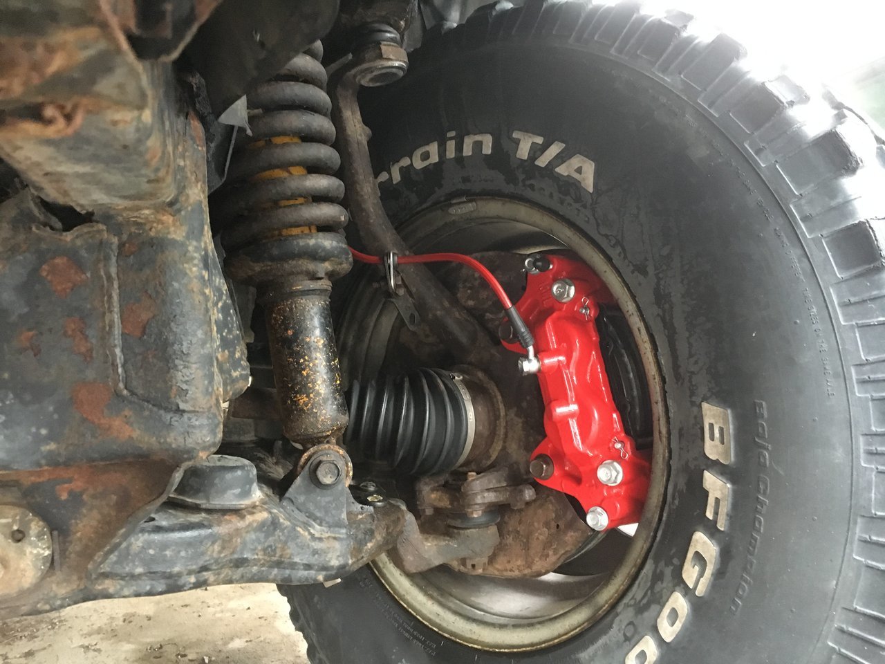

    Haven't had a chance to bed them in completely. Was just in my neighborhood and didn't want to go fast enough to do it last night. Then dropped the truck off for some frame welding this morning. Will definitely make sure to do that completely when I get it back tomorrow! Haven't lost any brake fluid so far!
    The hard to flexible brake line fittings were a total PITA!
    Now I just need some new tires...
