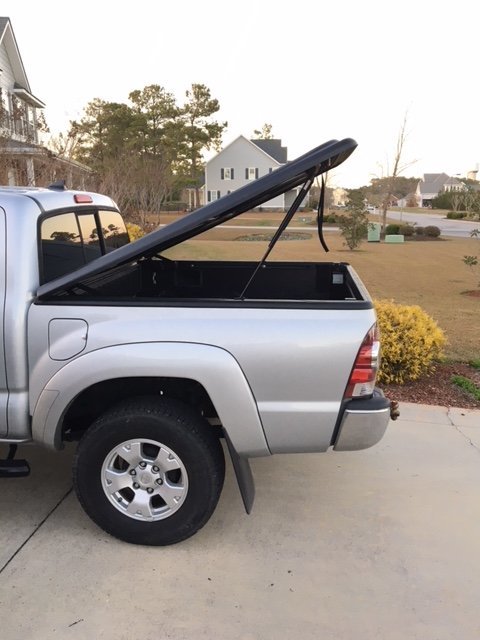

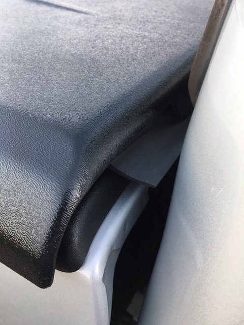

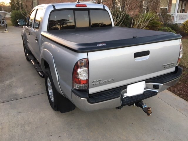

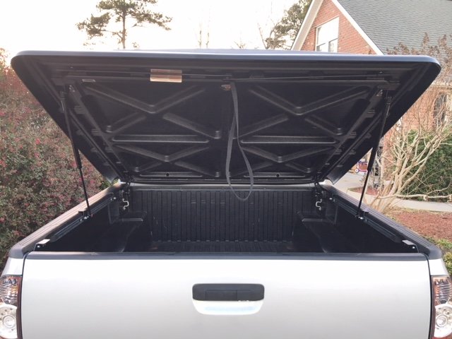

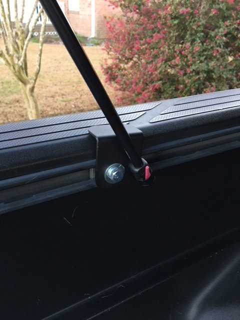

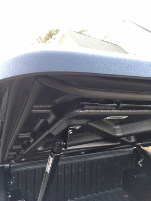

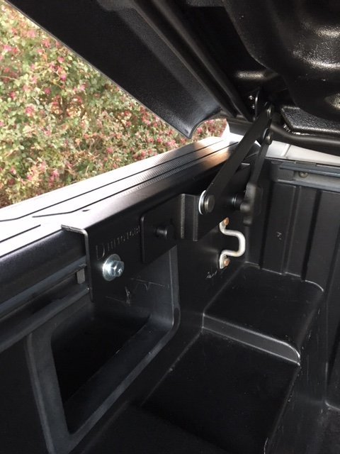

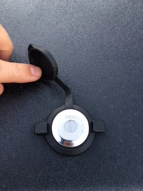

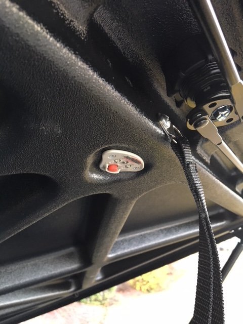

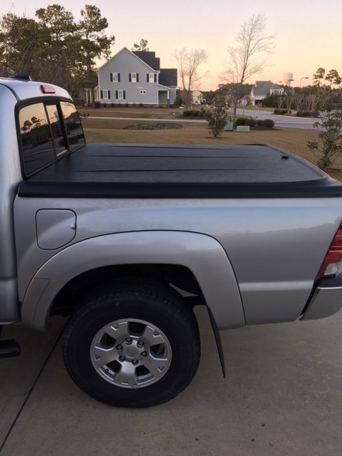

    Pictures at long last:
    IMG_3111.jpg IMG_3113.jpg IMG_3114.jpg IMG_3115.jpg IMG_3116.jpg IMG_3117.jpg IMG_3118.jpg IMG_3119.jpg IMG_3120.jpg IMG_3121.jpg IMG_3122.jpg IMG_3123.jpg

    For anyone who stumbles across this thread down the road: the cover and parts are very nicely customized to the particulars of the 2012 Taco bed. The underside at the bulkhead and tailgate dips down to match where the bulkhead and tailgate are lower than the rails. Nice double bulb gasket all around. There's also a nice weatherproofing flap over the bulkhead area. The only hiccup in installation was that it's difficult to start threading the bolts into the sliders for the hinge hardware and for the strut bracket. I also can't imagine doing the install solo without dinging up the hardware or the cover. Lastly, the directions have an insert specific to the Taco but aren't 100% clear. Common sense prevails!

    Looks awesome on the silver taco,so far after all the rain,snow and high pressure car washes ive had not one single drop of water,love these Undercover Tonneau's.

    I had to go back on my thread and look at mine,virtually the same set up as mine except the strut clamps are different.Hope you have many good years with it,I know I will,lol

    The mechanism that holds the lock twists 90 degrees, which extends two arms underneath the lid so they slide under brackets attached near the tailgate. When you lock the mechanism it prevents it from being turned. So securing the lid and locking the lid are two separate things. I often secure but don't lock the lid when I don't have anything inside, especially if my keys aren't in my hand. Even if you haven't secured the lid it stays pretty tightly closed due to the pneumatic pistons that support it when open. But I'd recommend securing it every time. By the way I thought it would be a pain in the ass to have a separate key but it's on my key chain with my ignition key and it's not really an issue. I just keep the spare with the spare ignition.
