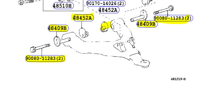

    Where did you find the oem LCA bushings?

    @rocknbil, I did the LCA bushing replacement detailed in Timmy's video last year, and all went well. Mostly. I had to have a shop press the new Whiteline bushings in the last 1\4", as nothing I could do would accomplish that. Everyone I heard from said they had no problem doing that without a press, so YMMV. Looking back, I'd have gone with the Moog LCAs with the oem style bushings - way less work.

    I ordered them from McGeorge Toyota

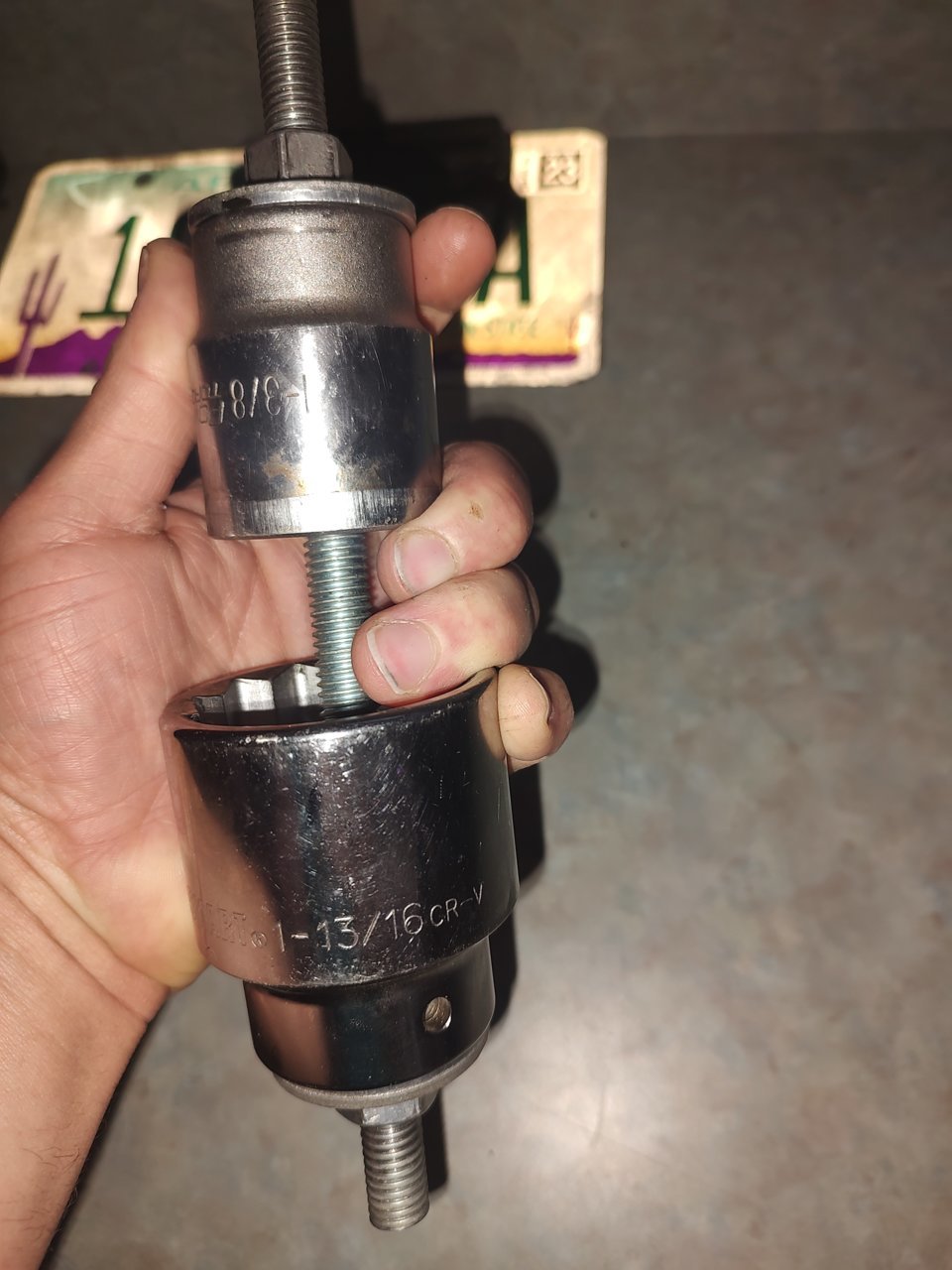

    This little jig can be used in lieu of a press. Crank down the nuts on each side with a box end wrench and it forces the bushing in. Honestly works better than a shop press in my opinion. Still could need the press to remove old bushings though, unless you use the bottle jack method.

    The bottle jack with a propane torch worked like a charm on the removal. Thanks for the tip on the jig for pressing the bushing in (wish I'd thought of that), however, the shop that pressed them in owed me a favor, so it was no cost, with drop them off in the morning, pick them up that afternoon. To this day, I still don't know why they wouldn't go in that last 1/4" like everyone else's...your tip is great for the next guy.
