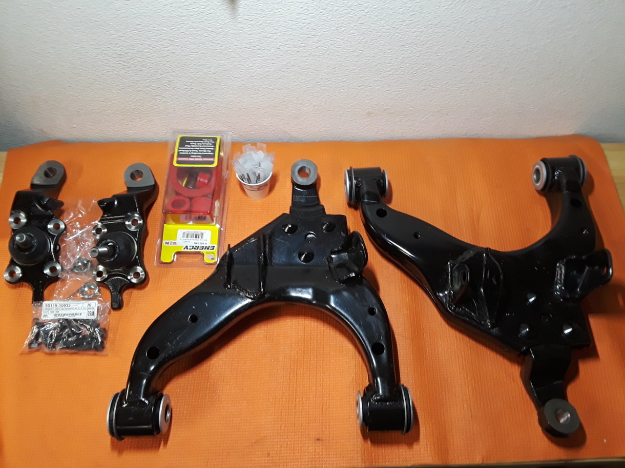

    Got a decent incentive check today from work and lower CA's, ball joints, lower BJ bolts all in the cart and I'm about to pull the trigger. I have a set of Energy Suspension steering rack bushings on the bench, might put those in this weekend when I replace the engine belts (the CA/BJ project is two weeks out as I'll have to get tires and an alignment, might have to take off work.)
    McGeorge won out against 6 other vendors, TRD shop came close but failed. I have two questions at this point.
    Should I take a chance that my cam bolts/hardware are still good? You can see in the video there's a little rust, one might give me trouble but looks do-able. What I don't want to happen is to get it apart and find things rusted so bad I have to replace them (and wait for parts, and take time off work, etc., this is my only ride.) It's almost another $200 for this project to replace all the LCA bolt hardware (boo fn hoo waa fn waa again LOL)
    Is is common practice on the Tacos to do a preload before final torque on the LCA's? I've seen a lot of people recommend getting them gootnteight in the air, then take it off the jacks and set the final torque to spec. The reasoning is if you torque it in the air when you set it down it might distort or tear the LCA bushings.
    Since you mentioned this I have been giving the rubber a keen lookover and I mean everywhere. The rubber all seems fine, even the window trims that are exposed to weather. Under the hood all the vac/fuel/washer hoses look good. You can see in the vid the rack bushings rubber are fine (but replacing them anyway.) I see no cracking and everything is still pliable and . . . rubber -ey. :p
    You can't really see it in the video, but in rolling around under there I gave all the BJ boots a good squeeze and wiggle, they all still seem pliable and solid, even the lower BJ covers are usable. I would totally agree with you and don't know why, but everywhere I look I'm not seeing the usual problems you see with old rubber parts.

    The only aftermarket part I'll install are the Energy Suspension poly steering rack bushings, CA's and ball joints OEM from McGeorge. I'm replacing the entire lower CA's, went back and forth about it (in this discussion as well) and it's worth the extra hundred bucks a side not to spend the time and effort to press the old bushings in and out. Color me lazy LOL.

    Not real happy with the factory-installed rust spots and scratches, so I'm off to Lowe's to get some gloss black, going to shoot a coat on. This one in particular is in a spot where you'd never know if you "got it" when doing an undercoating, which is likely in my future. :-\

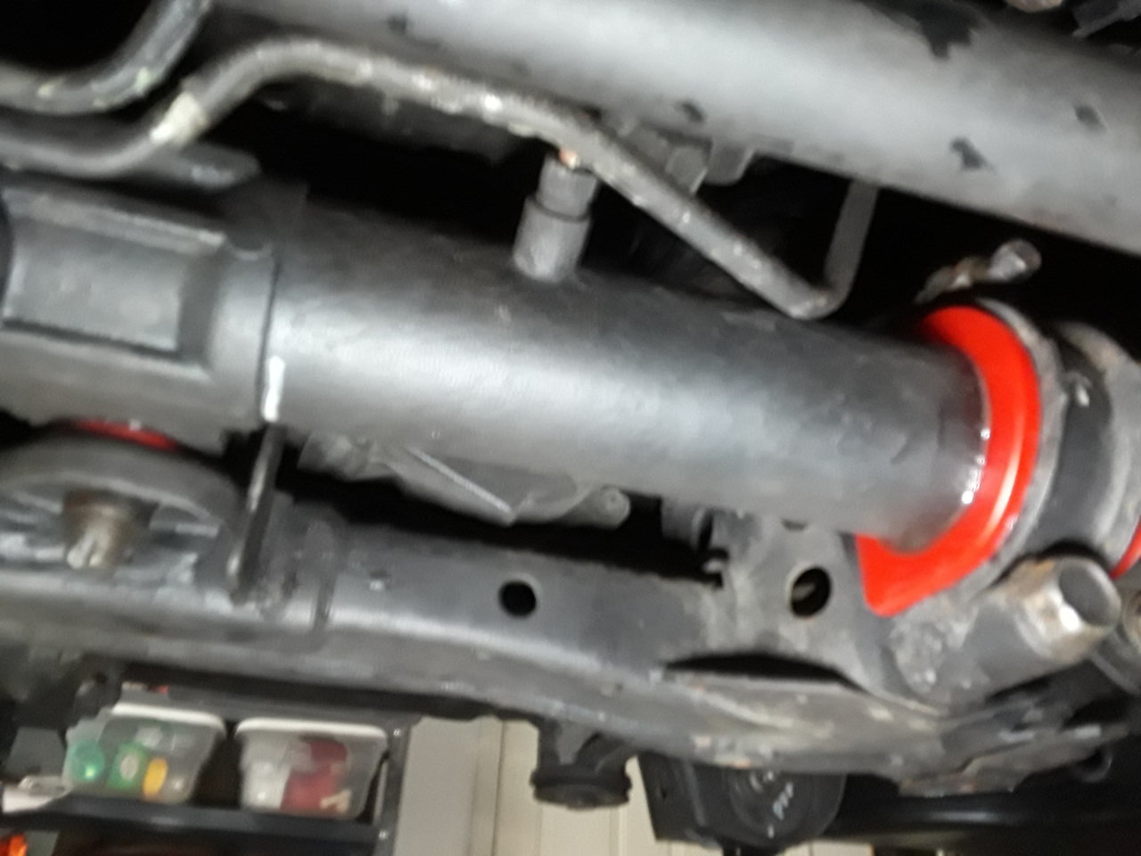

    More than a weekend actually lol . . . LCA's/Ball Joints done.
    ES bushings
    I know, I hate my phone too LOL

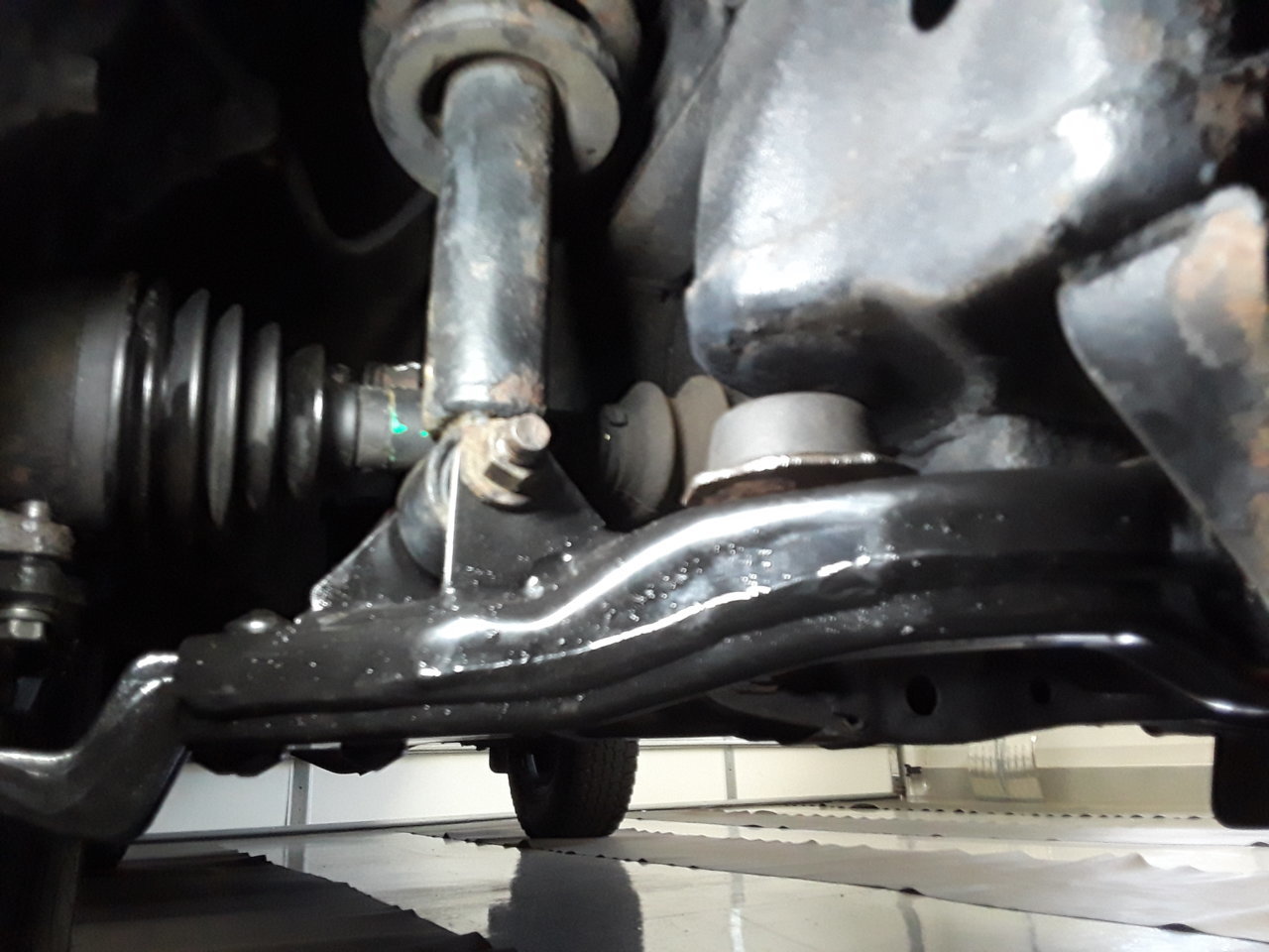

    I totally underestimated the time for taking some of this stuff out. About halfway through I realized there was no way to get this done anytime this month with hand tools. I added more to the budget with a new 1/2 drive impact driver and set of metric sockets. Truthfully, I don't know how I've survived without them so no loss there.
    The tie rod ends almost made me give up, broke my favorite old school adjustable puller on it, resorted to an O'reilly's that needed some Dremel work to slide on the tie rod end. Cranked it until it felt like something should blow, hammering the rear point like Thor or something, no luck. Check on all these videos of guys hitting it with a hammer twice and thinking "man, I wish I were him right now." I squirted it with yet more PB blaster, took a nap, tried again with two more hits and it fell right out.
    Then I did the other side. 20 years of stuck-ness (didn't see much rust.)
    I didn't budget for bump stops and taking off the old ones discovered the front stops spinning, the welded nut on the inside of the arm had failed. On both sides, the front. I had lofty dreams of saving this for a backup set but it was Saturday night, I was zonked, looked at the layers of rust and hours of reconditioning it would take to live up to that one and came to the conclusion I wasn't doing this s**t again for a very long time. :p Drill and edge grinder, cut hole, vice grip that slacker and use the old ones for now.
    Got it aligned and still drifts, they're saying the strut bushings are shot, which you can "kind of" see in the horrible pic above. They were on my list, just hadn't labeled them "next" yet.
    "But don't rule out a steering rack."
    So maybe they're not sure but they were straight about it, the shocks are next. Upper CA's gotta wait, and they look OK for now.
