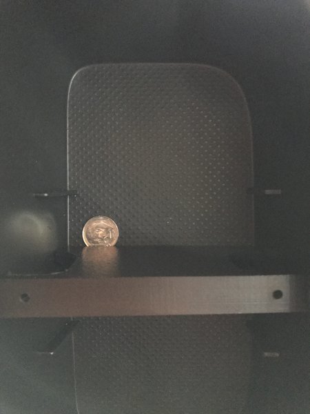

    Hi thank you I got mine and have a question.
    Is it supposed to fit tight/flush with bottom? Mine sits up slightly it feels snug & is riding the center tabs. I just can't get the center support to hit the bottom. Maybe adjust the screws? I love it though top quality made & quick ship. Judy

    Thanks, glad you like it.
    You will see a little gap at the bottom because the base of the cup holder pocket is not flat. The pocket has a ridge down the center and pitches towards the doors. It's really suttle, but it's enough that the center divider contacts in the center and not on its edges. When it's seated, you shouldn't be able to pass a dime under it.
    I snapped this photo with the divider horizontal and the dime is not falling through.
    Please let me know if yours will not sit this low.

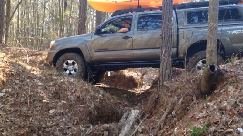

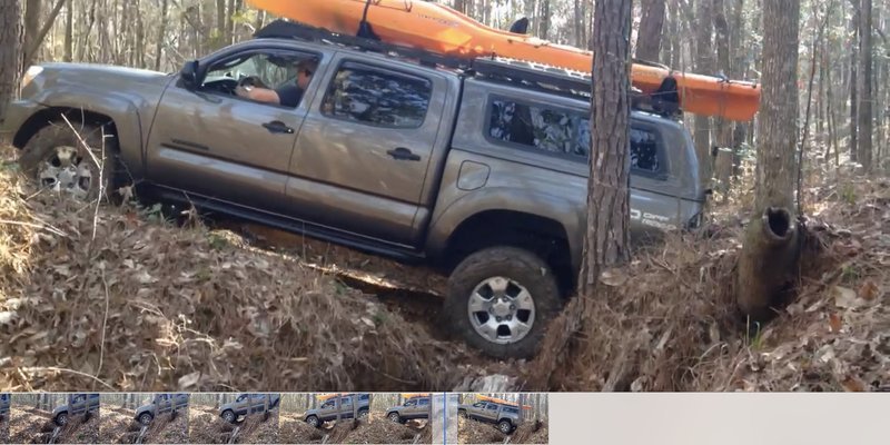

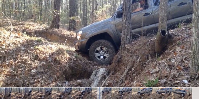

    Restocking the website this evening at 5PM CST.
    Went wheelin over the weekend and didn't have to worry about my 30oz tumbler falling out/over. It was great!

    @Tsumara - all good, I adjusted via your specs and it fits perfectly. :thumbsup:

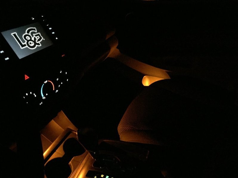

    Because I had the crappy stock rubber cup holders, I put led lights in all the doors and cup holders in my truck except for the two front. Now that I have your new cup holder, led's are going in them this weekend. Pics to follow soon.

    Before:
    After......

    So I did the dime test and it slid underneath is there a way I can resolve this issue

    Sure, there are a few options. Hopefully one of them will be what you are looking for.
    1. I can swap it out for one that should sit flush on the ridge of the pocket. I have made a .5 degree adjustment to the pattern to account for this gap on some trucks. Shoot me a PM and we can get the ball rolling.
    2. You can sand a little of the bottom in the area that is contacting the bottom. It doesn't take much (less than 1/32"). I understand this isn't what you signed up for when you bought my product. If you are game, I can print up some very specific instructions. With a belt sander it takes about 15 seconds and by hand it should take less than five minutes.
    3. Keep on rocking it with a little gap in the back. The gap is cosmetic and will not affect its function.
    Let me know what you want to do.
