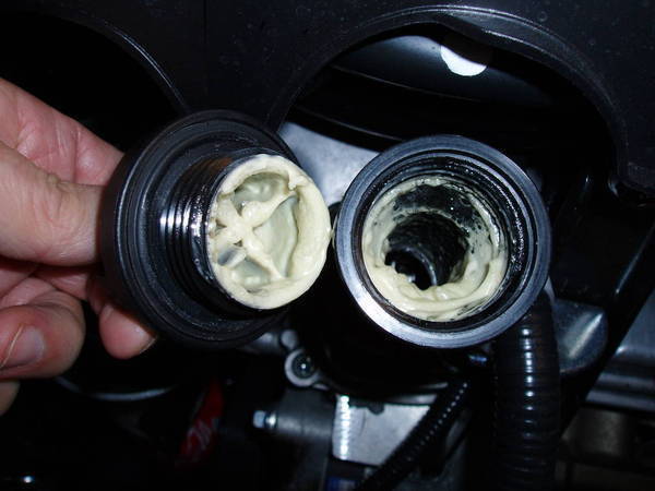

    I just did my first oil change on 2012 with the 4.0L engine at 802 miles. About 60% of the miles have been short distance (daily driver) under 10 miles in weather ranging from 40F to 0F. I was changing it in the dark and noted with my headlamp and lights that the oil seem to be an odd color, like coffee with a bit of milk. I saved a sample to look at indoors and sure enough it seems odd to me. I then proceeded to complete the oil change and was shocked when I opened the filler tube and found more than a heaping tablespoon of a creamy substance which I presume is an emulsion of oil and water. Then when emptying the filter into the drain basin I note a glittery appearance to the oil!
    What's going on?
    The only other time i've seen that emulsion in small amounts was on a high mileage Tercel with a 22R engine. My recently defunct 1993 Truck with the 22RE engine never did this.

    yeah short trips will do this. You need to burn that stuff off every once in a while with a long drive.

    Very, very bad.
    Your driving conditions are not helping... you are getting the engine just warm enough to cause serious condensation issues, but that looks like WAY more than you would expect to see from 800 miles of short hops.
    I hope you saved the drained oil.
    I would send a sample to Blackstone to satisfy my curiosity, but that truck, the drained oil, and the old filter need to get back to the dealer ASAP. You could have a coolant leak, but whether coolant or condensation... water is not a good lubricant, and the "glitteriness" in the old oil certainly sounds bad.

    Yeah, but I'm driving it the same way I've used my 4 banger for 19 years.
    Never seen this...in this amount, all the way down the filler tube!:confused:

    That bad?
    I've never seen it that bad unless the head gasket was blown.

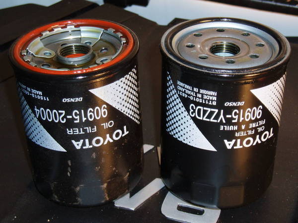

    Here are the filters( the factory one with red o-ring is much beefier than the OEM replacement):

    Ya, cut that factory filter open and you'll find a completely different type of filter.
    Looks almost like a sponge.

    I think its a design byproduct of the filler tube on the 4.0L. It seems to collect condensation from a warming engine. I've never had a problem with it in mine because I am religious about not taking short trips. However, my wife never used to have any issues cranking up the truck to run across the street in her 07. When I started to change the oil, this is what I found every time. I showed it to her, and she has since started to avoid the short trip. The problem cleared up immediately.
    As was said, you need to burn that stuff off...it comes with running the engine at operating temperature. You will also extend the life of the exhaust by keeping the water vapor from settling in the muffler.

    OK, so two followup questions:
    Does it matter how far you drive or how long you drive to burn off the moisture? I guessing the Time is more critical. My commute to work is 4 miles and takes 15 min; the hyothetical guy down the road takes the freeway 15 miles in 15 min. Who burns off more moisture? (I'm guessing the operating temp of the engine should be about the same, esp in winter) FWIW, both my 4 banger Truck and now my 4.0 Tacoma both warm up enough to use the heater in about a mile of slow, gentle city driving. I do not "warm up the engine" before driving even on the coldest days.
    Does this "mayonnaise" affect the lubricity of the oil? (I'm guessing it does) I don't want to be changing the oil every 800 miles in the winter, especially since just put in synthetic.

    That looks pretty suspicious to me. I'd keep a real eye on it. Good thing is that it's under warranty. I've owned a ton load of vehicles and never seen something like that. Good luck!

    The mayo sticks in the neck where it is relatively cold, if it does drip or slide back into the motor it will hit relatively very hot oil and reboil the moisture.
    Nothing to worry about.

    it doesnt help that the filler tube is made of plastic either and is very long. i have a 5.7L tube from the tundra on mine and its significantly shorter.

    Update:
    I drove it 128 miles (all Hwy 60-65mph) and just a bit of "motor mayo" accumulated in the filler neck. The oil remains clear. (so much so it's hard to read on the dip stick. I guess I'll do the dipstick mod)

    I just discovered motor yogurt/mayo in my 06 4.7L tundra last change and was worried as well....never see it in the taco
    Tundra sits for days with out being started and short trips as well although I do allow ample warm up time....also has the long plastic fill tube so this makes sense!!!

    That filler tube is plastic. That's a contributing factor. It's not going to heat up as quickly as the aluminum valve cover. Probably why you didn't have the issue on the 22R. That engine doesn't have an extended plastic spout attached to the valve cover.
    If the coolant isn't down, I wouldn't be concerned. I had the same thing happening on a 22R and it actually turned out to be a coolant leak into the oil. I was loosing maybe a cup of coolant in a month of short trip driving around town. It would burn off on a long highway trip. Once I figured it out and replaced the $2 washer that was leaking, the engine was fine, no damage.
