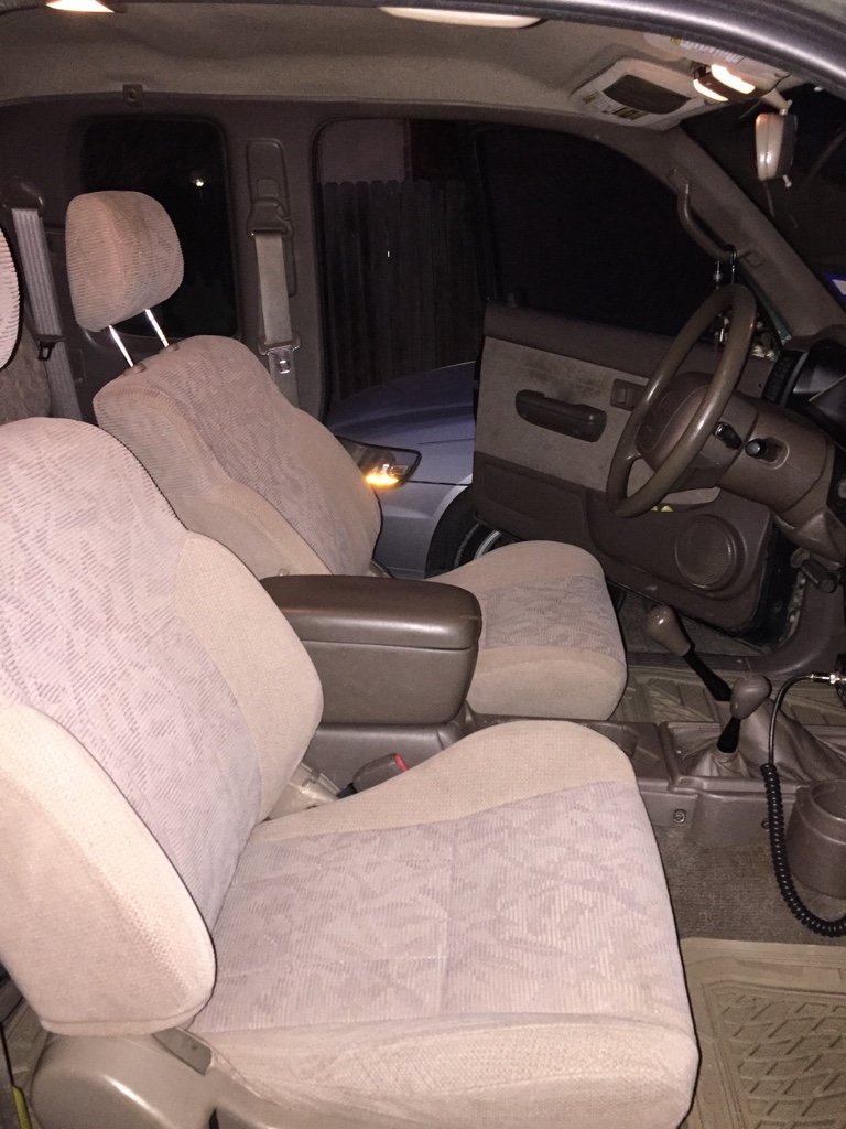

    How easily did the 4Runner seats go in? Any photos? Are they a direct fit?

    BCollett - super easy! I'll get some photos tomorrow.
    Basically 3 of the 4 feet line up perfectly and one was off, so we cut the foot that didn't line of off the 4Runner mount. The top right if I'm not mistaken. Then cut the top right foot off of the old tacoma seat mount and used a nut, bolt and lock washer to fasten the foot to the 4Runner seat mount. All in all took about 2 hours to entirely swap seats and "make" them fit.
    So much more comfortable. You will also need to find a center console, since they are buckets. Just haven't done that yet, the dog fits in between quite well.

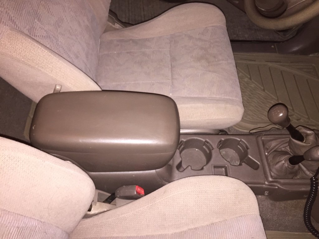

  8. Dec 7, 2014 at 4:49 PM
    sshirley
    sshirley [OP] Well-Known Member
    Jun 25, 2013
    #107002
    160
    Sam
    Austin
    2000 Tacoma SR5 with 400k miles
    Stuff
    Sorry for the super late response, here are the photos of the inside, and today I put in a center console from a 4 door 2004 Tacoma.
