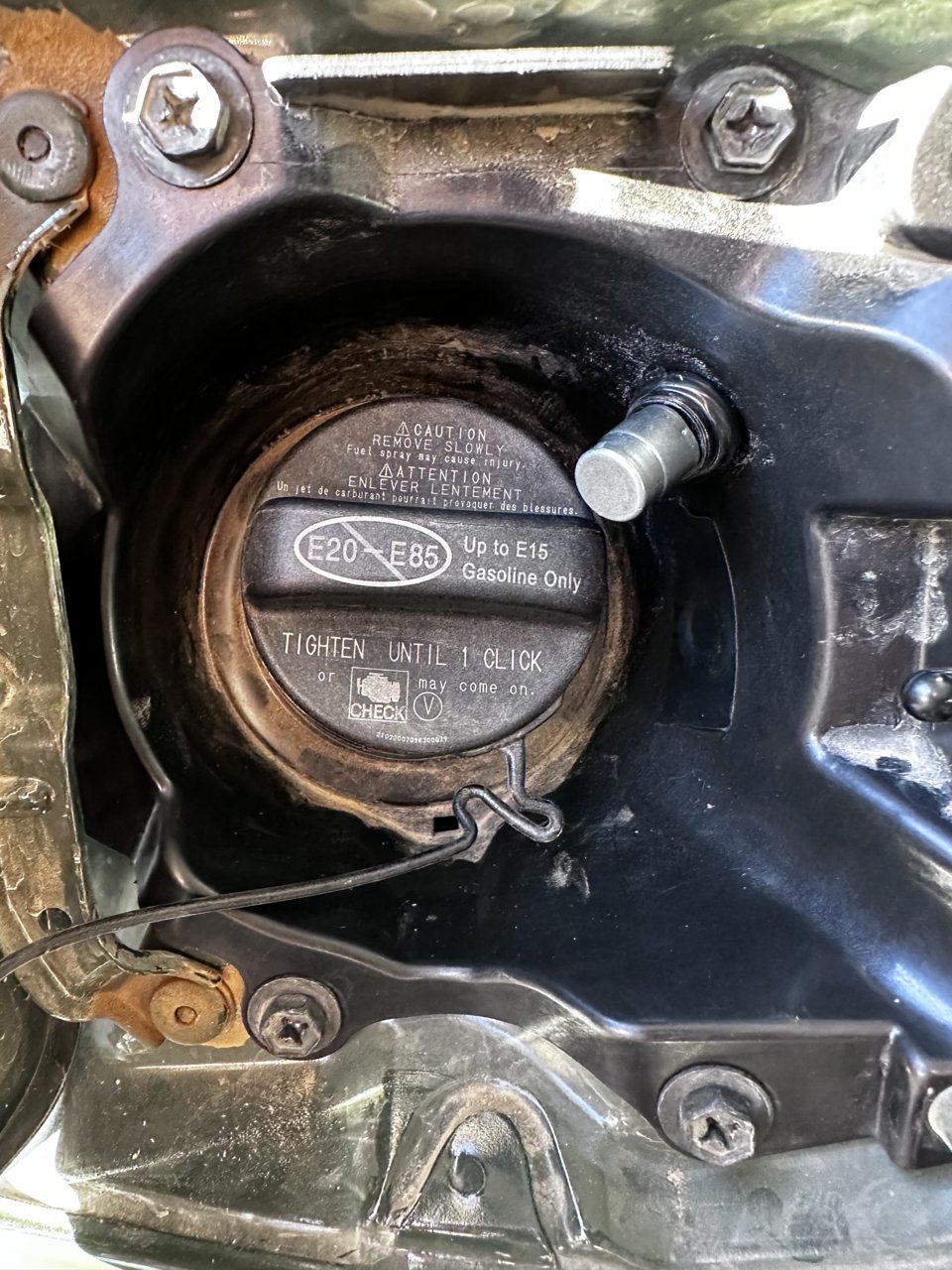

    Anybody running this? If so how where did you run it to?

    I'm not running that kit, but whether you use that kit or make your own "kit" (which is easy), a great place to run the breather is to the gas cap door area.
    Here's how I did it, including links to parts to make it happen: Rear Diff Breather Mod – Why didn’t I do this sooner?
    Note: the parts I linked work with all Taco gens.

    Thanks I referred to this post a few times and got it done!
