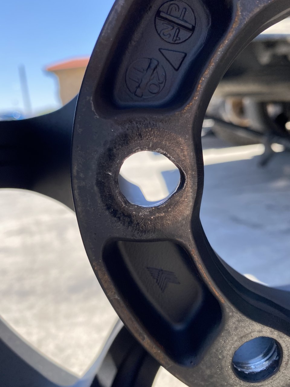

    DO NOT POWDER COAT! I had a nightmare happen with these :(
    this happened when attempting to tighten down the lugs (12xp1.50) the truck wasn’t even lowered off the jacks! Sand blasted and Powder coated at 380 degrees (non ceramic oven) prior to mounting.
    Warranty voided and now I’m out $2,800 total.
    so now I’m going to try these again in the bronze ;) no powder coating. ShowstoppersUSA confirmed I had the proper lugs and the ONLY conclusion anyone can even fathom is the powder coating messed up the annealing of the wheel. Which cast aluminum shouldn’t at this degree as it usually takes 600degrees or more.

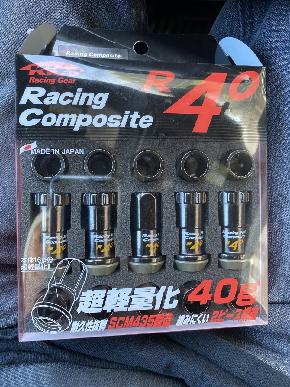

    These are my new lugs I will be using with hubcentric rings
