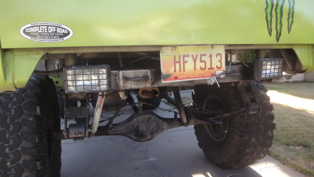

    here we go. Ford 9" rear after breaking 5 sets of gears in the stock yota 8.8, 5.13 gears with a detroit hard locker, 63" chevy leafs and custom hangers, sky's front spring hanger with sky's extream hysteer and PSC hydro assist ram and PSC pump. welded front spyders in the f-550 front dana 60 with warn hubs, pico brake lines and hoses, elecrtic fan, TRD supercharger with URD 2.1 Pully, URD Map-ECU2 and cage built by me. wide band a/f by inovations, lots and lots more...........
    thanks man... no idea where the pics went.... hmmmm ill take a look
    put a few pics up

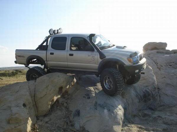

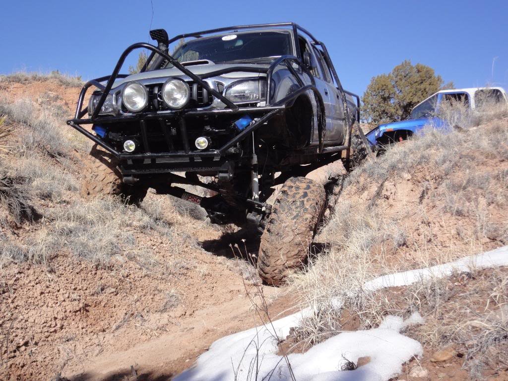

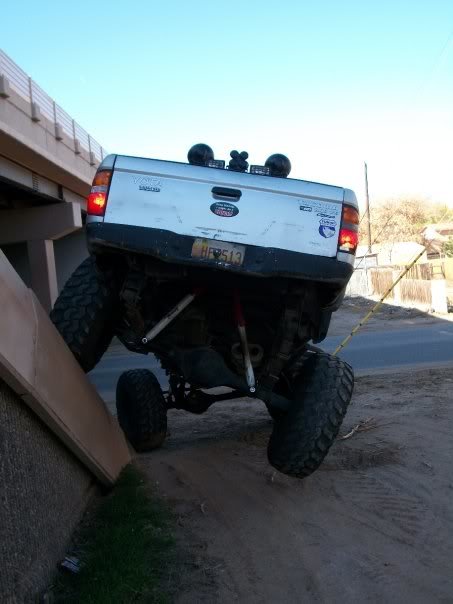

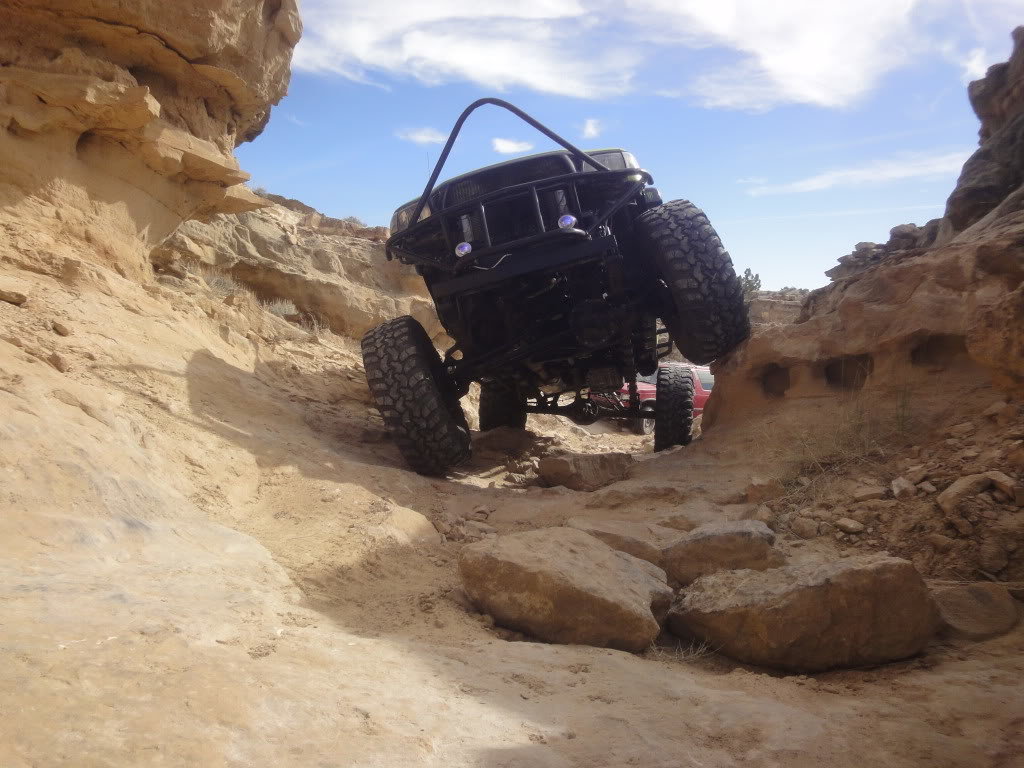

    :eek:Thanks for getting those pics up, man! That thing can flex haha. I love the cage! :D Those clusters/gauges are pretty sweet too. lol, who am i kidding, i love the whole thing!:rolleyes:

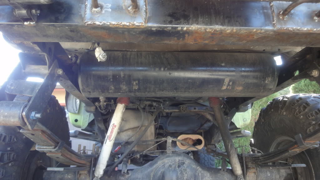

    Your truck is kick ass! do you happen to have a pic of where you mounted on board air?

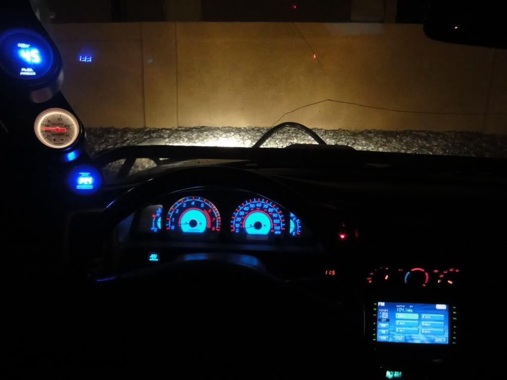

    F'ing Badass! How'd you rig out your dash gauges like that?

    the gauge pod came out of a neon i just took the heat gun too it and molded it to my A pillar

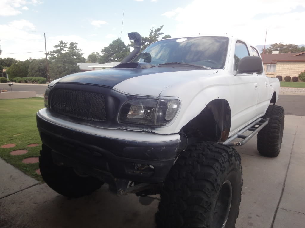

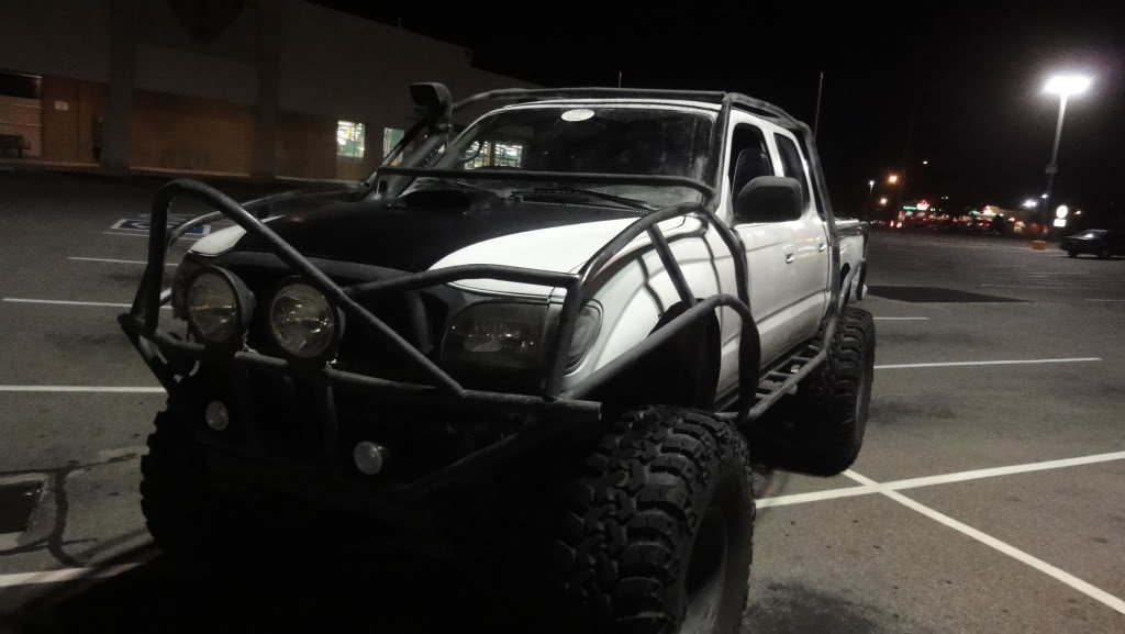

    Sorry if i missed it, but what size tires are those? They just look bigger than 37s
  19. Nov 28, 2011 at 5:32 PM
    #119
    98_Mud_bug
    98_Mud_bug 98_mud_bug
    Aug 9, 2008
    #8431
    3,190
    lucedale Ms.
    98 tacoma sr5/ 06 x-runner
    3 inch suspension lift, night shades corner and blinkers projector headlights with halos and 3 led's 18 inch kmc xd rockstar wheels,275/65/18 kelly safari tsr's, bush whacker fender flares 7 inch touch screen, 2 kenwood 12's, Magnaflow exaust single in dual out,
    i think they are 42's
