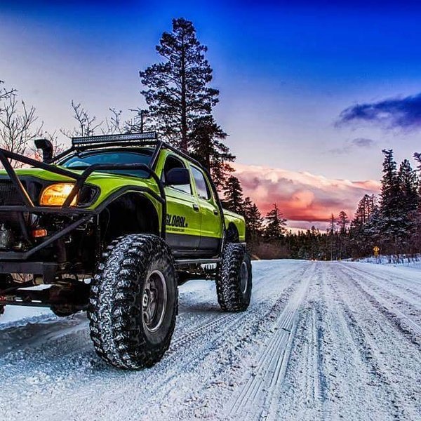

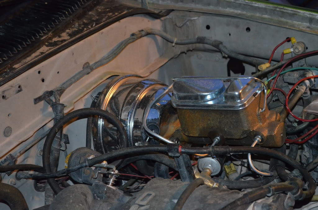

    here we go. Ford 9" rear after breaking 5 sets of gears in the stock yota 8.8, 5.13 gears with a detroit hard locker, 63" chevy leafs and custom hangers, sky's front spring hanger with sky's extream hysteer and PSC hydro assist ram and PSC pump. welded front spyders in the f-550 front dana 60 with warn hubs, pico brake lines and hoses, elecrtic fan, TRD supercharger with URD 2.1 Pully, URD Map-ECU2 and cage built by me. wide band a/f by inovations, lots and lots more...........
    flatbed and cage.

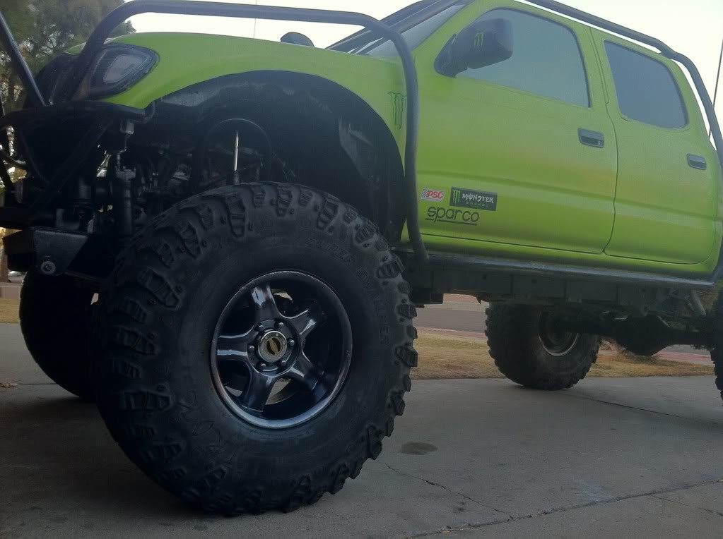

    41" iroks

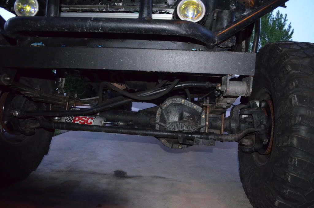

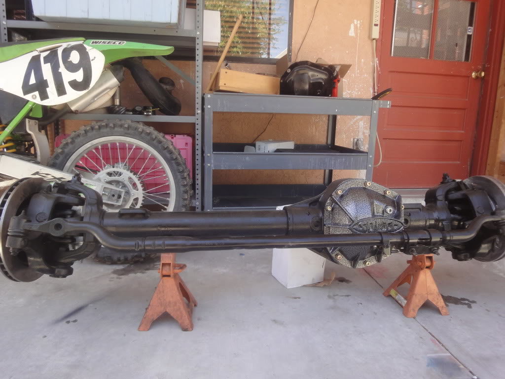

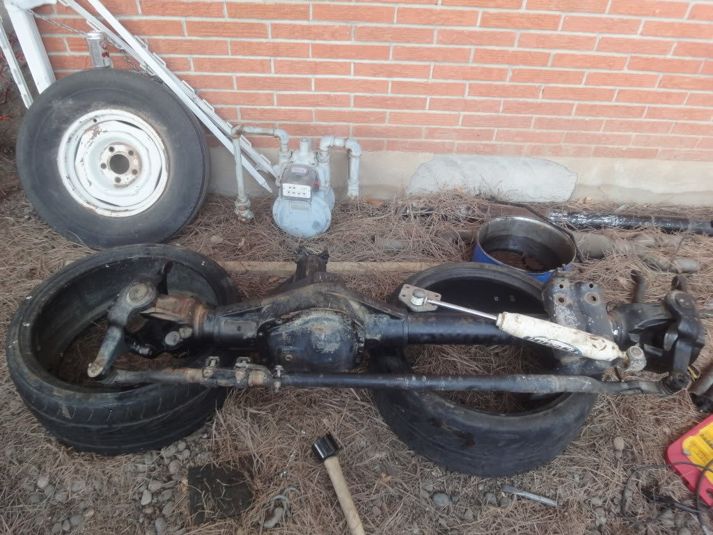

    DSC02759_13f6dc269c43fe2f1994944b0ccbf8974445891f.jpgdana 60 out of a f-550 DSC02774_808e67a2f8324236ac1d144d5857fe20e5f73720.jpgput a little work into it and lots of cash for gears and shafts and hubs and 6 lug conversion lol IMG_0321_265e8c4b353afb96403b4099604ab0a3afb9aadc.jpgstarted the cage...IMG_0329_654712bcf314482380a2dfbbd3df23b905031e3c.jpgalmost done ran out of pipe...

    Sweet.
    And get the 60 on already!!!! haha :p

    it is on. been on for a few months already

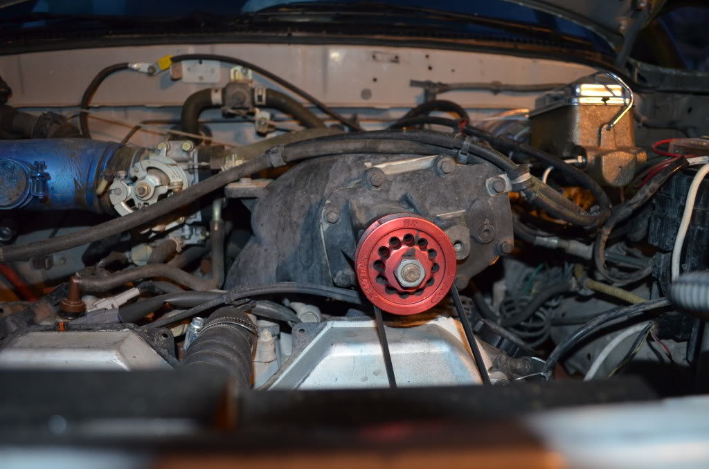

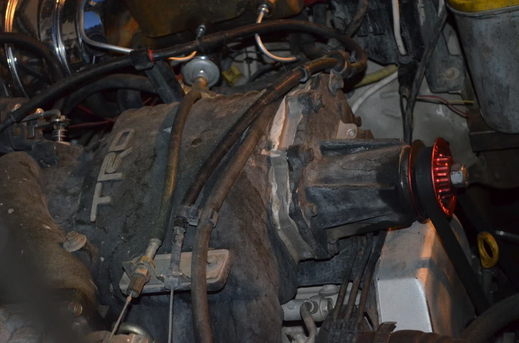

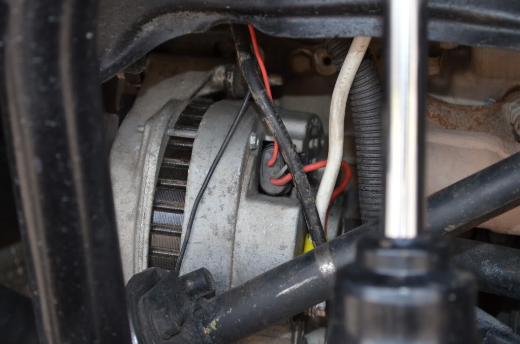

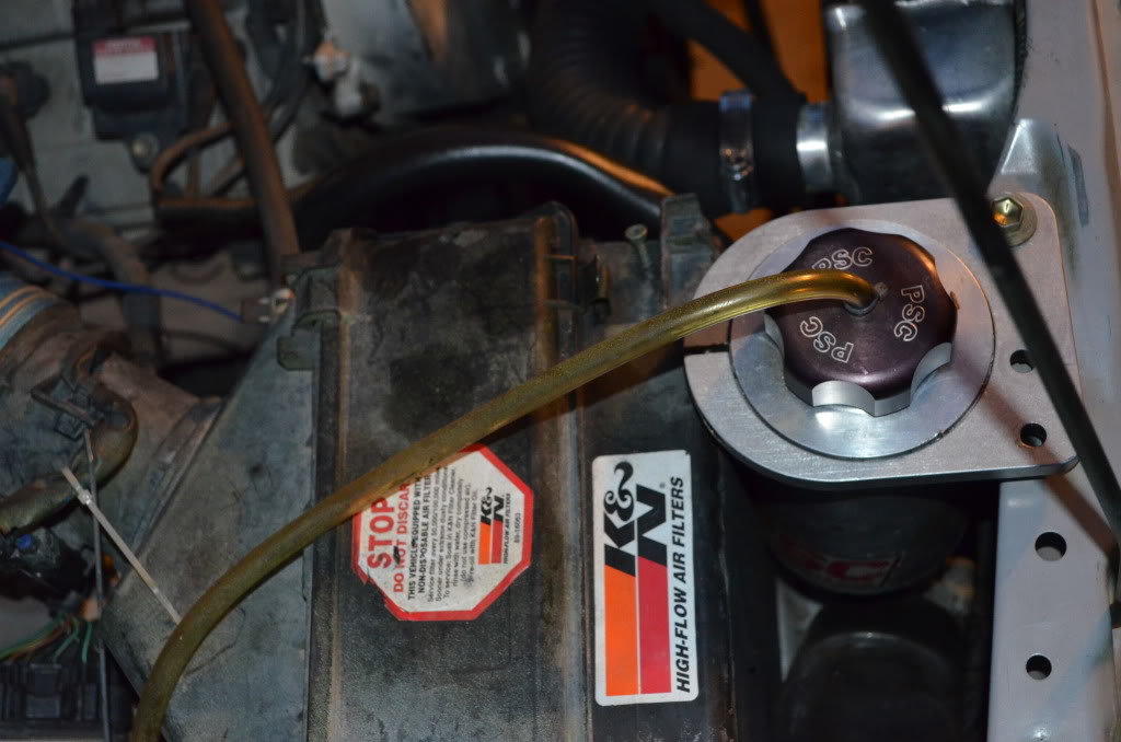

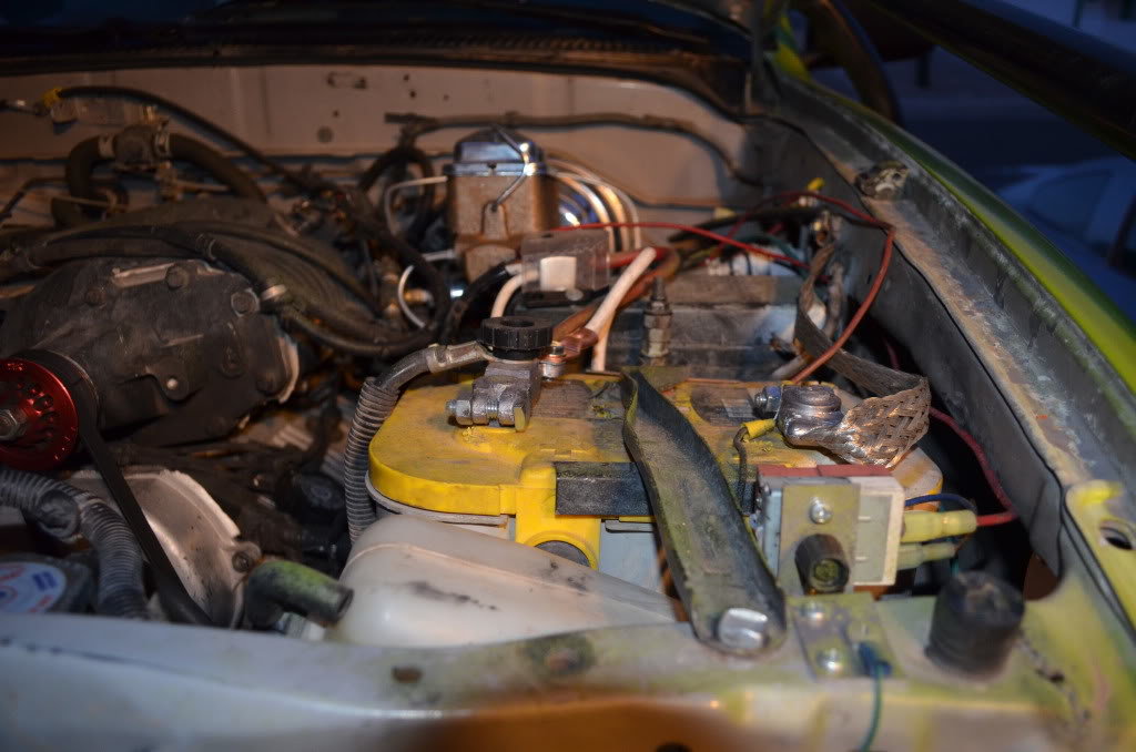

    my CS-144 alt install! DSC_0047_f69c7eecb1034b902fbd67a757d59279838dfd39.jpg
    DSC_0046_93824ec1cc50523510fab585d546e968472a54dd.jpgDSC_0020_e205503b7bf856f4d1353c2ab5b211698bc85606.jpg

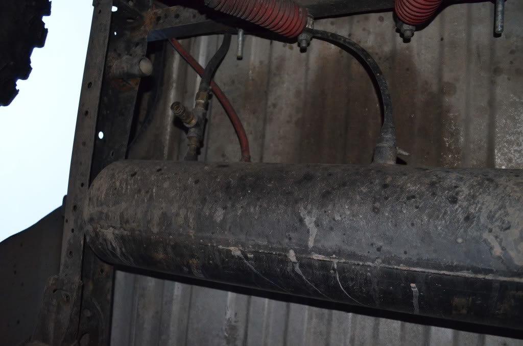

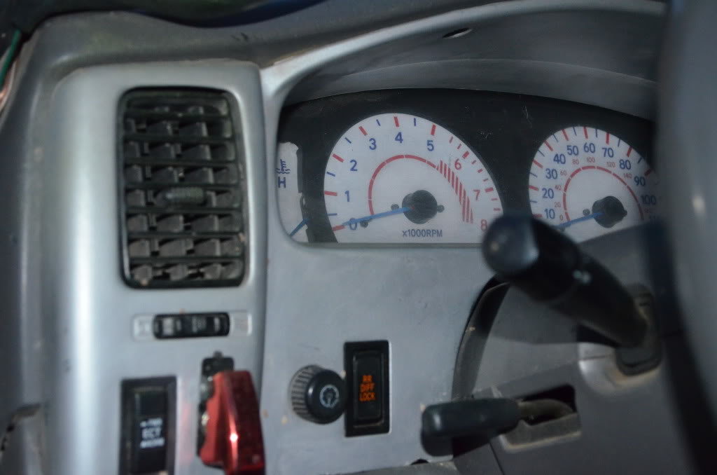

    thanks that reminds me that toggle on the dash is for the twin Viar pumps behind the rear seats

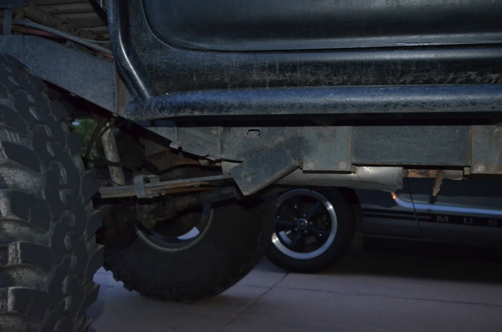

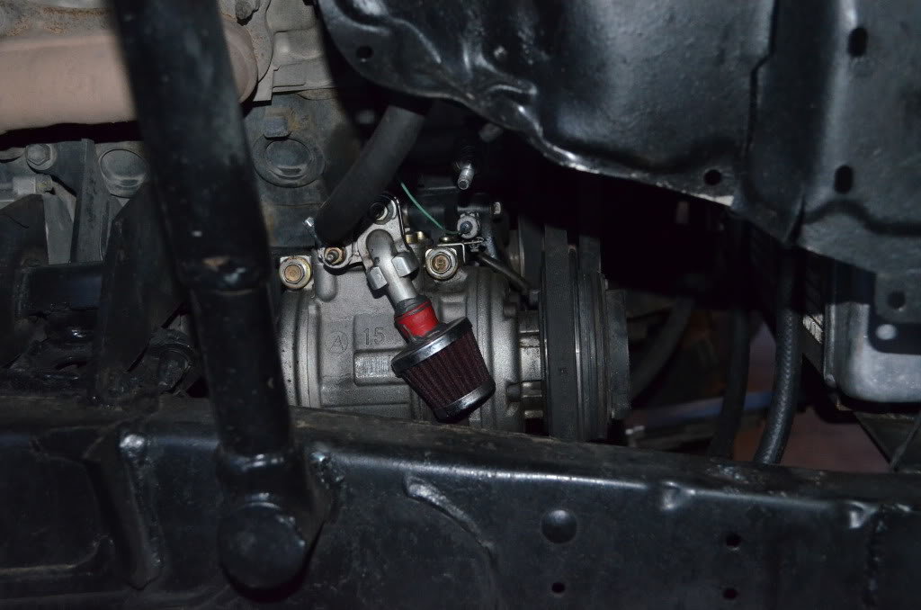

    hey buddy nice rig! something i caught, in this picture your pinon angles is almost straight with the drive shaft, do you get any issues with transfer binding with set up like that? because i've always been told that the angle from your transfer and the angle from your axle is suppose to match. DSC_0033_c1318aab1b673445364af103efccbb319722f0ad.jpg

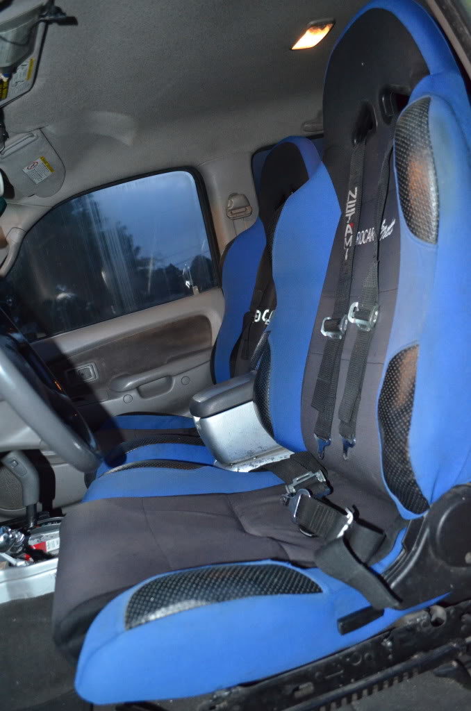

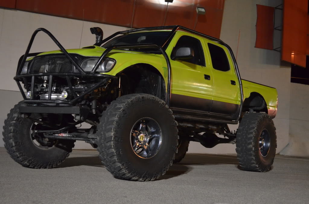

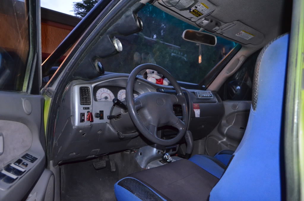

    Love the build, i have to ask how you did the race seat swap? and what kind of seats are those!

    If he's running a double cardan joint at the t-case end of the driveshaft then the pinion should point directly at the t-case. If it's just a standard u-joint then the angles need to match.

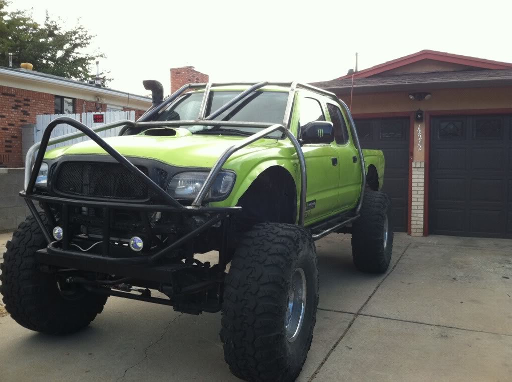

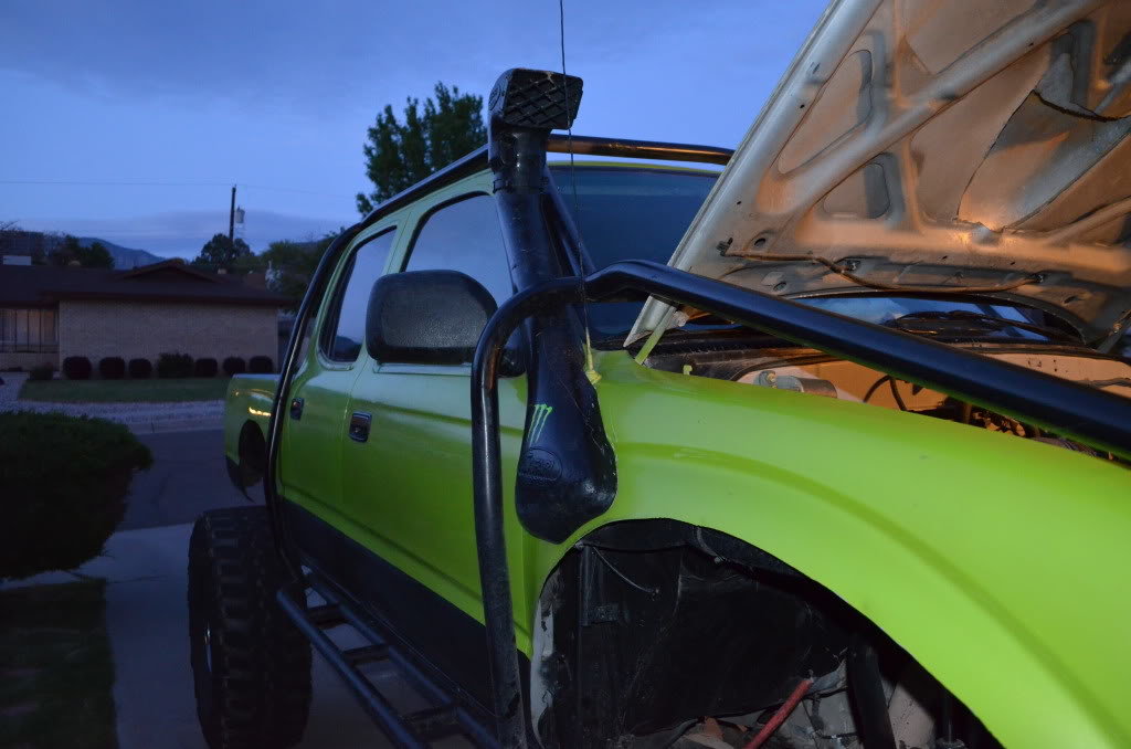

    This is what the truck looks like right now

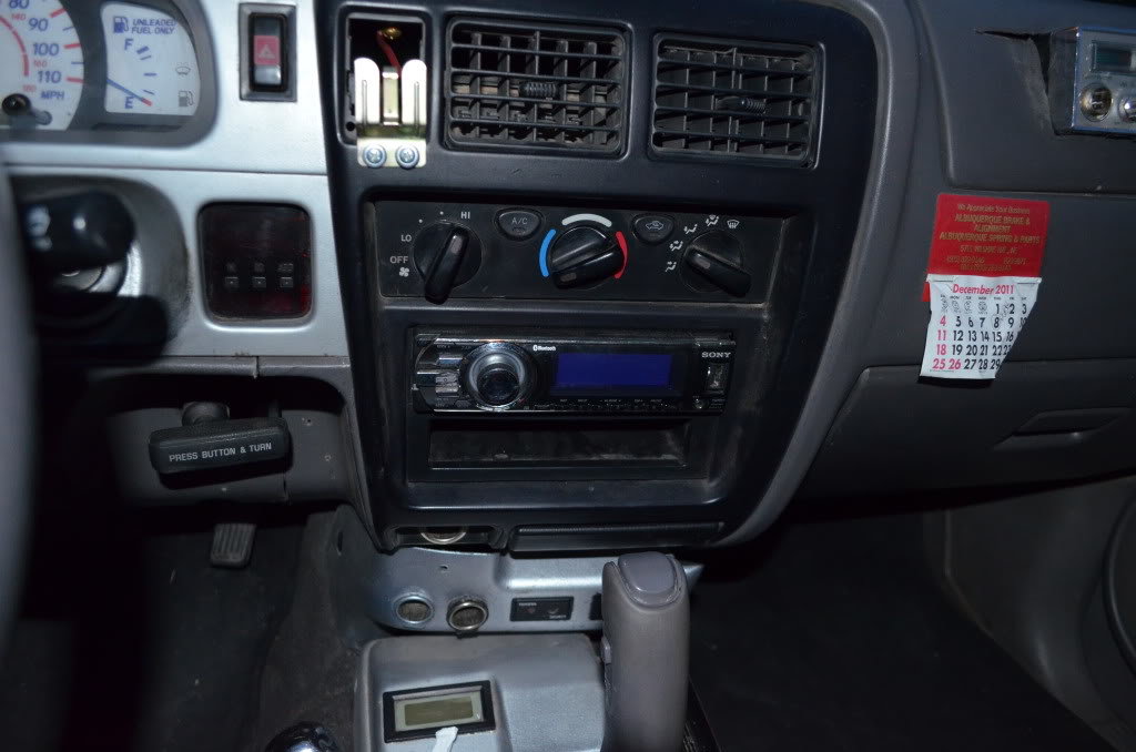

    PROcar seats. i used the factory sliders and just welded up a few cross bars and drilled them for the seat mounts.
