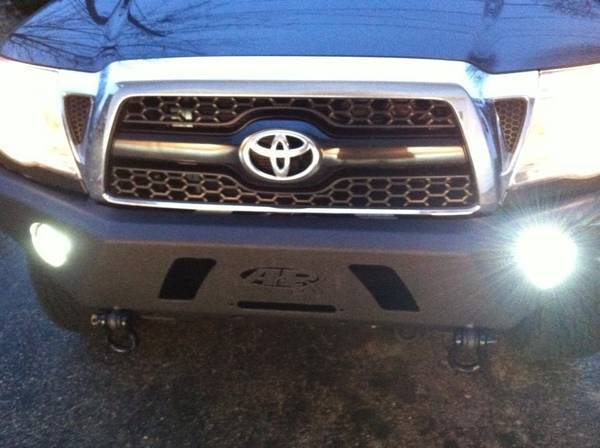

    Ordered and installed All-Pro Apex front bumper and skid :headbang: I epoxied some heavy duty magnets to my front license plate for easy removal.

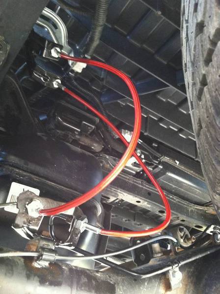

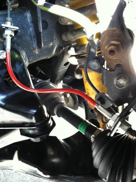

    Installed PIAA 530 fogs into the stock foglight wiring harness. Ordered and installed OCTacos' SS lines. :thumbsup: Also got Smittybuilt shackles for the front. Vent Visors installed to keep the fresh air flowing and the rain out.

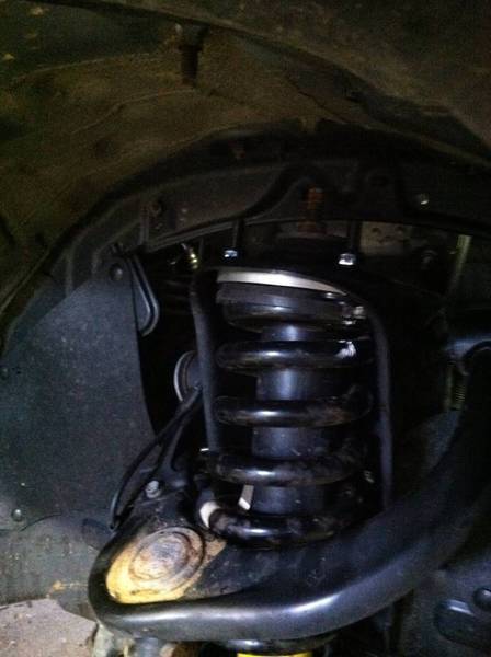

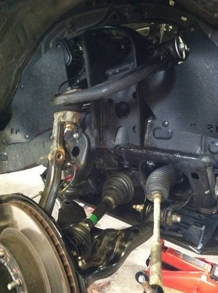

    For months its been bugging me that I have lost lift in the front end after adding on the APEX plate bumper and the skid plate. When I measured 2 weeks ago the difference was 1.5" between the front and the rear. Not friggin' cool. With what I've read on the threads and a slightly used set of spacers from nj636 it was go time.
    I pulled the struts and noticed I did have the 886X.
    Pretty simple removal. Popped the tie rod ends. Popped the sway bar link (I decided to get rid of the whole thing). Remove the top three bolts on the tower and the bottom bolt from the LCA. Done.
    Dropped the struts off for installation of the new studs.
    Installation was really tight, so off went the lower ball joint assembly. Moving the LCA at that point was a dream.
    Spacer seats well. Note how close the spring is to the UCA. That sucker rubs on the passenger side, and I'm hoping it'll settle in with a little bit of driving. The driver side looked perfect. Good excuse to buy some UCAs if that spring doesn't behave itself!
    All back together, torqued, and looking sweet. :thumbsup:
    This mornings measurements (center hub to bottom fender):
    DS- 22"
    PS- 22.5"
    Rear- 24"
    This evenings measurements after jumping a few speedbumps:
    DS- 23.25"
    PS- 23.5"
    Rear- 24"
    So I have a slight 1/2" rake. I rule :headbang:
