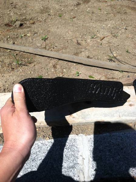

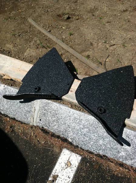

    BAMF IFS skids came in and I decided to Linex them. Linex guys forgot to get them done over the weekend so they coated them free of charge :D
    Shoutout to JLee at BAMF. Check them out for the newest hotness!
    http://www.bayareametalfab.com/
    Here they are raw:

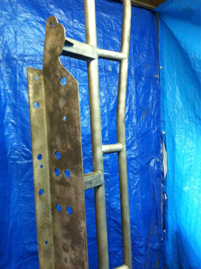

    Another TW member sold his 2011 DCLB, and was selling a set of All-Pro sliders ( ) that needed paint. The price was right so I figured I would put in the elbow grease and rehab them, and resell to help fund my build.
    Using a 30-gallon compressor and a Crafstman media blaster loaded with Black Beauty (http://www.blackbeautyabrasives.com/products/) I set about taking them back down to bare steel. I was working the compressor hard, but wanted to keep operating at 100psi to ensure I was really knocking off all of the rust.

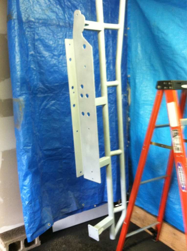

    I checked all the welds and they looked solid. The blasting media left a nice roughened patina on the sliders that I was happy to see, because I knew it would make a great surface for the self-etching primer.

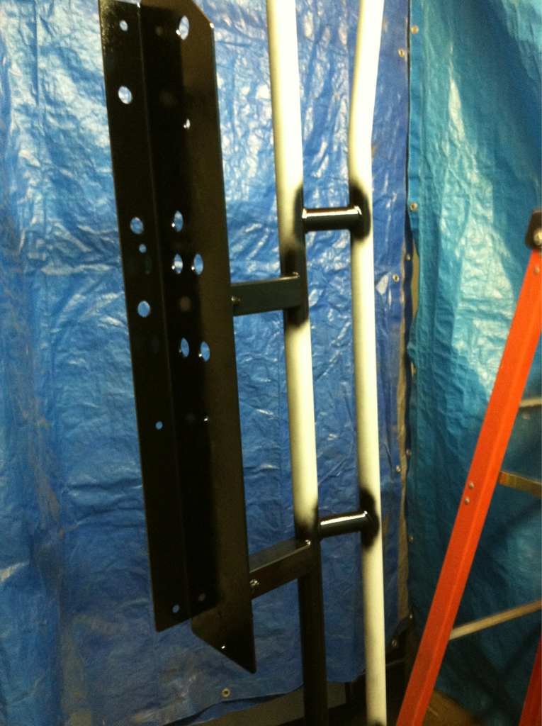

    Once the primer cured I got to work spraying the first coat of black Rustoleum enamel.
    You can see it was going on really well. I let that coat cure for a couple days before I sprayed the second coat.
    Change: Humidity got trapped under the primer and I wasn't happy with the durability of the rustoleum, so I'm reblasting them and sending them out for linex.

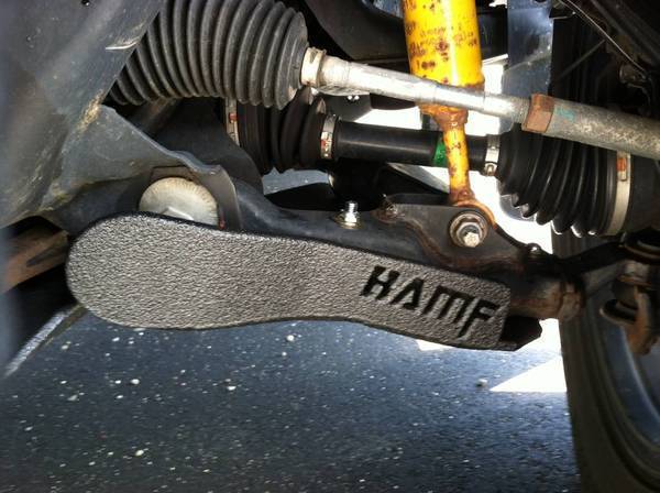

    So I finally got them linexed.
    The only bit of prep work you need to do for this install is to widen an existing hole in the LCA to accommodate the 3/8" carriage bolt. Seen below:
    Hold the skid up, slide the bolts through, and tighten them up!
