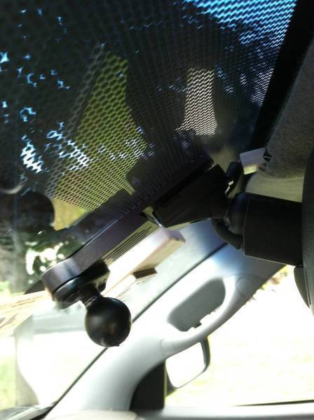

    Cruising the threads and came upon this:
    http://www.tacomaworld.com/forum/2n.../290086-fs-cvrv-mirror-riser-new-product.html
    Got to talking with Tom (Tbird), and they needed a hand researching the convenience mirrors with the back-up camera screens. For my services they cut me a good deal and sent the bracket out with a RAM ball!

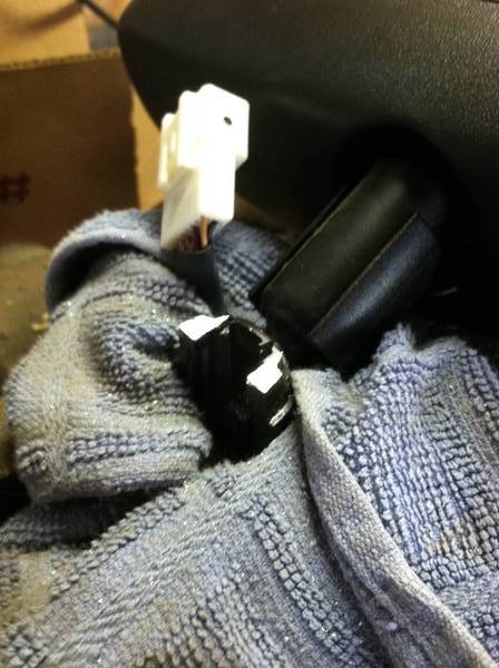

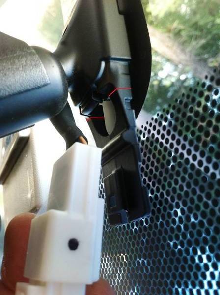

    I disassembled the two plastic covers, unplugged the connector, and removed the mirror. In order to make it work you have to trim the top section off of the "dovetailed" mirror base that has the attachment piece for the electrical connector. I showed my cuts in red:
    Then I filed the cuts smooth:
    After that the bracket goes in where the mirror was mounted. Tighten it using the supplied set screw, and then attach your mirror. Tighten the mirror using the oem screw. Reconnect the wiring. And at this point if you have the RAM ball attach it using two 1/4" 10-24 machine screws (not supplied).
    I'm almost 6' tall, and I had no idea how much visibility was lost due to the rear-view mirror. I love having it moved!
