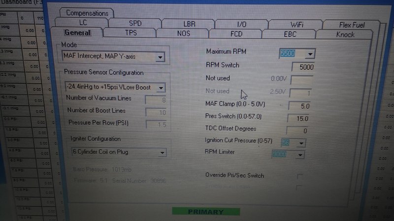

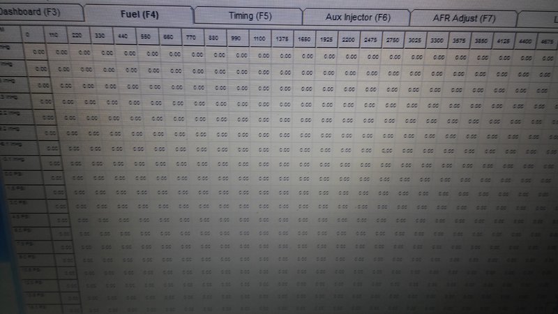

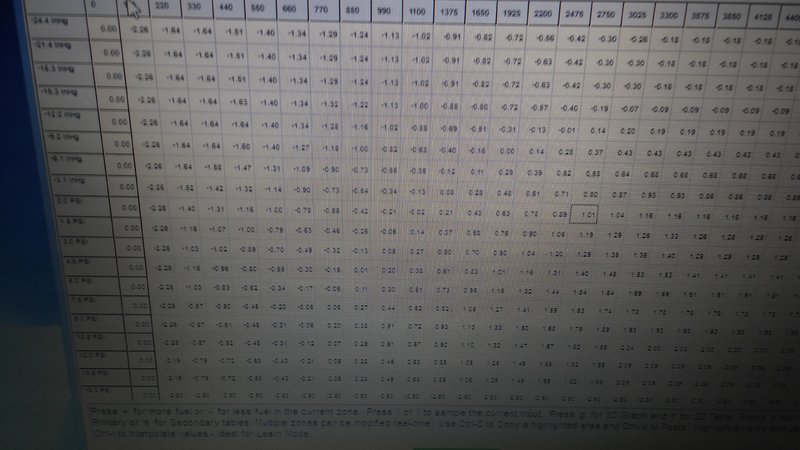

    If my hair wasnt beautiful af, i would have prolly started pullin it out by now. Fuel tables auto generate after i zero them out20170306_152220.jpg 20170306_152401.jpg 20170306_152418.jpg 20170306_152447.jpg 20170306_152457.jpg 20170307_174608.jpg

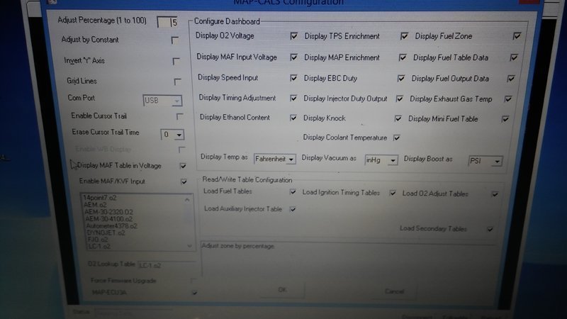

    What is the "ignition Cut Pressure"?
    Why do the three RPM selections not match, or are not closer?
    TDC Offset degrees. I don't believe that you have to setup timing, but is that what selection is for? Or simply to advance the base timing?
    I see a lot of checked boxes for stuff you aren't using. Such as ethanol content.
    @MadTaco461 any advice on his configurations?

    those are all very good questions @Torspd
    I haven't called tech, but I was thinkin about shooting gadget an email if I couldn't resolve it today(by "I" I mean the people of TW that have knowledge about what the heck I am doing here).
    oh and the only one of those questions I have a clue on is the rpm... I set it to 5500 and the rest are preloaded I think. it's 5200 rpms isn't it? I can change it but from what I understand that mostly just changed the resolution of the table (its a 10k max and I basically cut it in half so each box is roughly 2x bigger than the original size, I could be wrong because that has happened before, but not when @ChadsPride was watching, as noted in my signature)

    5500 is oem limit. What I see is that your RPM limiter is 3500 more than your max rpm.
    Those should probably be the same.

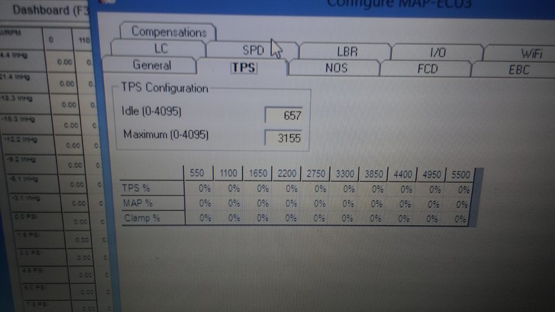

    Have you verified that your throttle setup is correct?
    ChadsPride likes this.

    For my Haltech, my TDC offset angle had to be set at 525º maybe that is an issue with yours? Maaaaaybe.
    yota243[OP] and ChadsPride like this.

    yeah that is the only thing I have really been able to get an accurate sample of since it isn't running correct. I went to the tps set up and took a sample with no pedal depression and set that for 0% and full depression sample used for 100%, I may try adjusting the TDC and see if that fixes it, and that fuel cut pressure is just If I reach 56 psi of boost it will cut fuel hahahahahaha

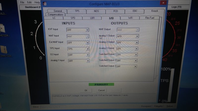

    I have been PMing @yota243 over the last week. Please check out bold answers.
    I think his problem is that loading the correct base map is holding things back. MAPECU is very picky about loading maps. My big red flag is the fuel table needs to be all 0s. He is running stock injectors. Right now he is changing the MAF value. He just wants to pass the data through as if it the mapecu3 isn't connected. All tables (fuel, timing, afr adjust) should be zeroed out for maf intercept map y axis.
    On the mafcal dashboard. A good thing to check when trying to start the truck is to check RPM and MAF in and MAF out. Should fire up since I'm pretty much wired up the same way.
    I saw something about pressure switch. That doesn't matter what value is put in there either. He isn't using it. It is used to ground trigger a solenoid say to run meth injection or NOS.
