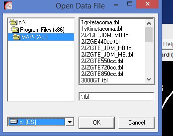

    for some reason I cannot find the file in os>programfiles>map-cal3> (the it should be 1gr-fetacoma.tbl as it appears in the mapecu software, but it doesn't show up) it is in the program though

    It should be in there. Hit Compatibility Files. You running the new 3.5.1 software? I'd run that since you are just starting up. They said there are some bug fixes.
    http://www.mapecu.com/2014/05/mapcal/
    I wrote you a map attached here. Unzip it. Drop it in your mapcal folder. Might need to hit the compatibility files.

    I might have made a mistake with the COM port being COM instead of USB under under mafcal config FYI since you use a USB cable.

    ok thanks I was running 3.5.0 I'm downloading 3.5.1 right now, so I just need to change it to usb when everything loads up and should be good?

    Yup and save map

    hey so I got that base map moved over into the data files of the mapecu, do I need to like wipe out everything on the mapecu3 then load it, or will opening the file just overwrite everything that is in there?

    You need to write that file to your mapecu3. Should take a few minutes because you will see all your tables getting written over. I did suppress all the secondary tables so it loads faster.
