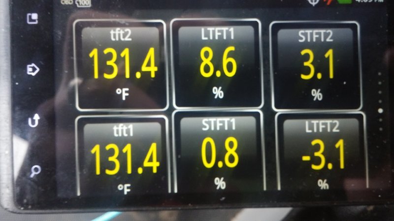

    This is what I am thinking.

    What do you see?

    that my ltft1 and 2 are different... rafiki

    That temperature reading. Is that of the coolant?
    Check the trims again when it is at its normal temp, and post them.

    na that's the tranny

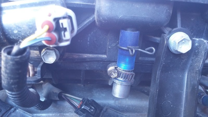

    A vacuum leak might. It would likely show a greater fuel deviation though.
    As long as the port on the intake manifold, which used to be for the PCV is capped, then you shouldn't have a pcv vacuum leak.
    ChadsPride likes this.

    Take a picture of that port. What do you have there?

    Just a metal plug that came with the catch can kit
    20170315_125615.jpg could i use this port for boost lines also? I already t'd in the brake boost line(with check valve added goin to the booster) but i thought it would look a bit less jank if i went here, atleast for the boost gauge and/or bov

    Yes, you could used it for a boost, FPR, map sensor port.
