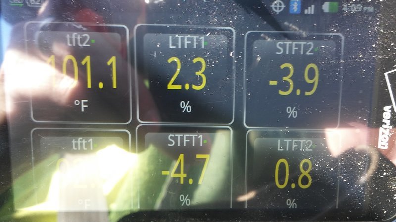

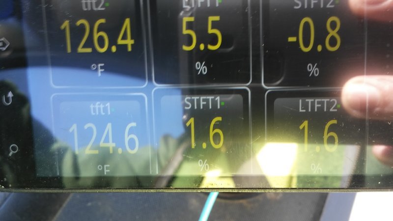

  12. Mar 15, 2017 at 4:20 PM
    #372
    yota243
    yota243 [OP] Well-Known Member
    Aug 22, 2012
    #85267
    21,656
    E.J.
    north Alabama
    turbo 05 prerunner trd off road DC
    Bw s256 turbo with 3 in glass pack dumped pre axle raptor liner bed and top rails and fenderflares and rocker panels. Hunter side steps. Plasti-dipped upper fenders and emblems. satin black spray paint here and there inside and out. 5100's set to 1.75" up front . C channel front bumper. Maxxis bighorn 255/85/16
    Better? Idle (~600 rpm) 20170315_160928.jpg and closed loop (~1600 rpms)20170315_162830.jpg

  13. Mar 15, 2017 at 5:34 PM
    #373
    MadTaco461
    MadTaco461 BRO runner
    Dec 30, 2009
    #28470
    13,439
    CA
    99 turbo 5 lug long travel
    Kinda stock
    Yeah that looks better. LTFT does take a little while to add up. Not sure where the LT breakpoints on your truck is at. Idle, cruising and higher rpm cruising is good to check. Keep the trims under +/-10% with boosted applications is good. Doing a easy pull from closed throttle to open loop is how you check fuel trims. Let us know if you get a new CEL after you clear this one.
