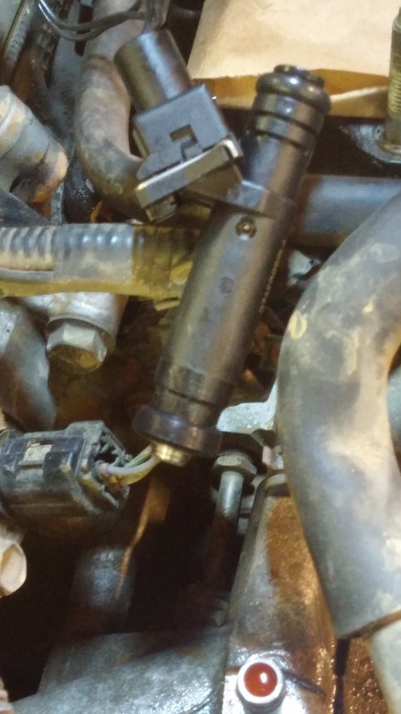

  5. Jun 29, 2017 at 7:21 PM
    #445
    yota243
    yota243 [OP] Well-Known Member
    Aug 22, 2012
    #85267
    21,636
    E.J.
    north Alabama
    turbo 05 prerunner trd off road DC
    Bw s256 turbo with 3 in glass pack dumped pre axle raptor liner bed and top rails and fenderflares and rocker panels. Hunter side steps. Plasti-dipped upper fenders and emblems. satin black spray paint here and there inside and out. 5100's set to 1.75" up front . C channel front bumper. Maxxis bighorn 255/85/16

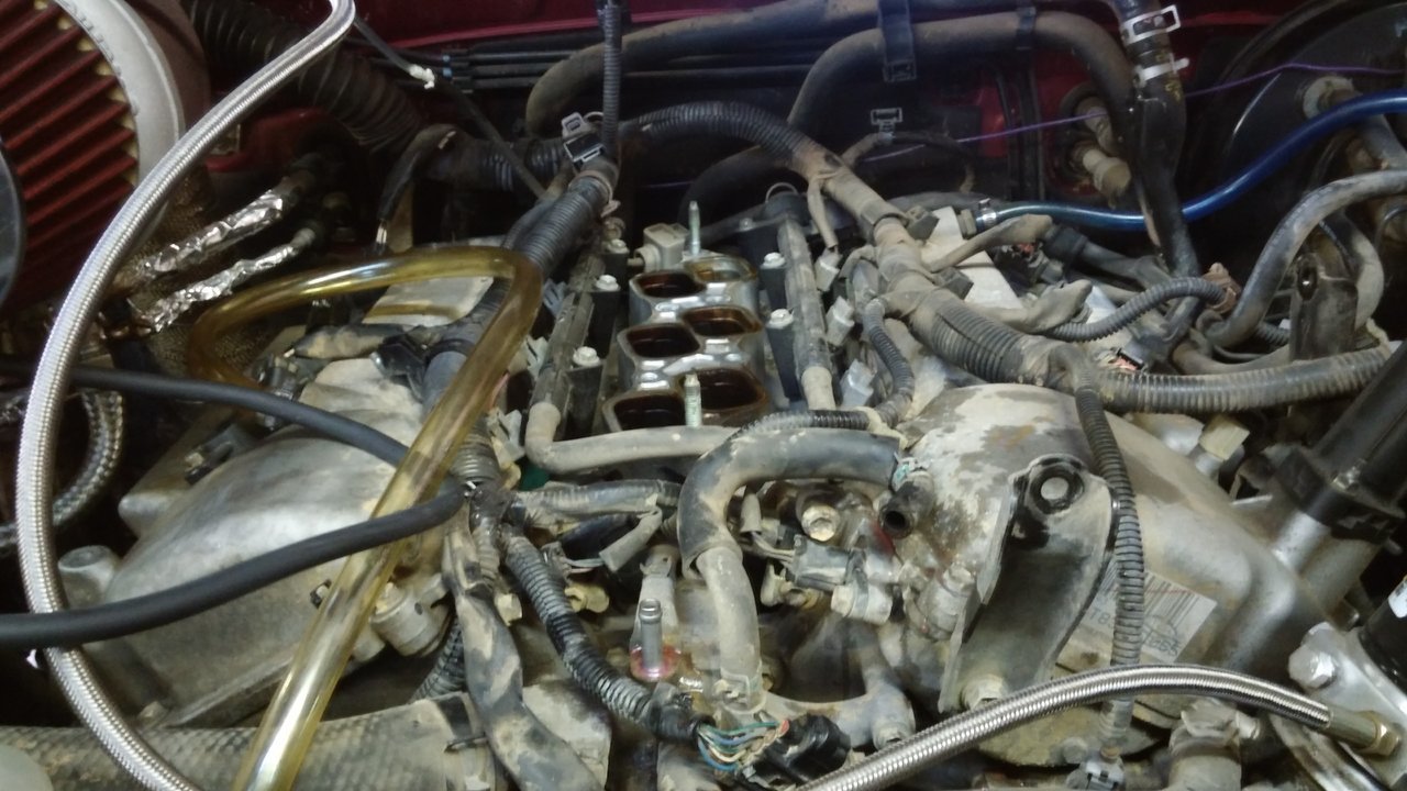

    Injectors are in and big hands and tight spaces are for the birds
    And i only dropped one o ring down on the valves but we fished it out

    Looks good man. Hope u got it running with no leaks. What size injectors did you end up with?
    yota243[OP] and ChadsPride like this.

    The 61# from urd

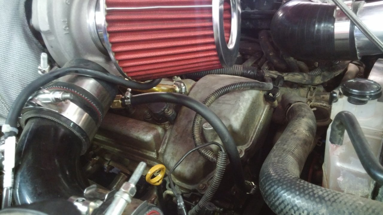

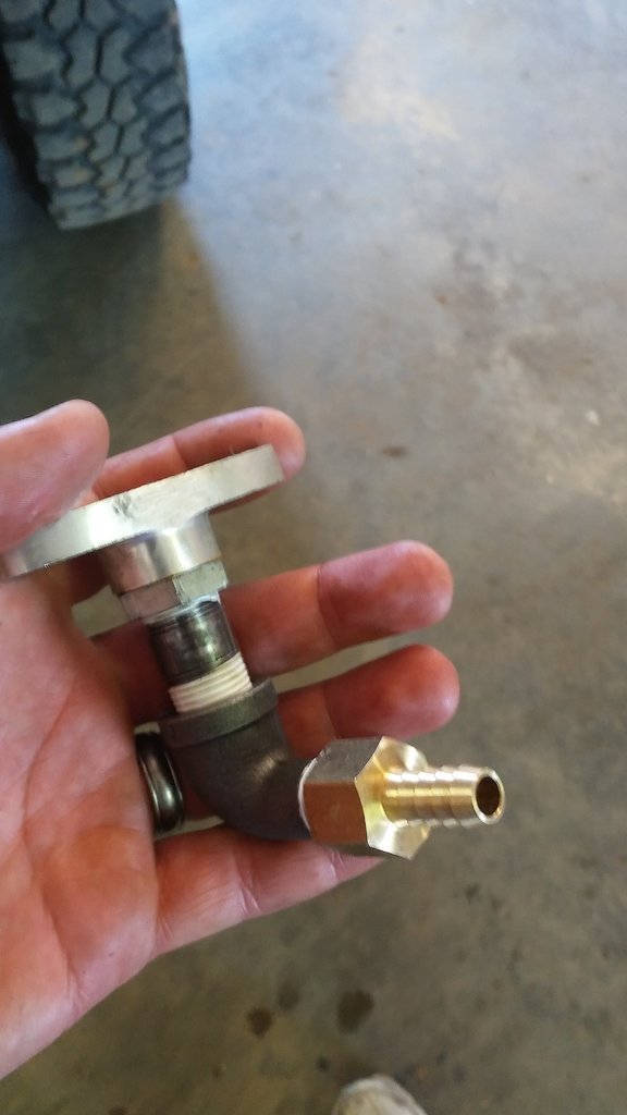

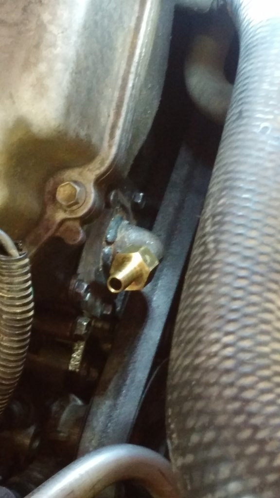

  11. Jul 24, 2017 at 5:12 AM
    #451
    yota243
    Aug 22, 2012
    #85267
    21,636
    E.J.
    north Alabama
    cracked my oil return line a couple weeks ago and then replaced it with a hydraulic line which must have been a little small ID because I had oil coming out my exhaust pipe :bananadead:, went to lowes and picked up some iron and brass and now I hope I have a solution :fingerscrossed:

  12. Jul 24, 2017 at 6:44 AM
    #452
    Torspd
    Torspd Tor-nication
    Sep 18, 2009
    #22958
    26,439
    Tor
    The Great America!
    MMVI 4.4L 4x4 Access Cab
    Torspd Custom Turbo kit [] Borg Warner 9180EFR Turbo [] Haltech Elite 2500 [] TiAL Q BOV [] TiAL V44 Wastegate @ 15psi [] CP Pistons [] CP Carrillo Rods [] ARP Head studs [] ARP Main Studs [] ARP Header - Head Studs [] Ported Heads w/ 1mm oversized valves intake/exhaust [] Brian Crower Forged Stroker Crank [] Darton M.I.D. Sleeved Block [] Kelford Camshafts [] Torspd 160* T-stat mod [] APR Large Fuel Rail [] Walbro 460 LPH E85 Fuel Pump [] FueLab FPR [] APR T56 Conversion Kit [] KP RACING Built T56 [] McLeod Racing Custom Twin Disk Clutch [] One Piece Aluminum Driveshaft [] MGW Shifter [] Custom lowering kit [] Ohlins Front Coilovers [] QA1rear shocks [] Custom Ron Davis Radiator [] Dual SPAL Electric Fans []
    Is it working properly now?

  15. Jul 24, 2017 at 6:56 AM
    #455
    yota243
    Aug 22, 2012
    #85267
    21,636
    E.J.
    north Alabama
    maybe... right after I got everything hooked up I hit the shower and headed to the casino so I didn't fire it up, and it still isn't tuned so I guess "it" if you are referring to the truck/turbo set up, then no it is not. hopefully this fixes the oil issue now and I can get to work on the tune and that should about wrap it up:burnrubber:

  17. Aug 10, 2017 at 7:29 PM
    #457
    yota243
    Aug 22, 2012
    #85267
    21,636
    E.J.
    north Alabama

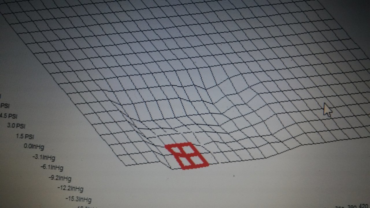

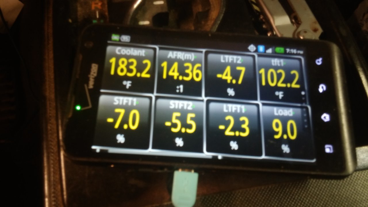

    Got her running pretty good up to 65 mph <2500rpm vacuum leak around injectors (dont throw stock injector isolators away, they are pretty crucial or do like me and spend $25 on new ones) and had my wife co-pilot while i pulled fuel.
