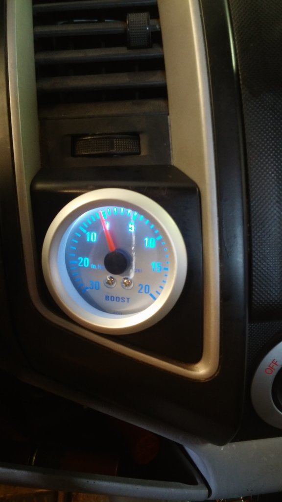

    took the vbands loose last night and tried to realign and tighten them. I think I help a little but there is still a little leak. I'm gonna order some better bands and go from there. I still need to tune, but my buddy rode with me last night and while driving I was able to build some boost so things are looking up
    https://www.youtube.com/watch?v=6vDd3Gg3WoE and its gonna sound pretty mean anyway haha hopefully ill get some tunage worked out this weekend, and then it will just be some little stuff here and there to wrap it up

    Can you put a little Red RTV in there to help seal it up? I've never used V-bands so I don't know if that's kosher

    I'm not sure. I guess if it worked and I never had to take em apart again that would be ok, or I guess I could just re apply it every time I had to take em apart for anything.

    It's kind of a pain that you have to let the RTV set before starting it up, but if it cures your leak it may be worth a shot. I have a 4 bolt flange on my downpipe and I didn't use a gasket, just RTV. Same on the wastegate. I haven't had any leaks after about a year and a half.

    the thing about mine is that its just kind of an awkward position to try and get everything lined up properly and then tighten the clamp. We were pretty careful to measure and mark during the build, but I guess sinces its all SS and a lot of it, things may have tweaked a bit during the welding process and there is just a little bit of elbow grease required to make everything fit close to perfect

    I see. That makes sense. Sucks that such a small change in angle can make such a huge difference.

    yeah its close, like the driver side is touching on the bottom and within an 1/8" on top, I think that a good vband will close that much of a gap when tighten, where I think these cheaper ones are just bending and not really sealing up

    still gotta get some new clamps for the vbands because there is still a little leak and I need to pull some fuel when it jumps into boost but it is running at least (hit nearly 80 mph when I went down to mexico this weekend)
