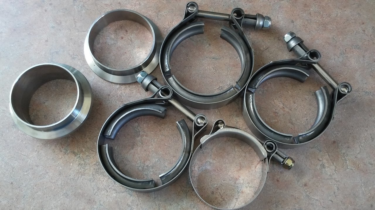

    Are those v-band flanges the style which slide completely over the tubing?
    ChadsPride likes this.

    I dunno im not plannin on using those flanges since i already have flanges welded on

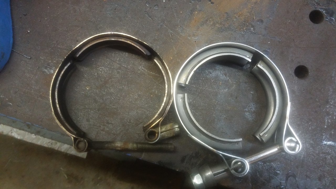

    little difference in the quality of the ebay vband clamps and the cxracing calmps [​IMG] truck spools about 400 rpms faster now; did have a little stumble about 85 mph but I still have a little tuning to do. this is 3/4 throttle or maybe just a little more. I put it to the floor after I filmed this and its gonna be pretty fast one of these days.
