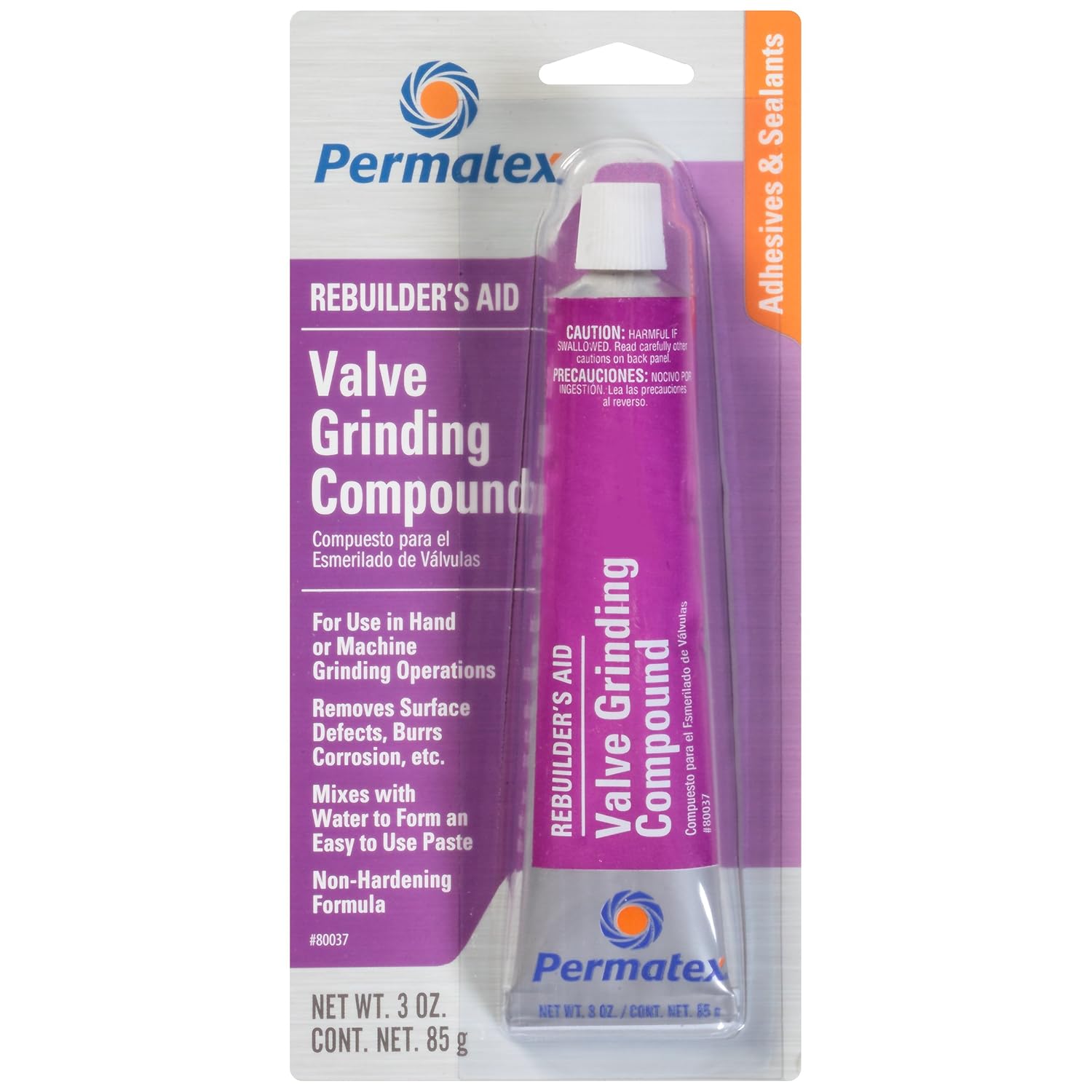

    Chinese haven't figured out how to machine a good valve seat. Could try some of that valve grinding compound if you can pull apart and spin your valve.
    Only reason why my cheap BOV doesn't leak is because they used an o-ring to face seal the valve shut.

    Are u sayin use like lapping compound on the valve or the valve seat ring thing? I have some compound i bout for recrowning a mosin nagant barrel so i may give it a try

    exactly something to help reshape the material to seal up nicely. I'm sure whatever gun stuff you have that is abrasive is like this.

    Yeah i have a corse and a fine, but are u saving to do the valve or the ring?

    The valve and seat mating surface.
