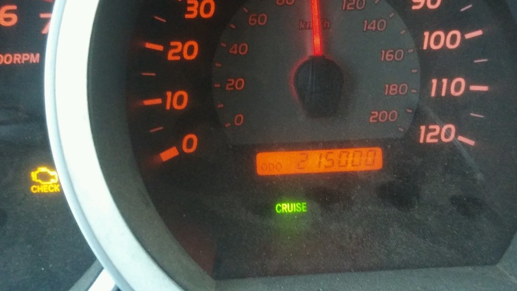

    @yota243 did you ever have head gasket issues with your truck since its an 05?

    I have not, it will get replaced with a cosmetic if I start having issues, but as long as oem is doing its job, imma let it

    Absolutely! I dont blame you there, id do the same as well. I was just curious after seeing your odometer and that you have an 05..

    Perfect picture for those individuals who ask, "how many miles are too many for boost?"
