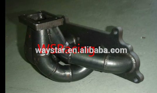

    here is that mani btw

    I ain't buyin nothin from IndoChina land! Takes months to get here, IF it gets through customs
    ChadsPride likes this.

    Well, if you want cheap, you might have to settle. LCE is developing a turbo manifold right now, but it will be more than you can source the ozboost manifold for.

    I can confirm that the manifold is NOT shitty, and it took all of about 1 week to arrive to my doorstep, along with the downpipe....via FedEx.
    Also- it cost me about $325 for both with shipping.

    That's pretty reasonable. I've never had good luck with ali baba, though.

    That manifold is the only piece that KirkRio still has from his OzBoost kit. Everything else has been replaced and upgraded.
