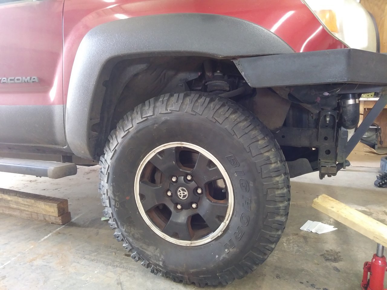

    Bw s256 turbo with 3 in glass pack dumped pre axle raptor liner bed and top rails and fenderflares and rocker panels. Hunter side steps. Plasti-dipped upper fenders and emblems. satin black spray paint here and there inside and out. 5100's set to 1.75" up front . C channel front bumper. Maxxis bighorn 255/85/16
    Feeling cute might delete later... Also 255>>>>>>>>>>>>245 for the record... I forgot how good 33s look

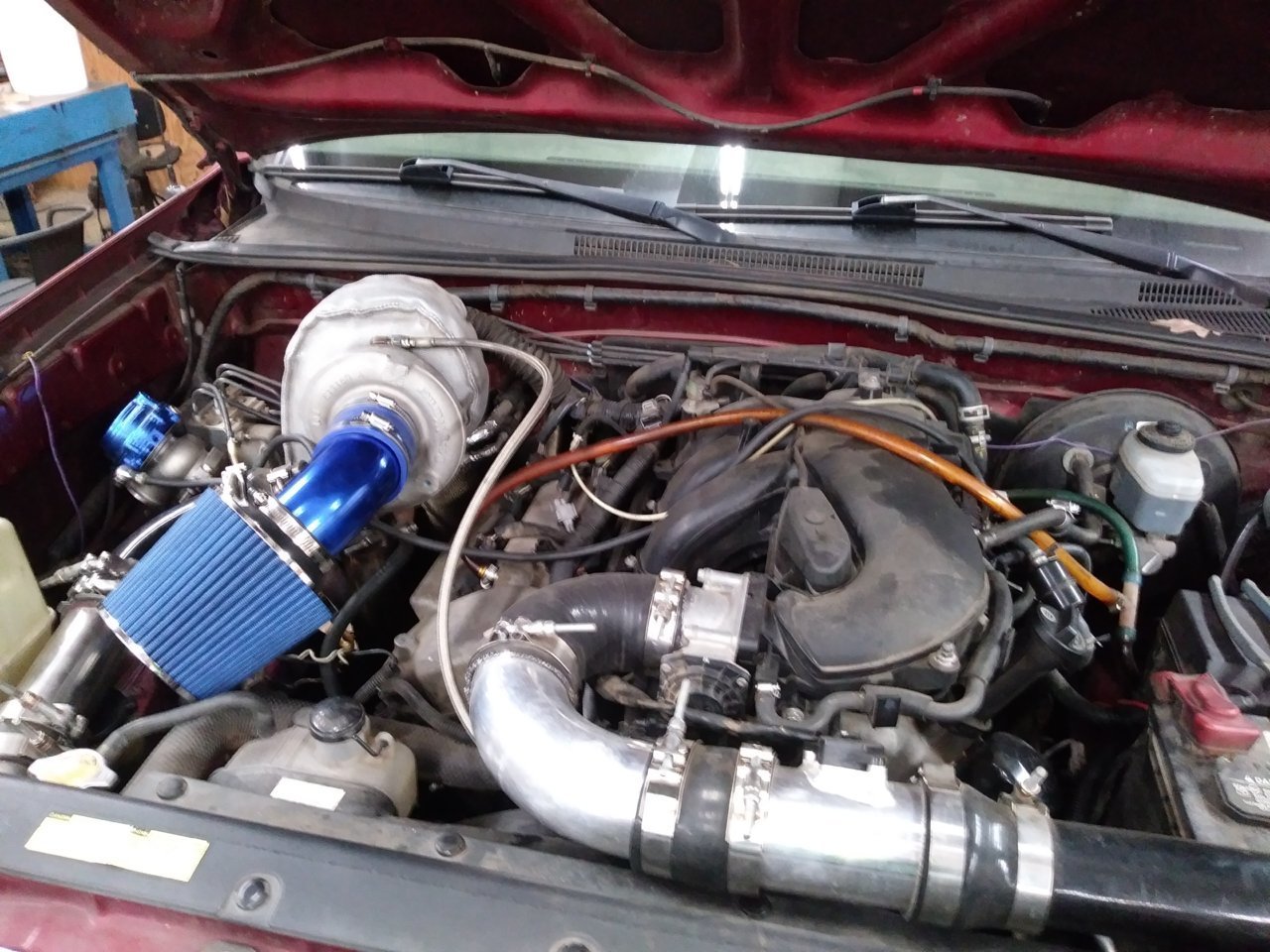

    oh no, i had oil all in the intake and intercooler from when i had too small of a return and oil blew past the seals... return has sense been fixed and oil is removed and maf is clean and tune is tunie... and fingers are crossed

    yeah its crazy how a maf coated in oil will screw with how a vehicle runs

    Filter bigger than the turbo lol

    cant have a restriction now can i?

    them funds though... i need to get an wide band and a flex fuel sensor and hook it into my piggyback... but i think i have some mechanical issues causing some of the gremlins cuz my fuel trims are still a little jank
