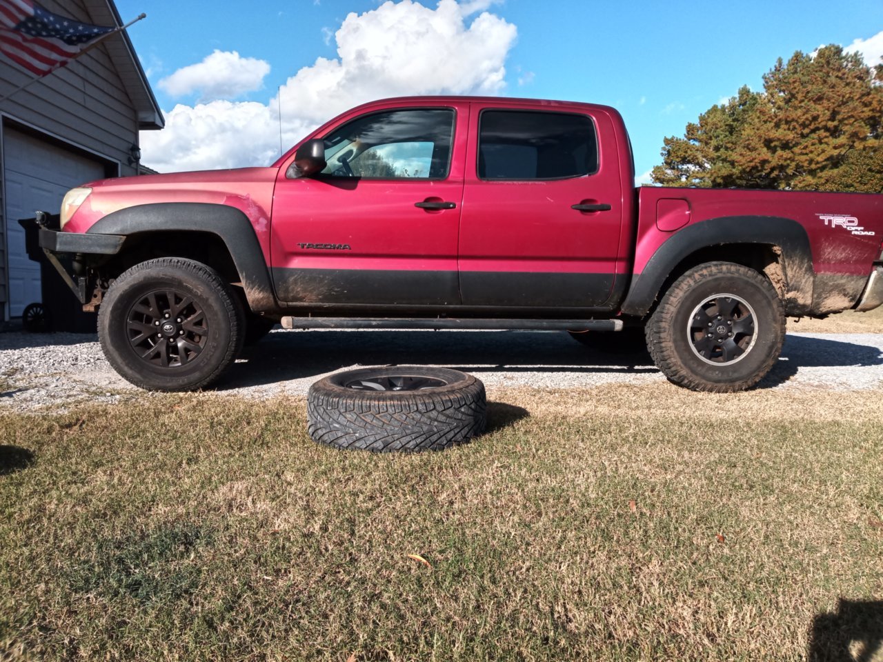

    Put the 33's (back tires in pic) back on for hunting season

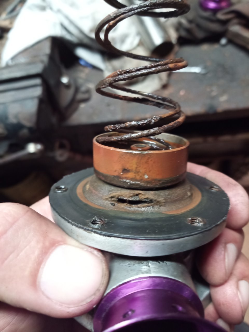

    My blow off valve had a nasty hole in it so I've been driving around with a vacuum leak for who knows how long... Anyway, bov is out and a pipe is in so flutter away and so on and so forth and what have you

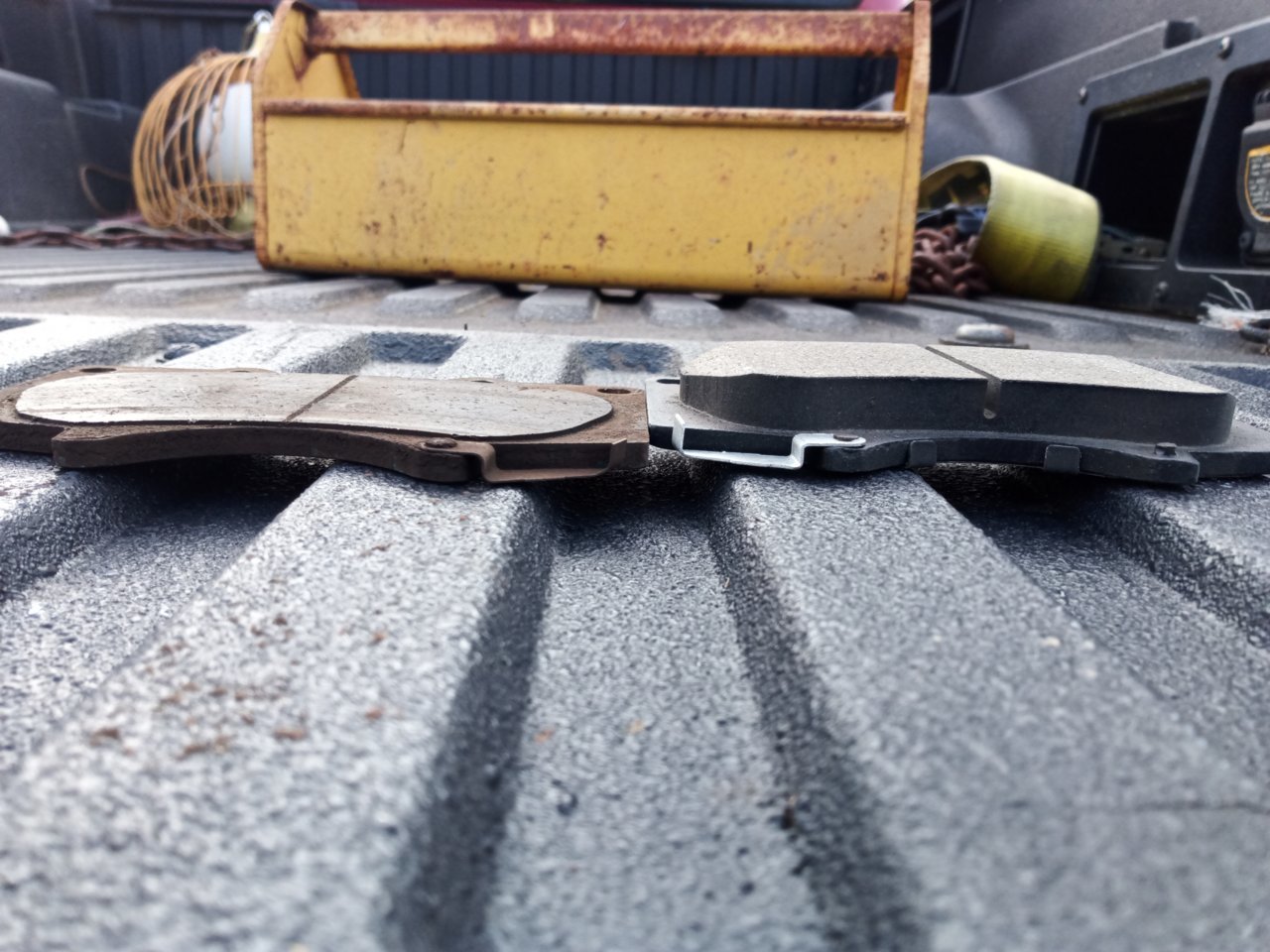

    The wife's t4r needed some brake pads... Like 2 months ago lol, got just about all we could out of the factory set

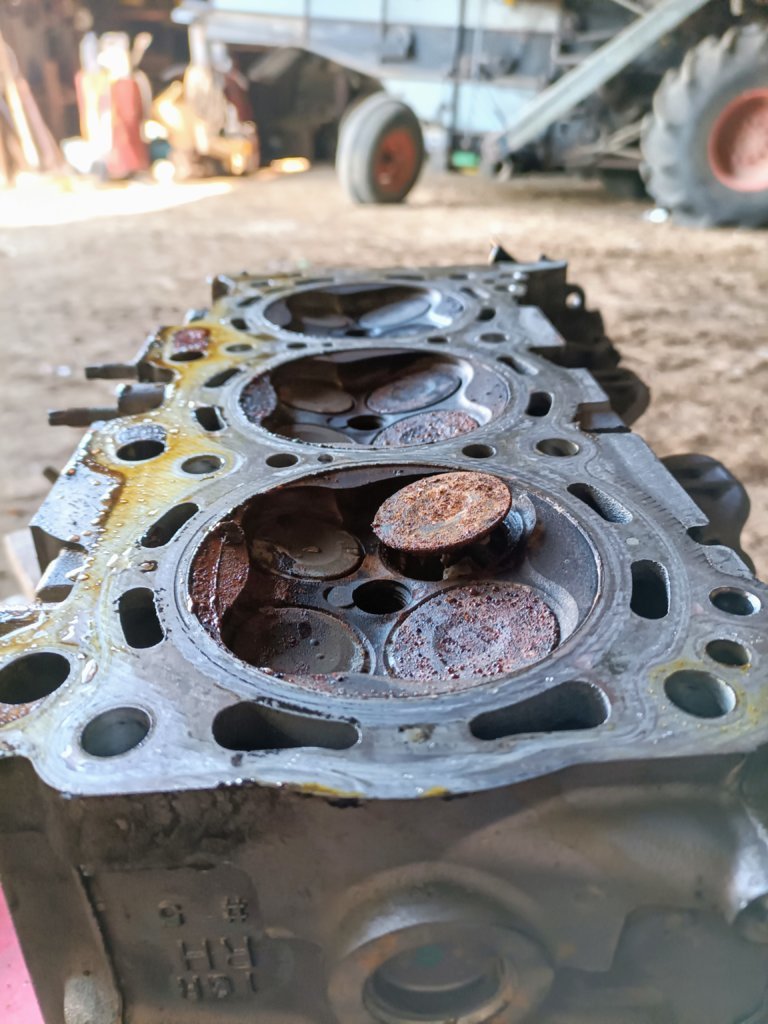

    Well, I found a crack on piston #6 while I was attempting to get the timing chain back on and wondering why the engine wouldn't turn over by hand... I assume that rod is bent a little and it allowed the counter weight to contact the bottom of the piston, because there is a nice clean mark on the bottom of the piston right about where contact would happen. I did loosen up the rod caps and was able to spin the engine afterwards... Long story short, does anyone wanna buy a turbo 05 Tacoma that happens to have engine issues... It comes with 2 sets of wheels and a couple cardboard boxes full of parts... Kind of kidding but if someone handed me $6k and showed up with a trailer, I'd help em load it up
