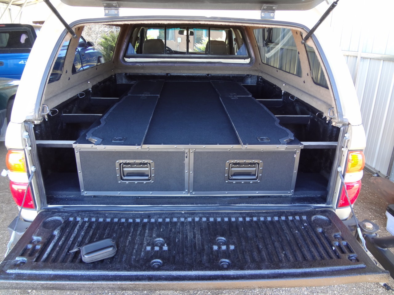

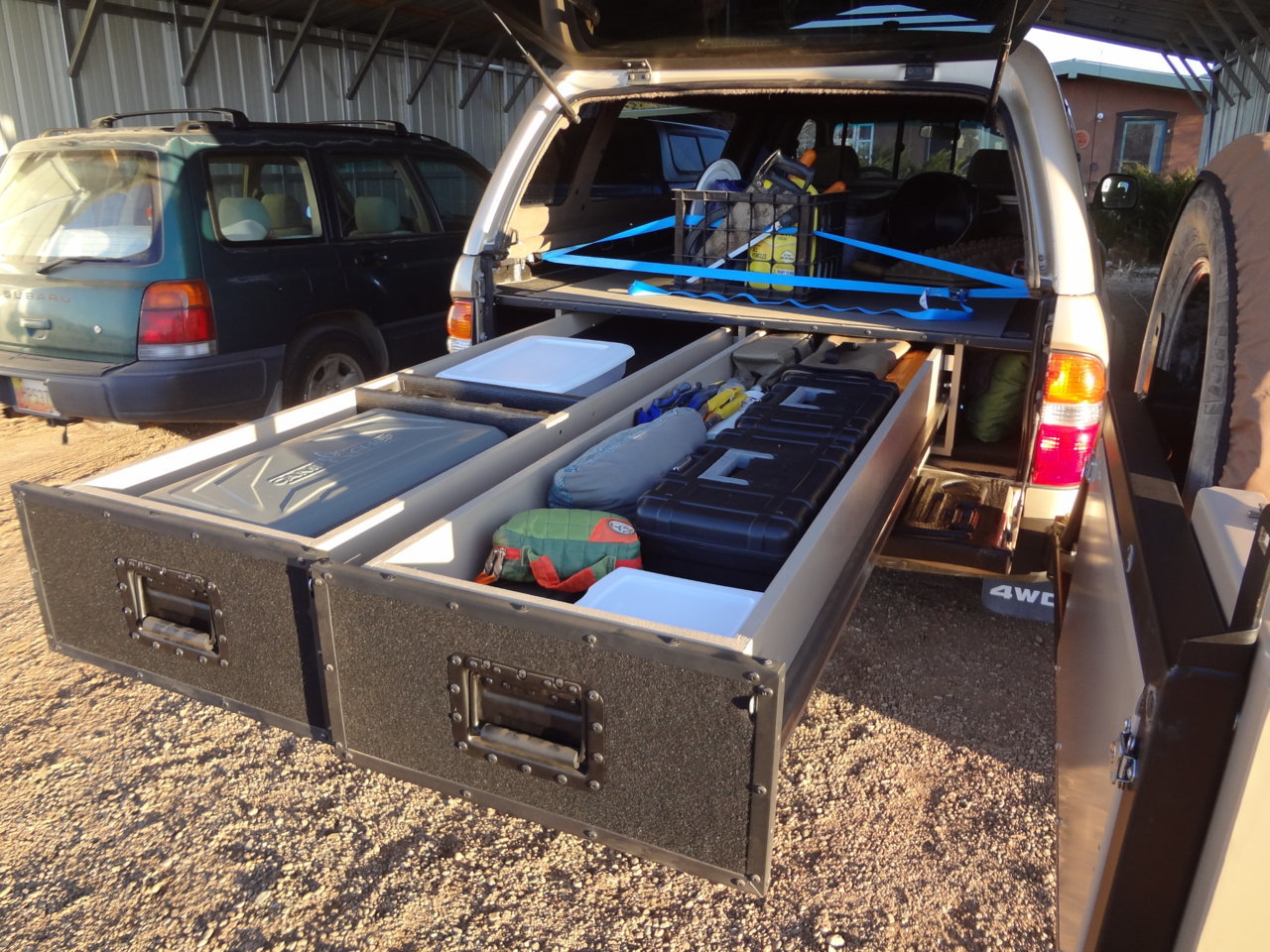

    I've built some heavy 3/4" drawers/sleeper in the back and have quite a bit of gear stored back there for prospecting here in NM. I need to accommodate this added weight and would like some added clearance.

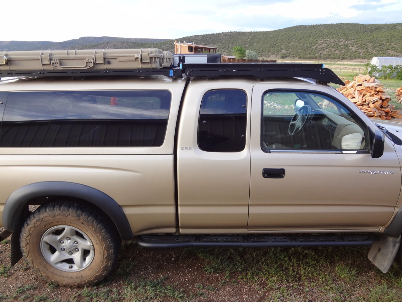

    I've put OME kits on two Gen 1 Tacomas now. One I sold with 8+ years on the suspension kit and it was doing just fine. My XJ Cherokee probably had 15+ years on its OME kit. I give Old Man Emu my highest marks.
    I've had OME on several vehicles now, and most of the time the ride quality is improved even as a modest (typically 2") lift is achieved. The only exception so far is my Gen 2, where I went with "heavy load" springs in the rear and it's really too stiff if there's not aa good load or my RTT in the back.
    The truck is on BFG AT 235/85-16 tires in this image. I like that size on my Tacomas...

    Beautiful truck!

    I'm now noticing your pic. looks like you're in my home state here in NM, possibly CO maybe UT. Sure does look like NM though. Nice pic.

    Holy crap. That is an amazing drawer system. I would totally steal your design as it is exactly what I'm trying to do. I'm curious what drawer runners you used?
    Sorry/not sorry for derailing your thread.

    Hey thx. Check out 'paskmakes' on youtube. I based mine on his build. Lots of pausing in certain places, and of course modified it some. I used 1" inch steel tubing. Aluminum is light, but I was afraid it would get cut into some being softer metal.
