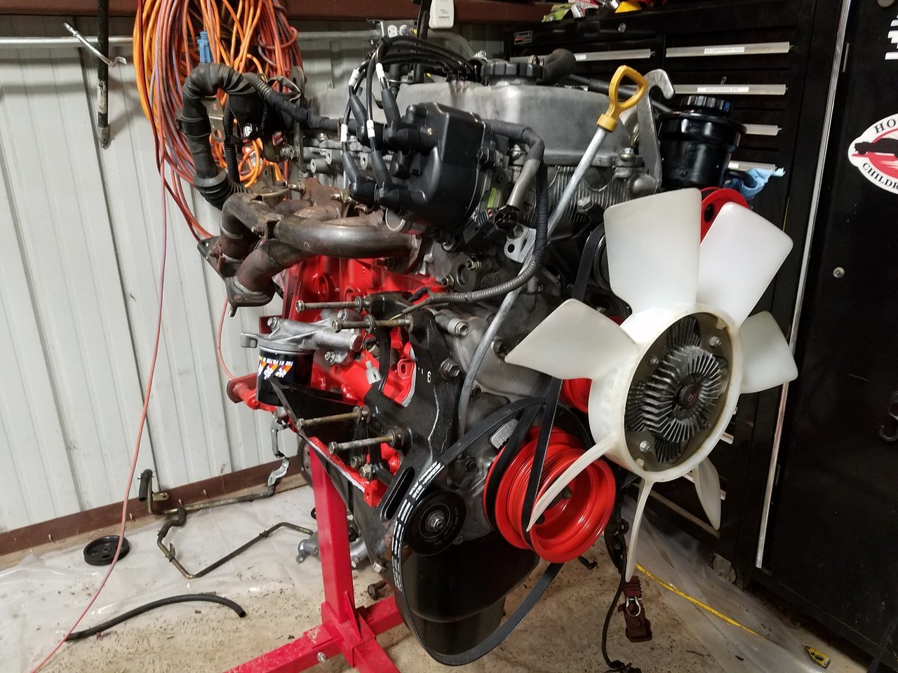

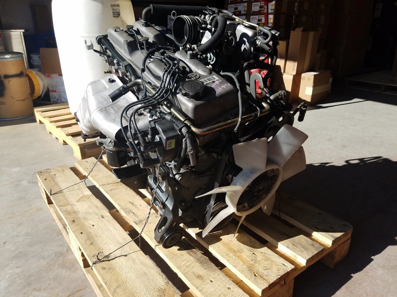

    I got a JDM engine with under 50K miles according to the seller. It had perfect compression across. Free shipping to my business as I have a forklift and it was 1500 bucks on ebay. Runs perfect 20K miles on it now no issues. Granted, when I put it in I replaced all the gaskets, timing components, and injectors. I had to transfer all of my old stuff like Intake, TB, exhaust mani, EGR (later deleted as it came without one), and wire harness and it was perfect. I mean the head and block are identical so i don't see it being an issue if you transfer all of your stuff onto it. I am doing a full overhaul and turbo build on my original motor.
    When arrived. It was fully wrapped in plastic.
    Before install.
    #41

    Just like stock. No issues at all. Only reason I swapped is because at 300K miles I just decided to rebuild my original motor for a turbo build. Literally no reason for me to take it out. my 300K motor was still ok
