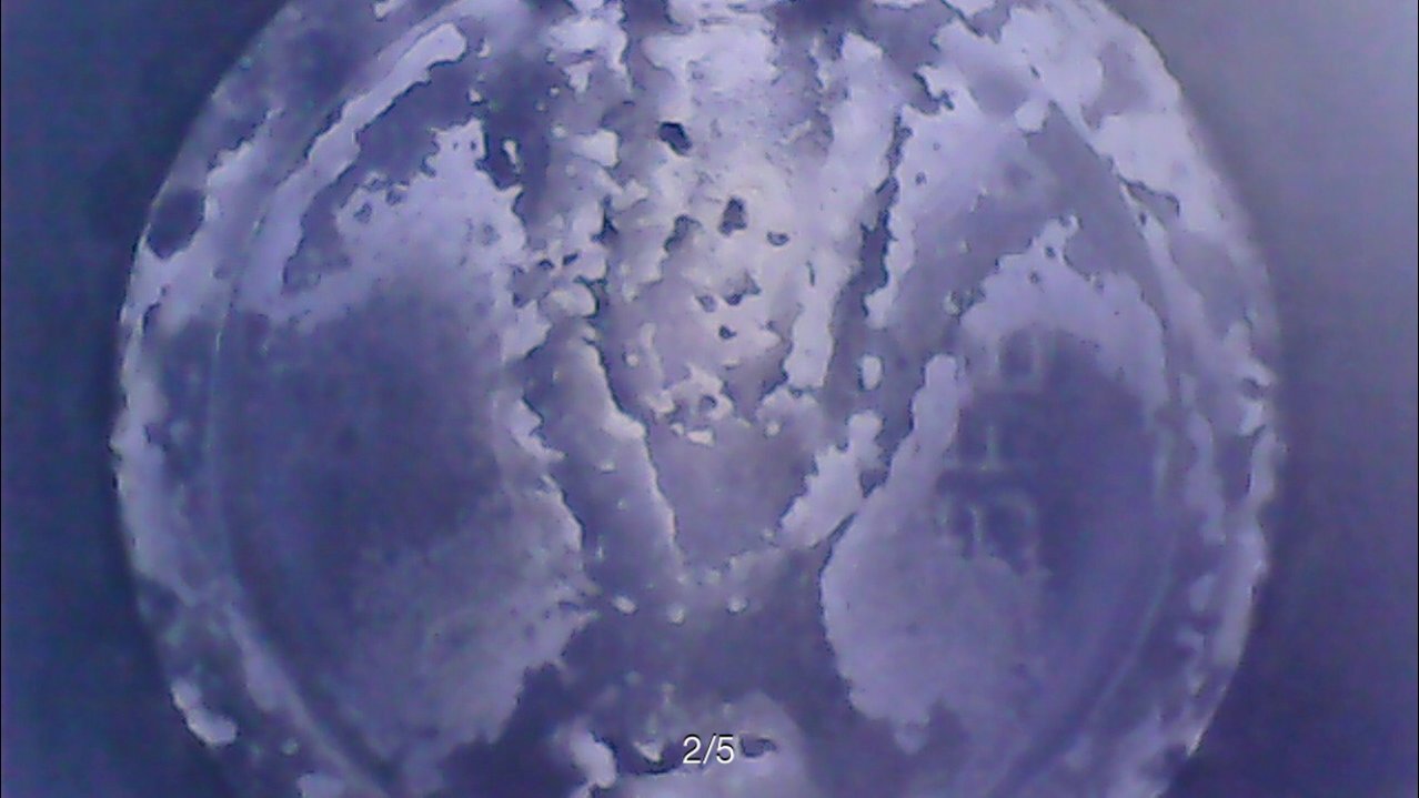

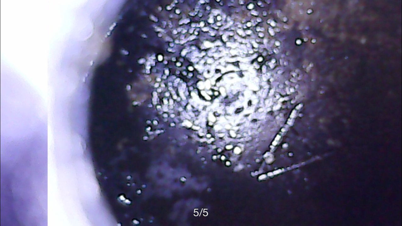

    So the back story is that I bought the truck back in 2011 and it always was low on power and I found low compression on 2 cylinders and pulled the head to find 2 burnt exhaust valves. So I had the head rebuilt and decked and valves adjusted. Reinstalled and it ran better but still low on power. After the head rebuild it developed blow by real bad and spits oil out of the filler cap when running. Compression test confirmed low on 3 cylinders. I decided to just drive it since I had no more time and money to invest in the bottom end.
    Fastforeward to late last year
    Started having a rough idle for about 10-20 seconds after start up after sitting for a few hours. Wouldn't happen if it was within an hour or two. I suspected a leaking fuel injector. I than noticed it was consuming coolant. So I started suspecting head gasket. Outside of the engine from the seam of the head down was wet with something stained the block. Did a block test and it barely changed from blue to a green not really even yellow at all. No oil in the coolant no coolant in the oil. Not burning oil at all I than did a compression test and got low on 1&2 and slightly higher on 3 and like 190psi on 4.
    Ok so that's odd right? Spark plugs looked ok but #4 was kinda black
    Well I borascoped the cylinders and found all cylinders to be pretty clean as if they were fuel washed or steam cleaned.
    But cylinder 4 was coated in black sludge and wet inside.
    So in the end it was consuming about 1.5 letters of water every 60 miles of driving and idling like a nova with a big cam.
    It even hydrolocked on me one day so I finally parked it.
    So I suspect a bad head gasket or more than likely a cracked head. But the bottom end is requiring a fresh set of rings and I'm just all together tired of this engine and want a fresh start.
    I do have plans to test the fuel system and send out my injectors for cleaning. I'm going to go over everything. I want a bitchin motor that runs good. I'm tired of having no power. I know it's a 2.7 but Iv owned 2 other 2.7 tacomas and I know this engine has never been 100%
    Heres cylinder 4IMG_2075.jpgheres what the other 3 look like IMG_2077.jpghere's the plug from cylinder 4IMG_2073.jpg
