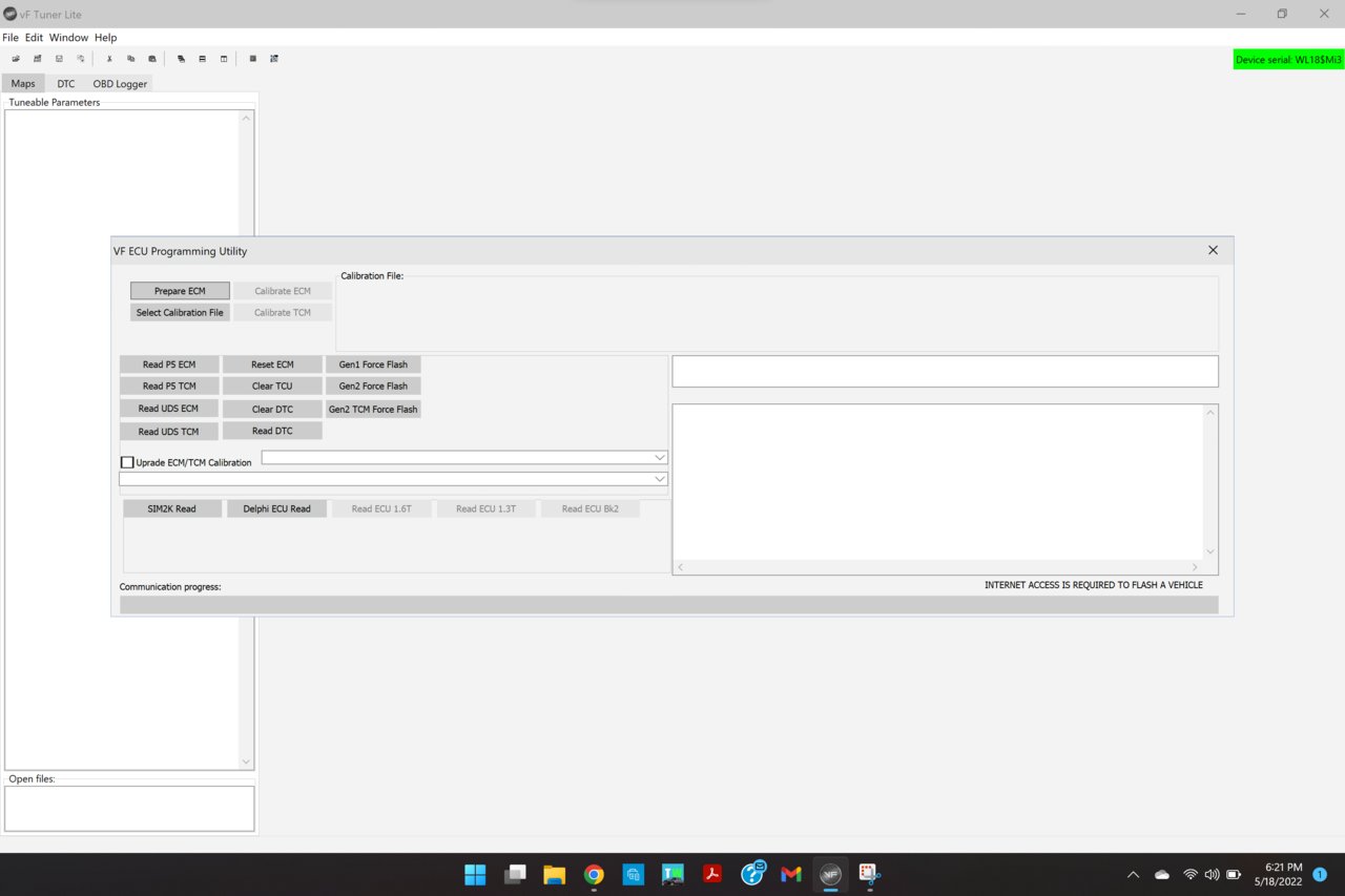

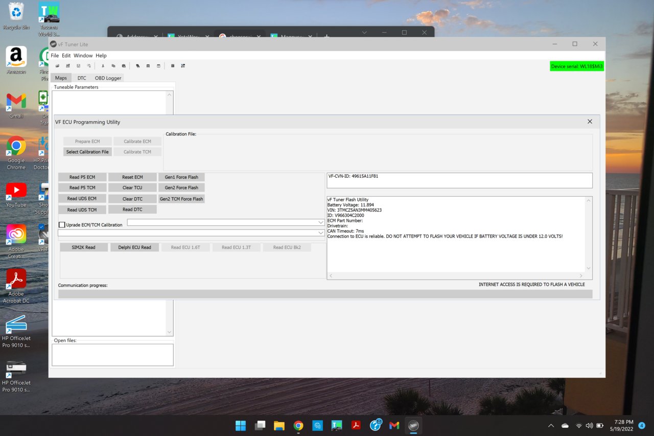

    Hey folks,
    This is what I get when I click the "flash ECU" icon, and my icons look different form those in the instructions, no pop up comes up with a "prepare ECU" button 1st screenshot. The second screenshot is what I get when I click the "prepare ECM" button.
    Can someone tell me what I'm doing wrong, I'm at page 20 and 21 in the instruction manual.....

    You're doing everything right.
    Select the Flash ECU button, the "VF ECU Programming Utility" window will pop up.
    Select [Prepare ECM] and wait for the log window to say "Connection to ECU is reliable..."
    Select [Select Calibration File] and browse to the file you wish to flash.
    Select [Calibrate ECM] and the flash process will begin.
    PapaRee likes this.

    Is that my ECU in the pop up window, it seems to not make sense V966304C2000?

    Yes, that's your ECU ID/Calibration ID.
    You're running an EROM version of 04C20. The "V" indicates it's a vF Tuner EROM file. Stock is typically an "8".

    yes. The shorthand of this is 04C20
    In order to flash the YotaWerx tune, you will need to flash to the stock tune for 04C20, then use Techstream to update to 04C21, and then flash either the Magnuson tune for 04C21, or the YW tune for 04C21.

    I was getting a battery alert just while doing that, will it help I I put a battery charger on the battery while I do this?

    You always get a battery alert on the dash while flashing

    It'll help yes. Your voltage there was 11.8, a bit low
