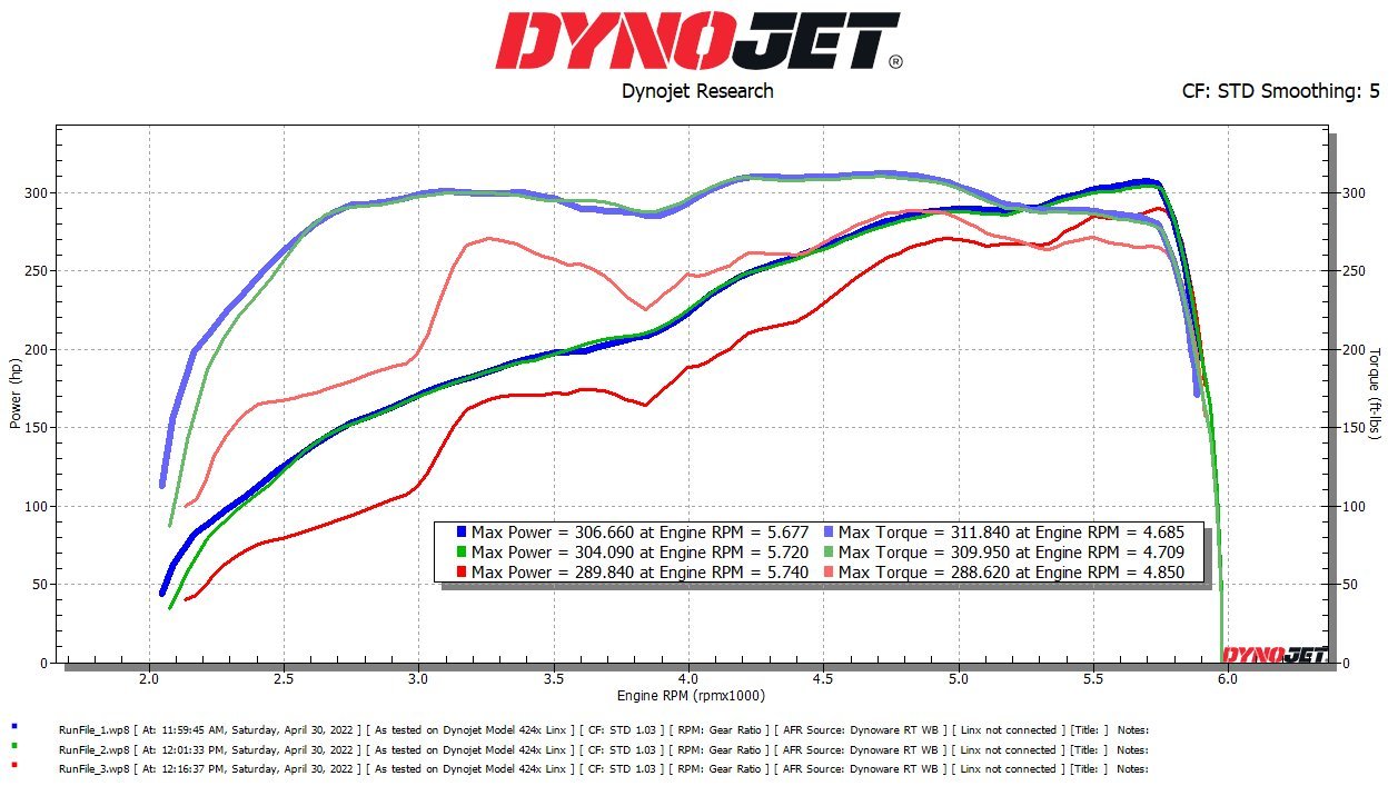

    I know what you mean and I think there are two things that contribute to this. First is the throttle response and ATRA. Marc has been working with the testers to try and dial it in so the truck isn’t twitchy. You should have felt the original ATRA settings lol… It’s been softened quite a bit from that point and a lot of us feel that the partial throttle response is great right where it is. Coming from the Magnuson tune it will feel like a night and day difference.
    Second is how the power is delivered. If you check out the dyno posted earlier by @SK808 you will see that you have maximum torque immediately down low. So you combine that with the throttle sensitivity and yeah it feels like giving it more gas doesn’t necessarily result in a ton more power. Partial throttle feels like my Jeep SRT Hemi with 475 HP but obviously full throttle doesn’t give me 475 HP if that makes sense.
    Are you on the 87mm? That’s a hoot to drive on the Yotawerx tune.

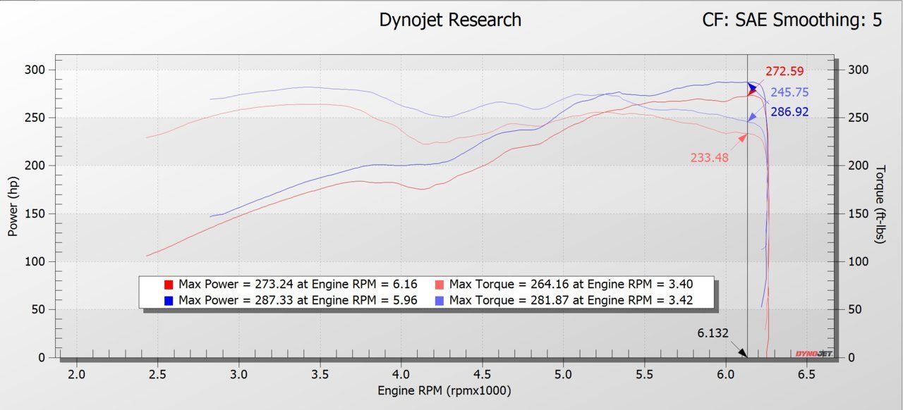

    It’s a very noticeable difference. Roughly 15 WTQ/WHP. I would guess the exact same dyno posted earlier will be around 320 WHP with the 87mm. Attached below is a dyno difference shown with the 90mm vs 87mm pulleys in the very early stages of Yotawerx tune development. The tune has come a long way since then.
