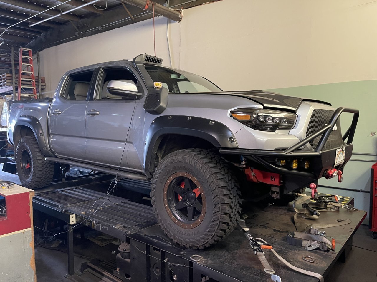

    Tyler
    Eastern WA
    '24 SR6-MT DCSB
  20. May 31, 2022 at 11:20 AM
    #440
    Shellshock
    Nov 21, 2015
    #170338
    23,394
    Iowa
    thats what happens when you join this forum. its a very expensive free membership
