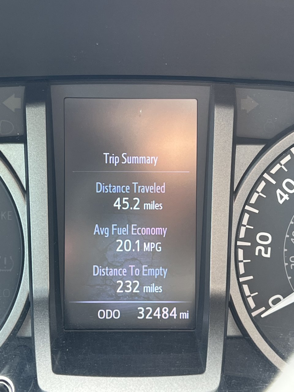

    Did I just get lucky or have any you FI folks also noticed better mileage on the YWT?
    I had been running ECT - ON everywhere with the Maggy tune. Consistently this yielded 17-18 MPG. ECT - OFF wasn’t really any better. I haven't seen 20 MPG after adding the SC.
    Since going to the YW FI tune (YW_04B82_Stryker_MagSC_90mmPulley_33_AGM+GL) I’ve been getting numbers like this consistently:
    This particular trip was mostly 60-70mph on the interstate. I know these numbers can get skewed a bit but when I do the math at the pump, it seems to back it up. Three fill-ups so far and it’s at 19-20 MPG each time.
    Configured fairly light (~300lbs of mods) on 4.88s gears turning 265s.

    I think @GoldenBrew has you beat actually lol up in the Colorado mountains no less, although his only mods are the blower and 4.88's.

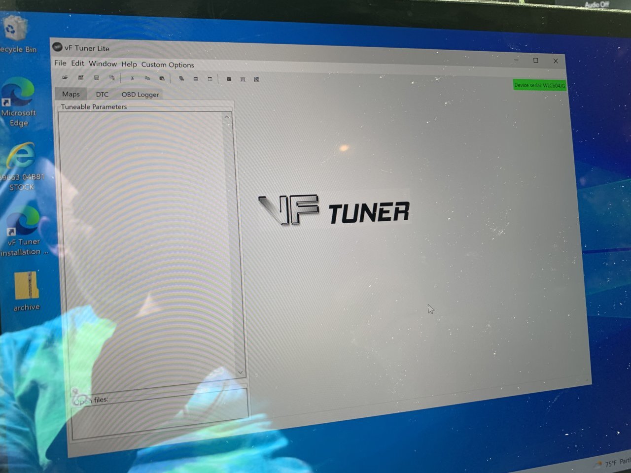

    64FD18D7-B786-4C84-B283-13412874E226.jpg This is what I see when I start up VF tuner. There’s no “prepare ECM” button or anything.

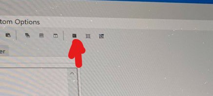

    You have to hit the little black button at the top. If you hover over it, it says flash tool or something like that

    Click this button:

    I think I did it without screwing anything up. Gonna go for a drive a report back.
