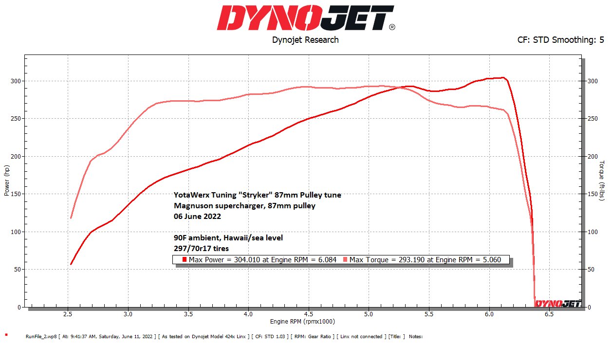

    Hey all,
    Been out of it and not too active the past few days while I recover from covid.
    I wanted to post an update though WRT the 87mm pulley Stryker tune:
    On Saturday, @SK808 ran the 87mm test tune on the dyno and the dynograph is posted below. Since Magnuson doesn't provide a separate tune for the smaller pulley and due to time constraints preventing pulley swaps while strapped down, just the YW tune was run on the dyno.
    Ambient temp was 90F, which is obviously not friendly for boost. His truck has 33" tires for those who are curious as well. Between that and pushing the limits of the stock fuel system, I'd say it's not surprising that the smaller pulley tune made *only * these numbers. Particularly after we pushed the fueling as far as we did with the 90mm pulley tune.
    I am sure though that the numbers would be more favorable in cooler temps, as would be expected.
    A key takeaway from this dynograph is a demonstration of consistent smooth power delivery between this tune and the 90mm pulley tune (see 90mm pulley dynograph for reference). The smaller pulley also yields higher levels of boost quicker, and sooner in the rpm band.
    Prior to release there's a couple things I'd like to iron out on the 87mm pulley tune but it'll get released soon.

    Great stuff.
    Congrats!
    :cheers:

    What was the max boost seen on that run? Just curious.

    looks like only 7.4psi
